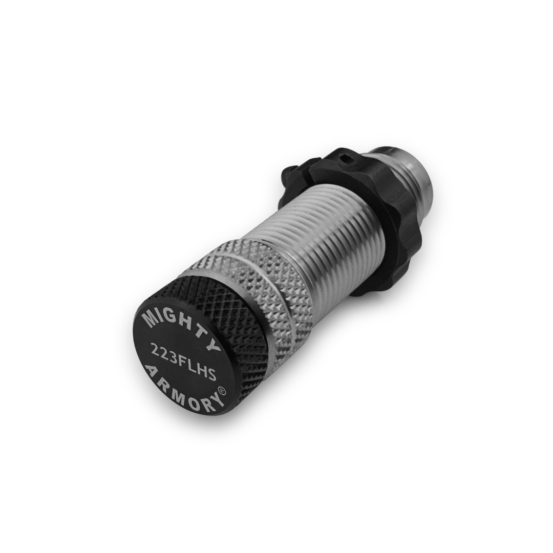

If you want to upgrade your die by all means there are some great options out there. I use Forster but I also recently bought a Mighty Armory die for another caliber. On the Mighty Armory website the .223 die is currently in stock. It's not cheap but it seems to be a quality product and should produce better results all other things being considered. The expander for those is more of a mandrel. They look a lot more beefy to me so that's a good thing.
