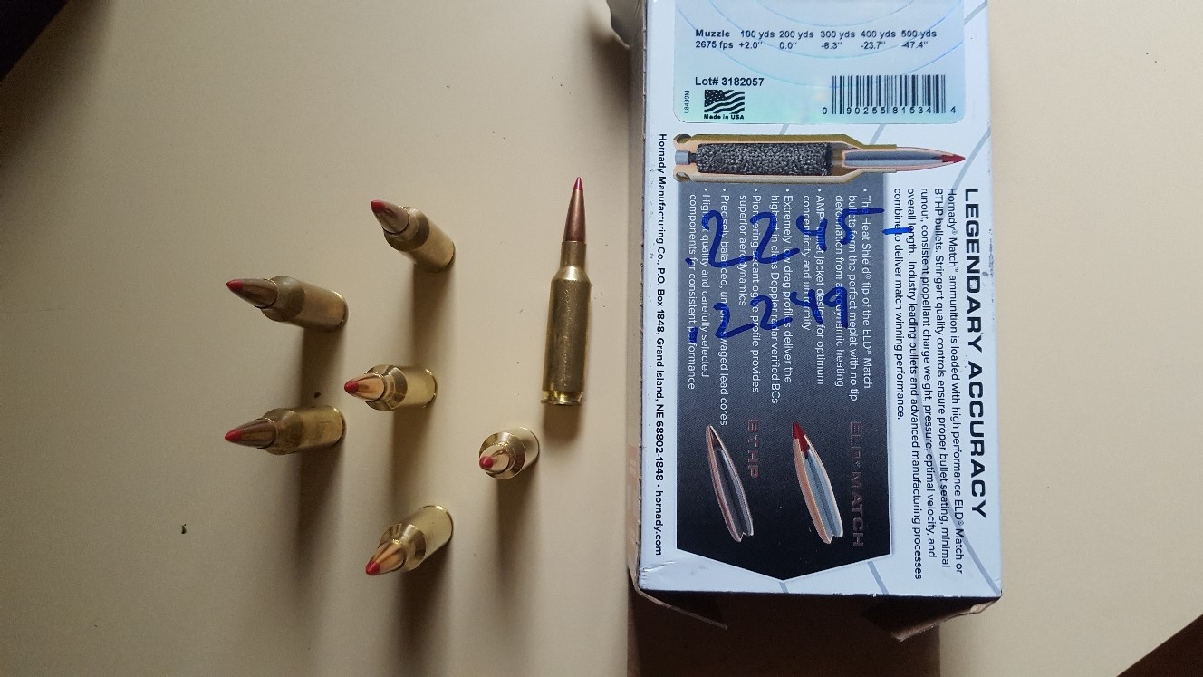

How long are the factory loads OAL? I've been loading mine to 2.300 with good results. Curious about the factory length. Can you post some pics of bullet/mouth junction?
I measured ten and came up with 2.249" for OAL. Chronographed five with an average of 2654, SD of 10.7 out of a 22" Bartlein by Craddock.
Is there a gap between the case mouth and bullet ogive? I'm really surprised they are seated so deeply. I dont think I was able to seat then that far in without seating past ogive.
Well, I shot 40 rounds this am. Conditions were good and I had high expectations ,but I could only get it to group in the 3/4 to 1" range, nearly identical groups as the federal 75 TMJs. The point of impact was 3MOA low and 1 MOA right,compared to my federal 90s. It clocked 2714 out of my rifle. Some of the groups ended up with 3-4 shots in 1/2" range but over all it didn't shoot as good as the federal gold metal. I fired a test group of the 90s just to check and went into 1/2". Maybe I just got a bum lot#.
oal range is written on the box. should note this is i think the first ammo i've seen that is faster in my gun (24") than what's on the box!
