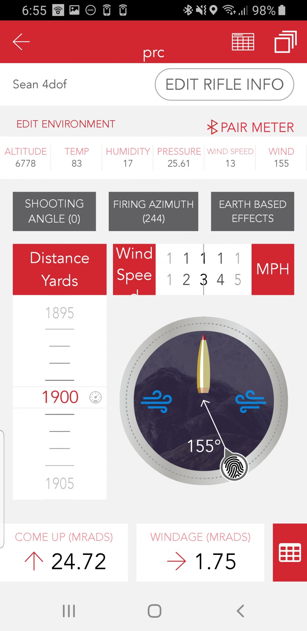

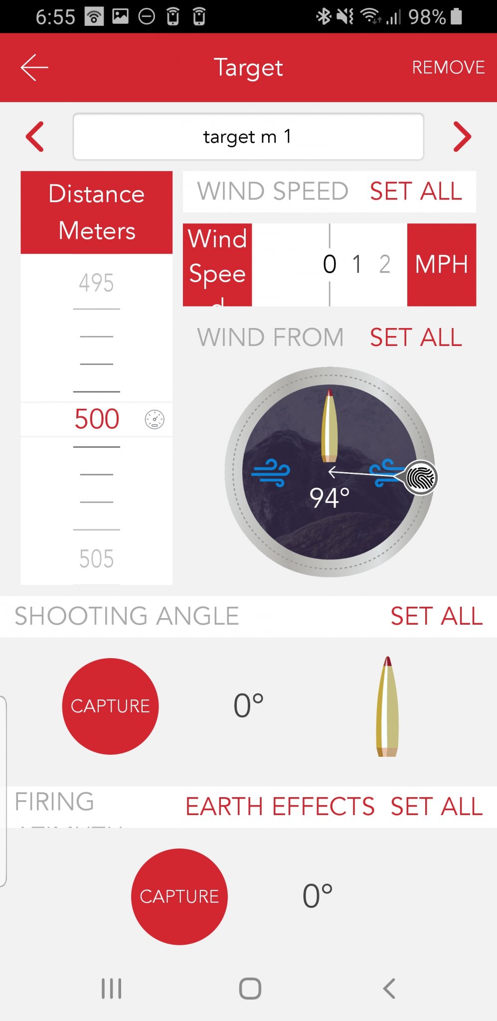

    You have to go out to the main menu and edit the rifle favorites, and set the output distance units, I verified this on android. You may need to re-create the range card I am not sure if it is dynamic.
    seansmd, the distance units are all set to Metric and display correctly on all other screens. The range card says yards, but the solution matches the metric distance. In other words, if I enter 550 meters with 5kph wind from 9 o’clock, the main screen solution and the range card solution for elevation and windage are identical. It appears the 550 meter solution is consistent and the software programmer just forgot to make the change so that Meters instead of Yards is displayed on the range card when Metric output is selected. Calculations are performed correctly for the meter distance but the wrong units (yards) are displayed in the iOS version.
    Works on Android, sorry. I'll let pics later.

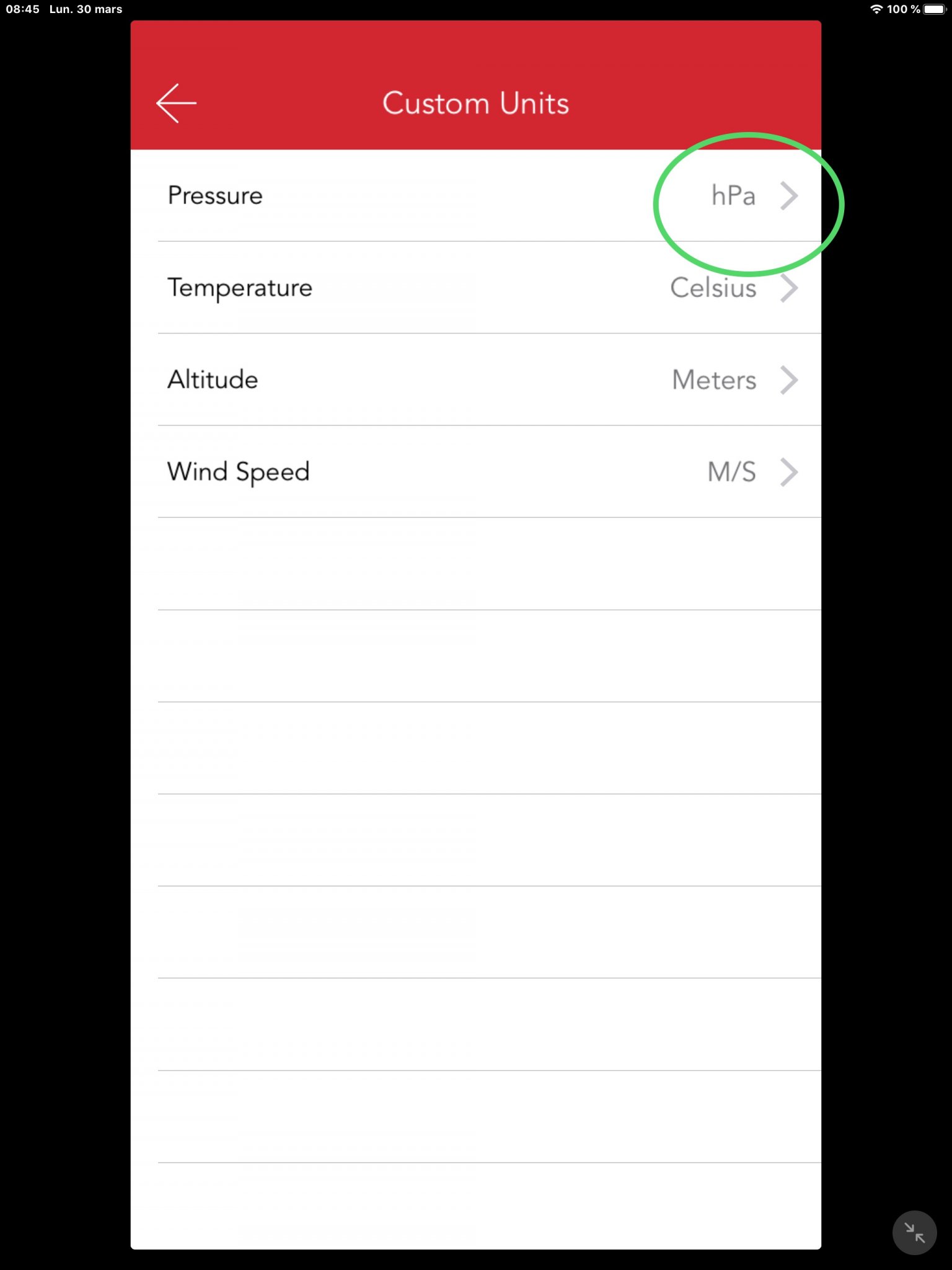

    I also have a issu in metric with pressure. I use HPA and it is giving me information in MBAR
    An hPa is the same pressure wise as a mbar, just expressed in different units.
    1 hPA = 1 mbar
    In other words, a pressure of 990 mbar can also be expressed as 990 hPa.

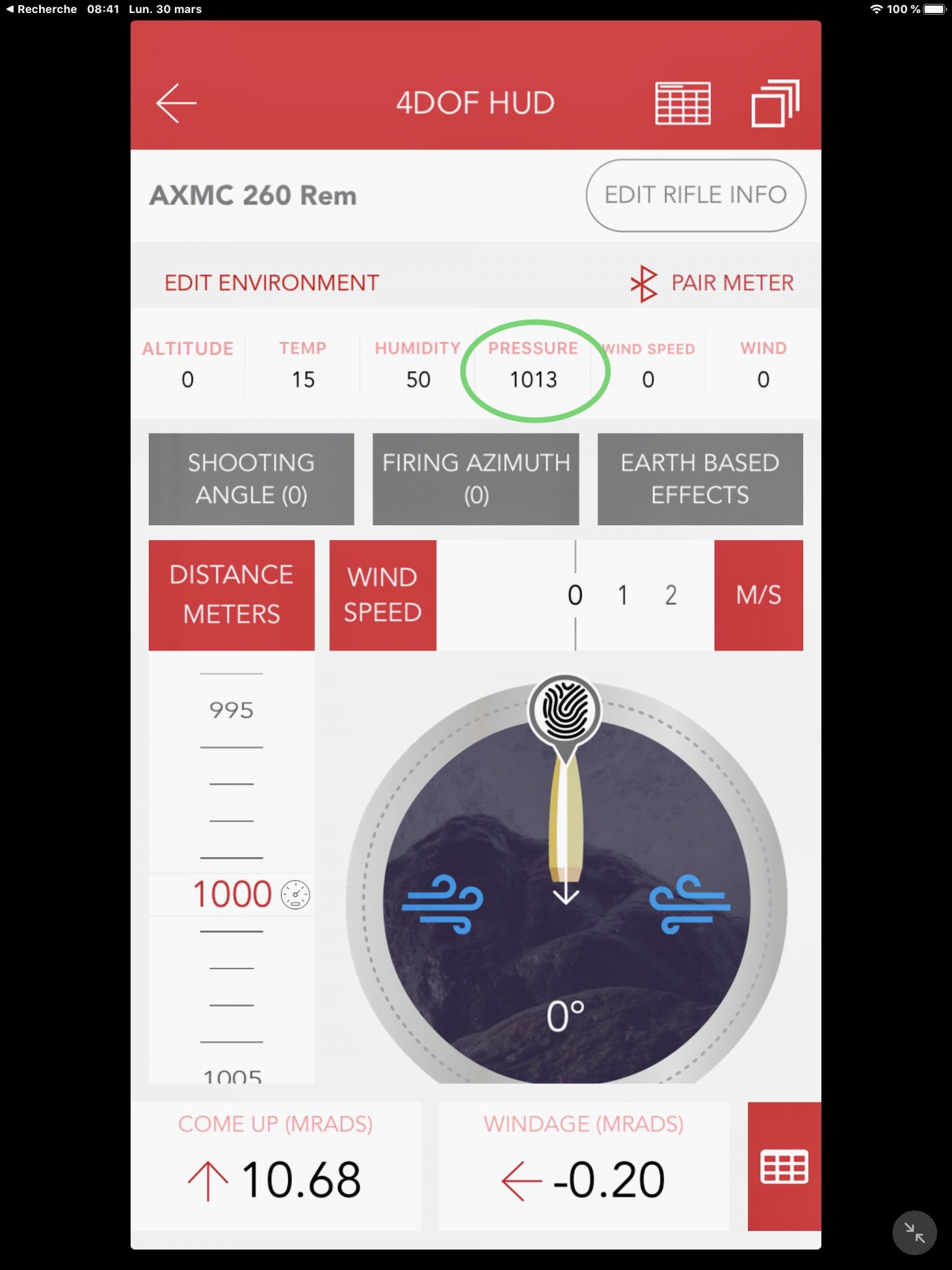

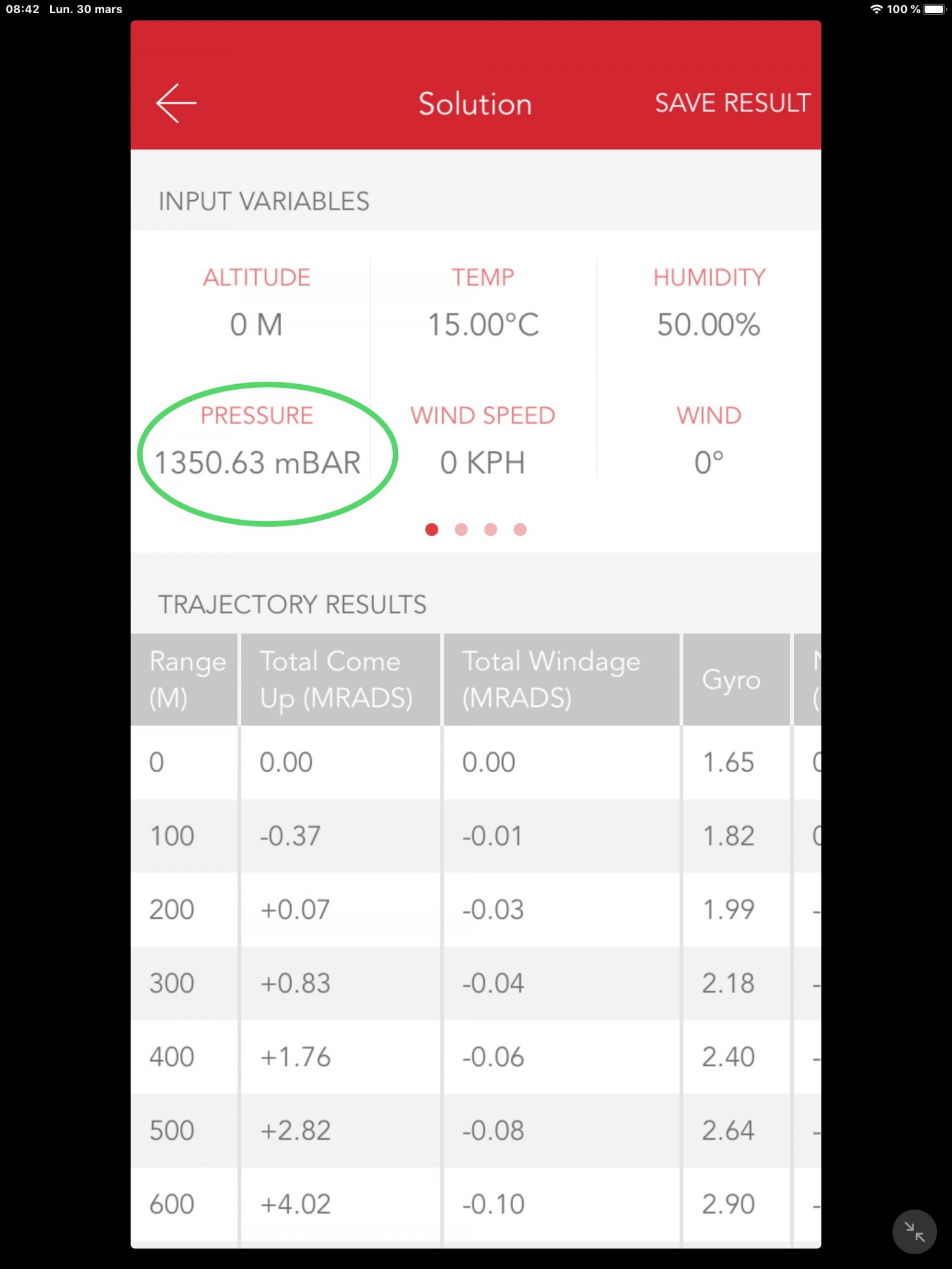

    What is weird is that When I set the altitude at 0 meters I should have a pressure of 1013 mbar. Instead I get 1351.05 mbar in the max range table
