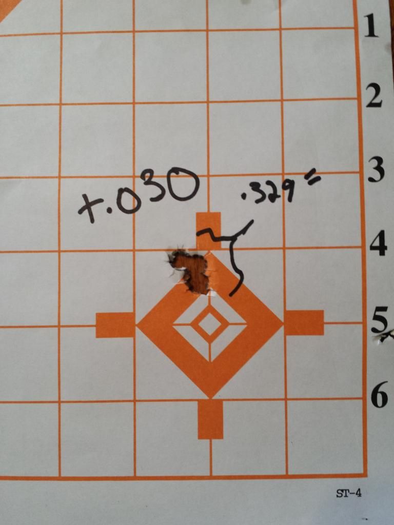

I just finished load development with the 208 amax and H1000 yesterday. After a lot of shooting, I settled on 76.5 grains H1000 out of Norma brass averaging about 2830 fps. After that, I did a seating depth test of 5 shots each starting with .010 off, .015, .020, .025, .030. I already had read that a lot of people like .020 off with the 208, but my rifle showed the best results .030 jump. One thing to think about with the 300 win mag is barrel life with some of these barrel burner loads. Here's mine (there's 5 in there promise):

that seems to be a common node, 76.0 is about right for me. Running that bullet anywhere over 2750 gets you to 2k, running a moderate load makes sense
I'd take that and call it a day. No need in improving something that is shooting great!! What's your bbl length ??
