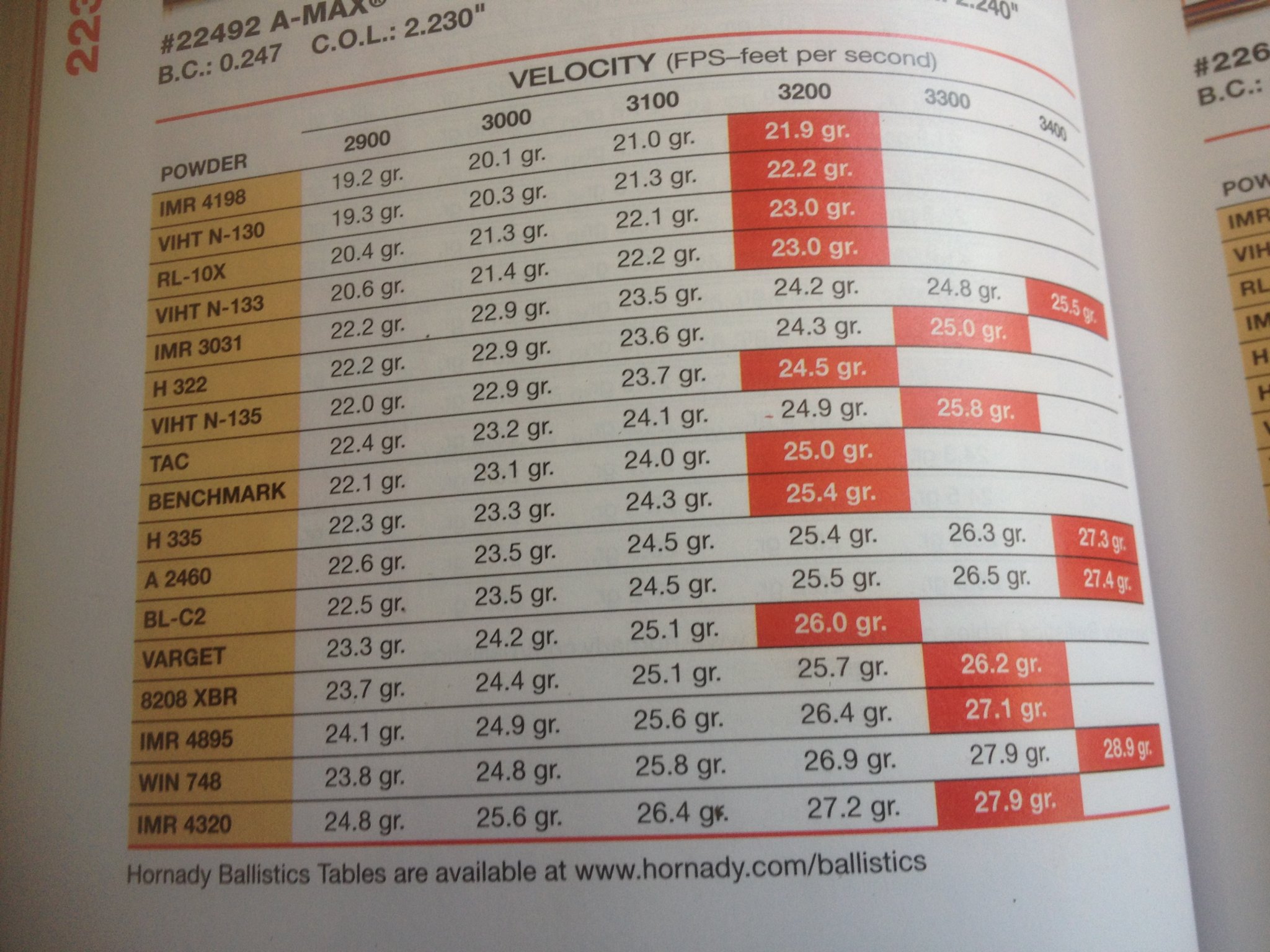

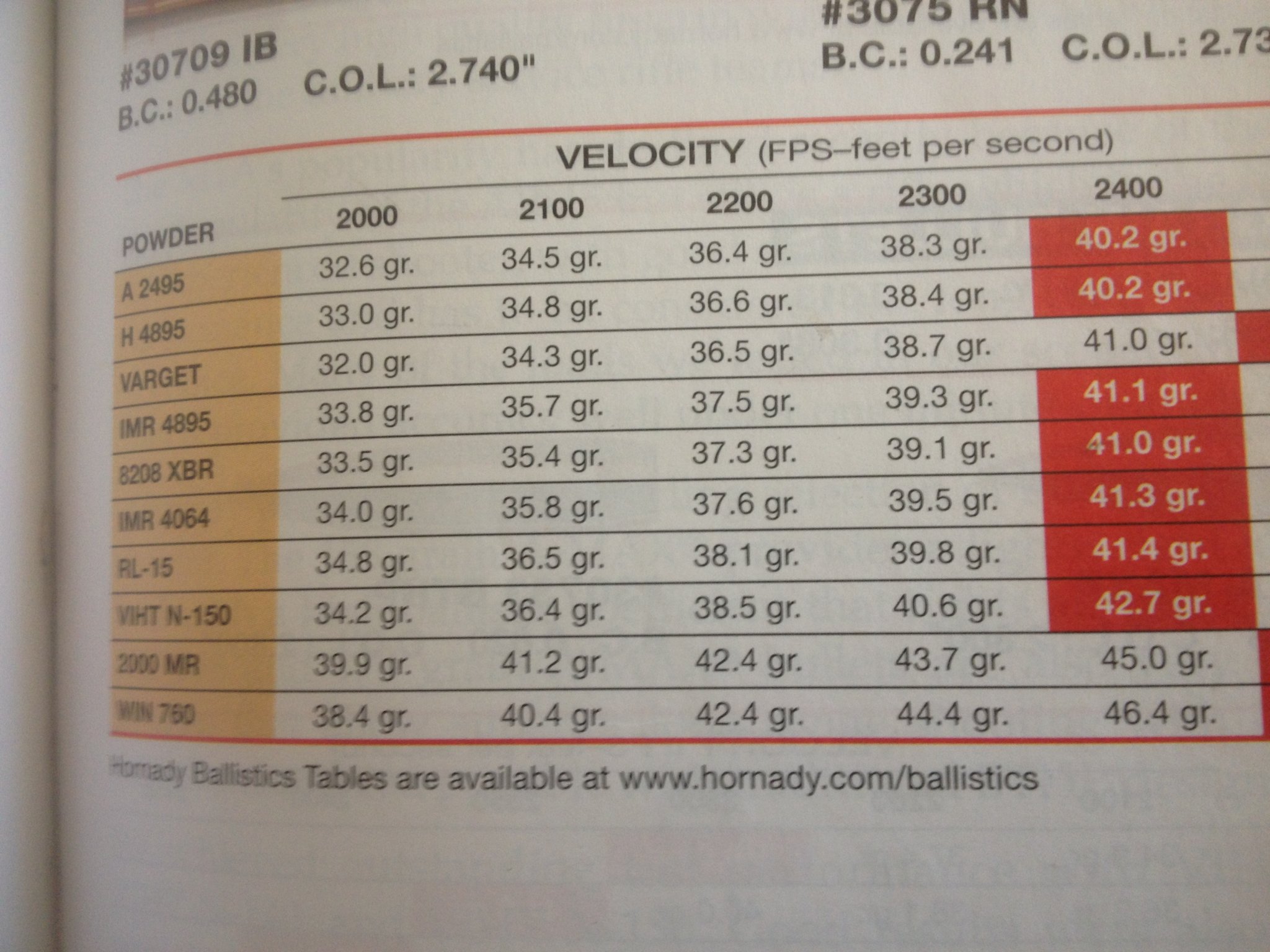

The Hornady book has all the 178 and 180s listed with same powder charges. If there is something specific off the page in the Hornady manuel you want I can get it real quick.
Reactions: Edsel
Only if you have free time...
...wouldn't want to impose.
Would you mind posting some information from the .223 Remington pages, too?
22 Caliber (0.224") 53gr Hollow Point 2250
22 Caliber (0.224") 55gr FMJ with Cannelure 2267
22 Caliber (.224") 62gr FMJ with Cannelure 22760
30 Caliber (0.308") 155gr Hollow Point Boat Tail 3039
30 Caliber (0.308") 178gr Hollow Point Boat Tail 30715
Thanks!
Roughly - done screenshots with the max / min loads of their recommended powders would be fine.
First is .308 178-180g
Second is 223 52-53g
