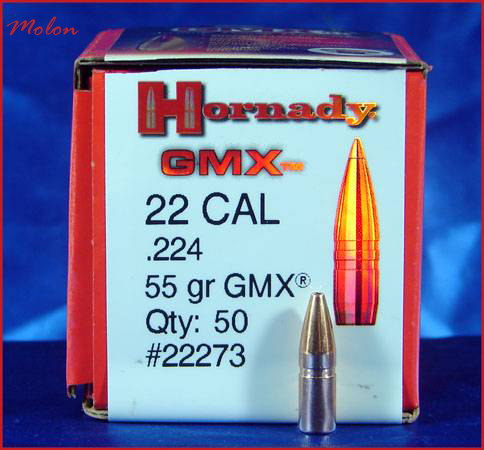

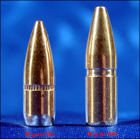

The Hornady 55 grain GMX .224" projectile is a monolithic gilding-metal hollow point. It does not have a polymer tip. It's significantly longer than a typical lead-core/jacketed FMJ bullet. The bullet is a blind to barriers projectile, though accuracy/precision is not on par with say, the Speer Gold Dot projectiles in this caliber. The relief band also serves as a cannelure.

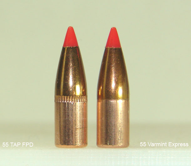

The Hornady 55 grain V-MAX does have a polymer tip. It's a varmint bullet; it has inadequate terminal ballistic properties for a self-defense load. It does however produce good accuracy/precision for target shooting. This projectile is available with and without a cannelure.

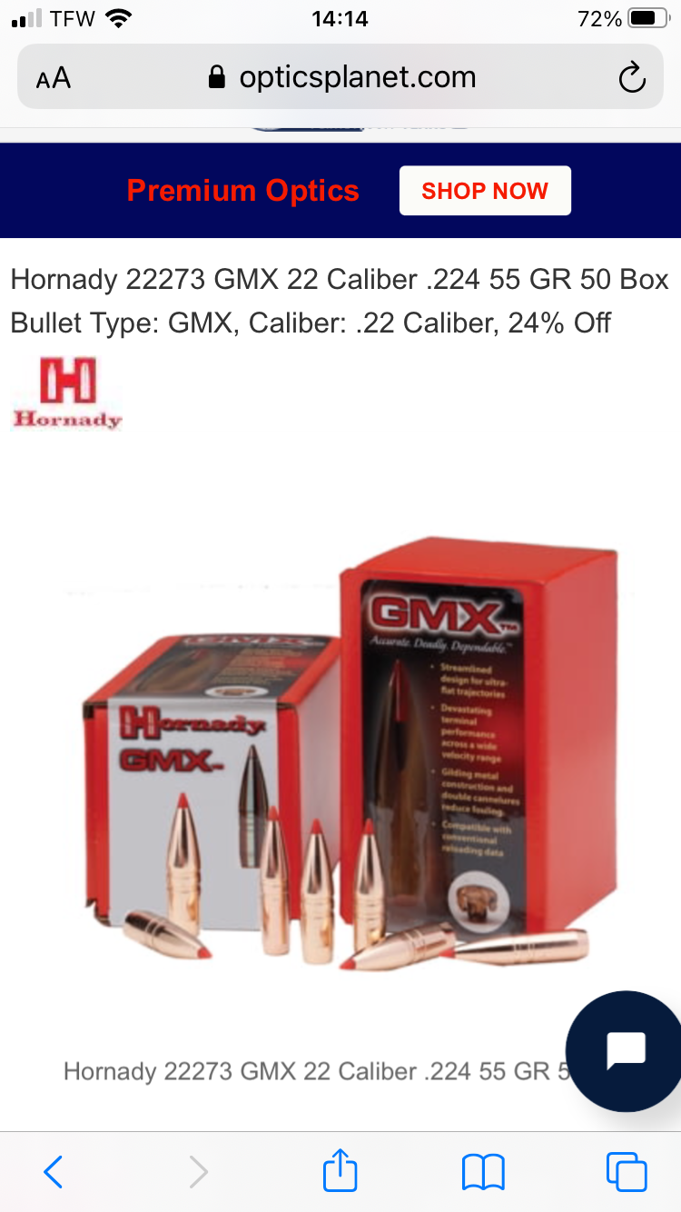

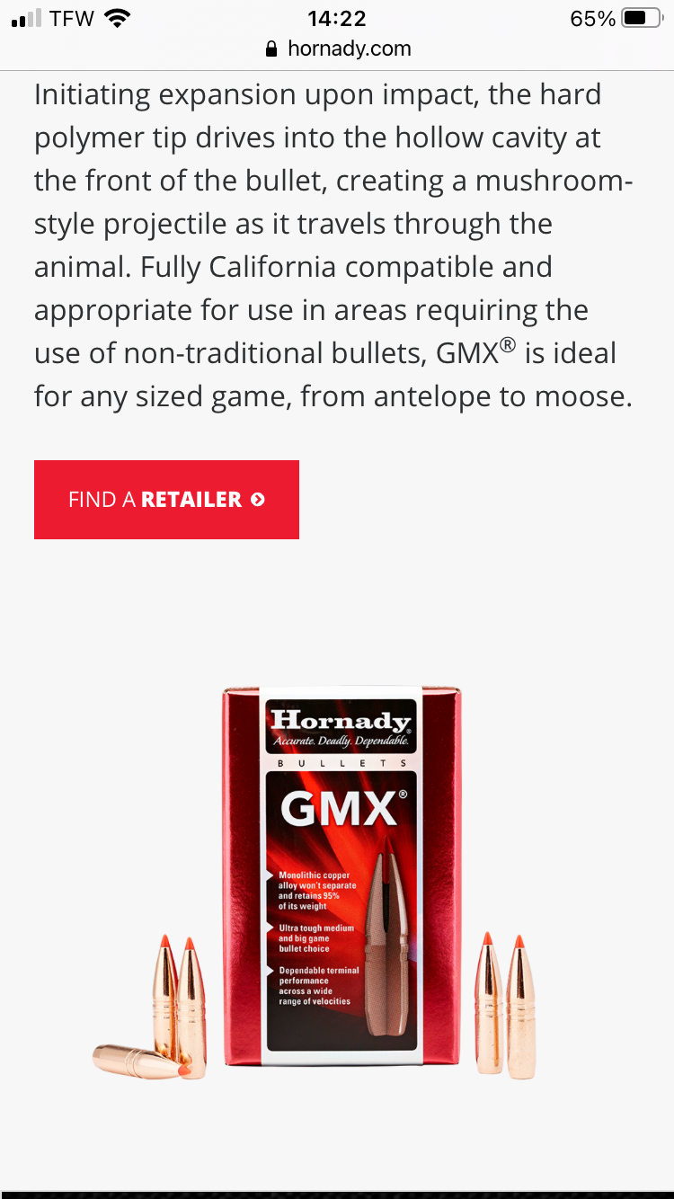

I appreciate the feedback Molon, but from what I’ve seen it appears that they do make it with a polymer tip. At least that’s what Hornady advertises and OpticsPlanet (which is where I ordered them from). Both screenshots and their descriptions are from selecting Hornady’s and OpticsPlanet’s 22. Cal 55gr GMX bullets.

Look at the title that you posted for this thread. Then re-read what I actually wrote in my above post, "55 grain GMX .224" projectile," and then re-look at the picture of the actual 55 grain GMX .224" projectile that I posted.
The pictures that you posted are nothing but stock pictures from Hornady of larger caliber GMX projectiles.

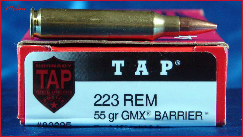

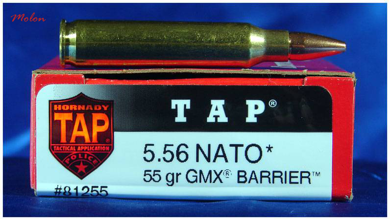

I’m not sure why you’re having difficulty understanding this, but the Hornady 55 grain GMX .224” projectile does not have a polymer tip; not as it is sold by Hornady as a reloading component nor as it is found in the Hornady factory loaded 55 grain, 5.56mm and 223 Remington, GMX TAP Barrier ammunition.

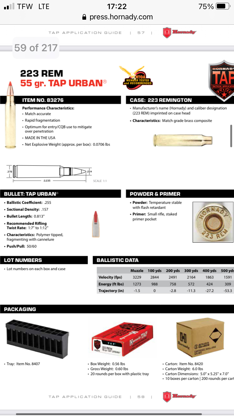

This is a 55gr GMX TAP Urban bullet with a polymer tip. As I said, some of them have it, some of them don’t it appears. The description and photo says it has one. As I’ve already said, I won’t be finding these in bulk as a reloading component obviously.
No, it isn't. The bullet in that pic is not a GMX bullet. The 55 grain TAP Urban load shown in your picture uses the Hornady 55 grain V-MAX projectile which is a lead core/jacketed varmint bullet; the same bullet I posted a picture of in my original post in this thread.
Your picture . . .
My picture of the 55 grain V-MAX bullets . . .

Yeah, TAP Urban (P/N: 83276) =/= TAP GMX Barrier (P/N: 81255). They may both be under the TAP banner, but the Urban load in your photo is not the same projectile as the GMX Barrier. The GMX does not have the polymer tip.
