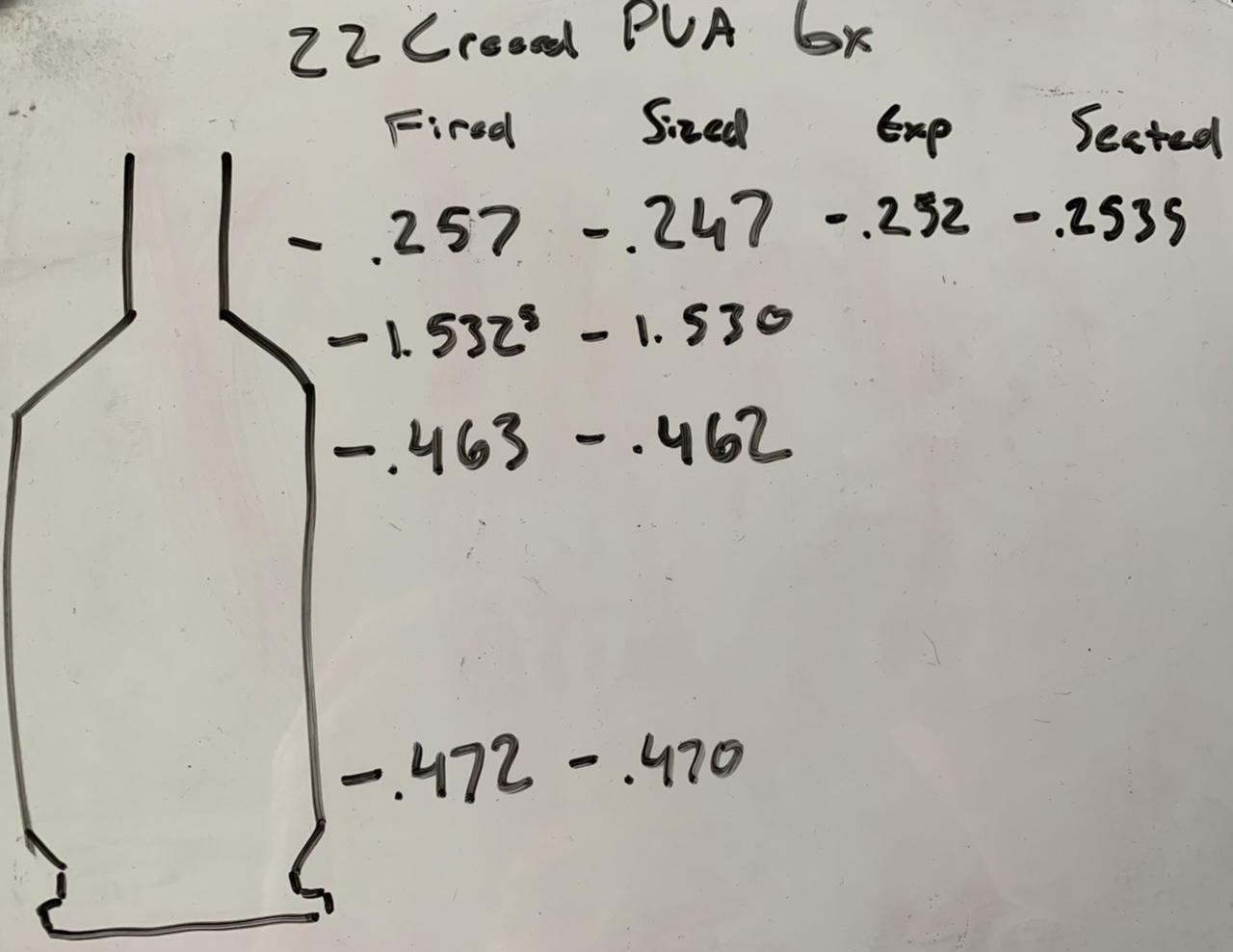

When it moves up the large fired expanded neck passes freely over the expander enters the bushing and is sized down to fit inside it as it goes up. Then the case gets retracted and after the neck leaves the bushing it will then encounter the expander ball which is not larger than the neck and gets forced open as it is dragged out.
To get the inside neck diameters you would just subtract the brass thickness from those measurements. My loaded round is .2535 minus bullet diameter of .224= .295 of brass thickness. Divide that by two and the thickness of each side of the neck is .01475” thick.
Reactions: TommyD11730
Thanks for the diagram, and the time. I was always the kid in the back of the room looking at the blackboard. When the teacher asked any questions I didn't even know where to begin. :)
