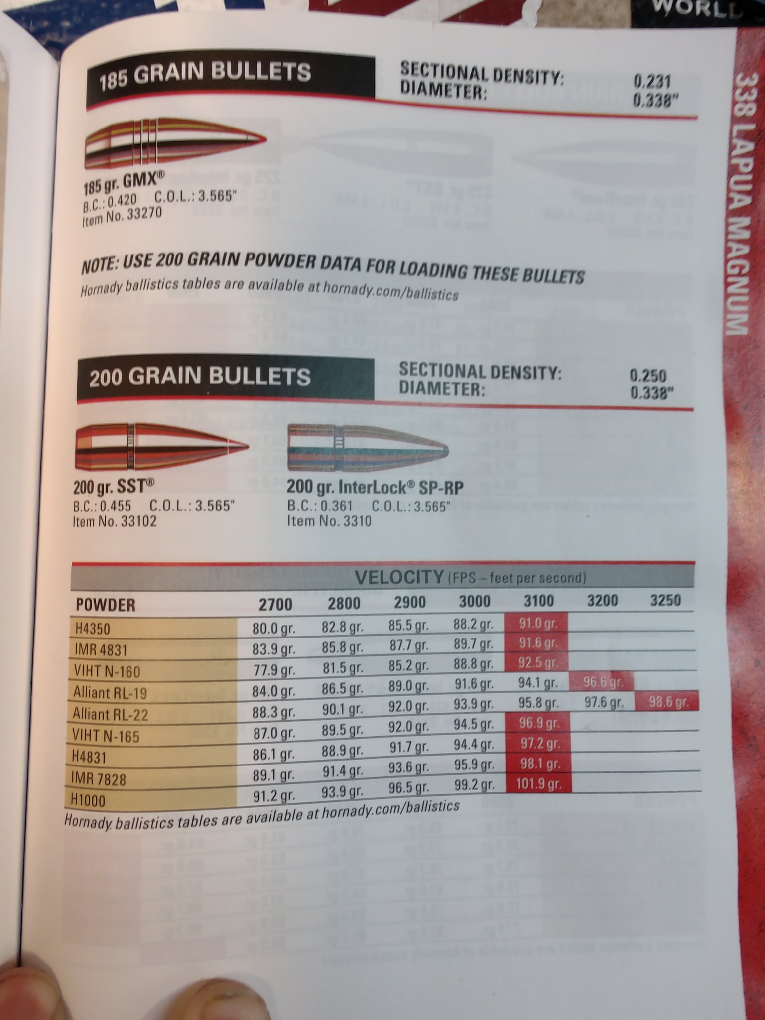

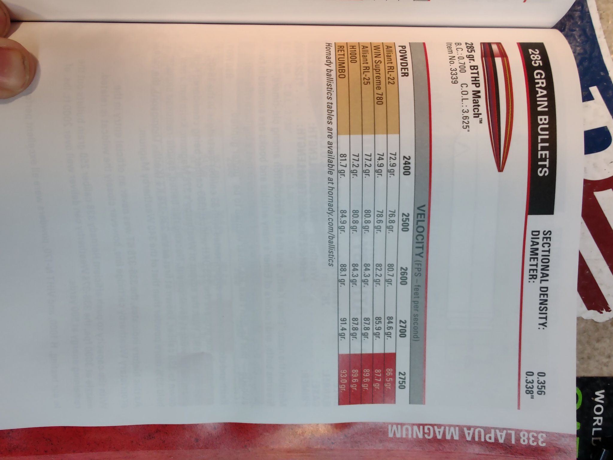

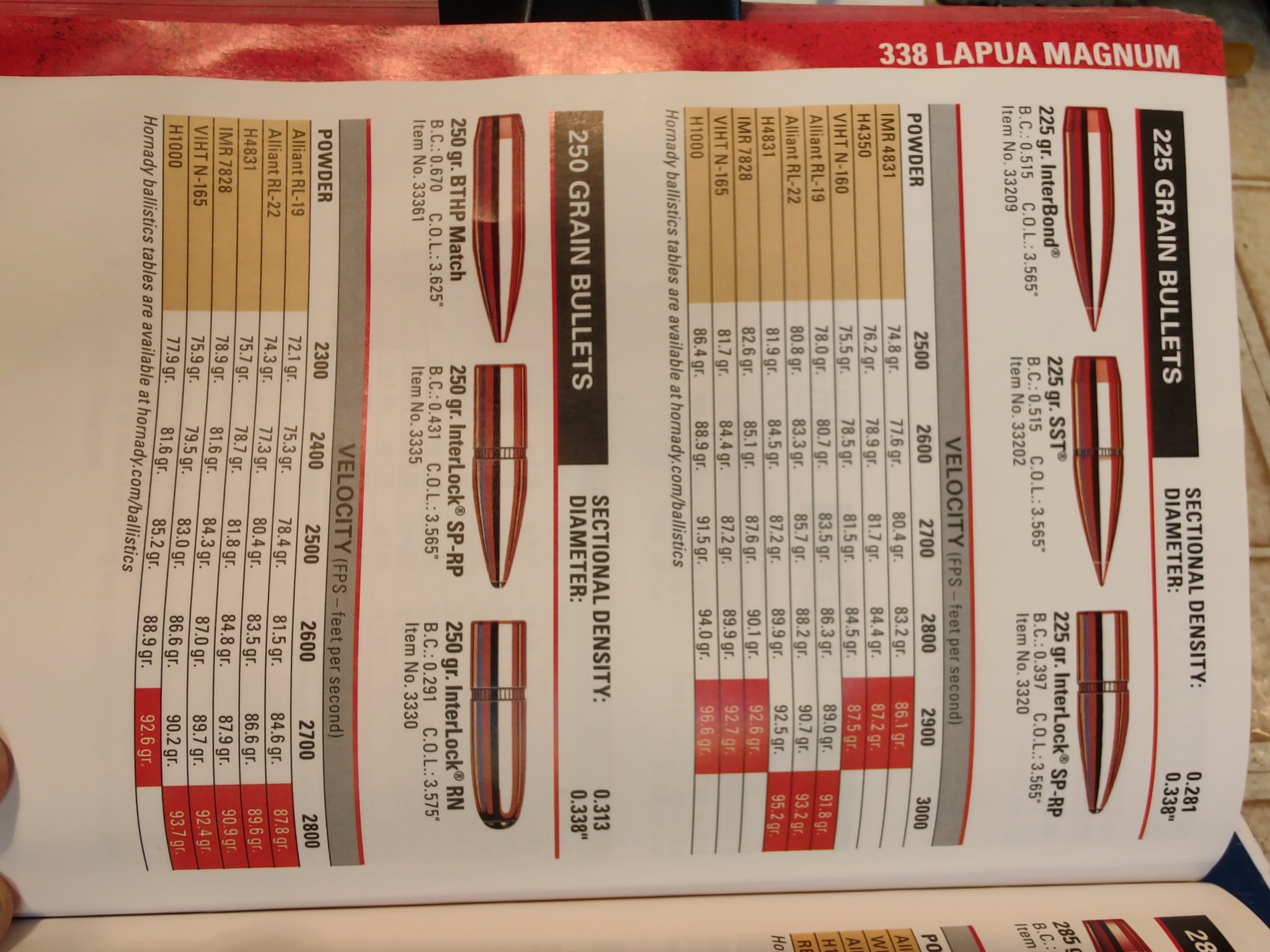

Does anyone have the Hornady Reloading Manual #10 that they would be willing to share the .338 Lapua load data?
Thanks!
Hopefully these pictures work. I haven't loaded pics on here yet. The header page won't load for some reason so if you need it let me know and I can take another. This is all of the actual data they list though.

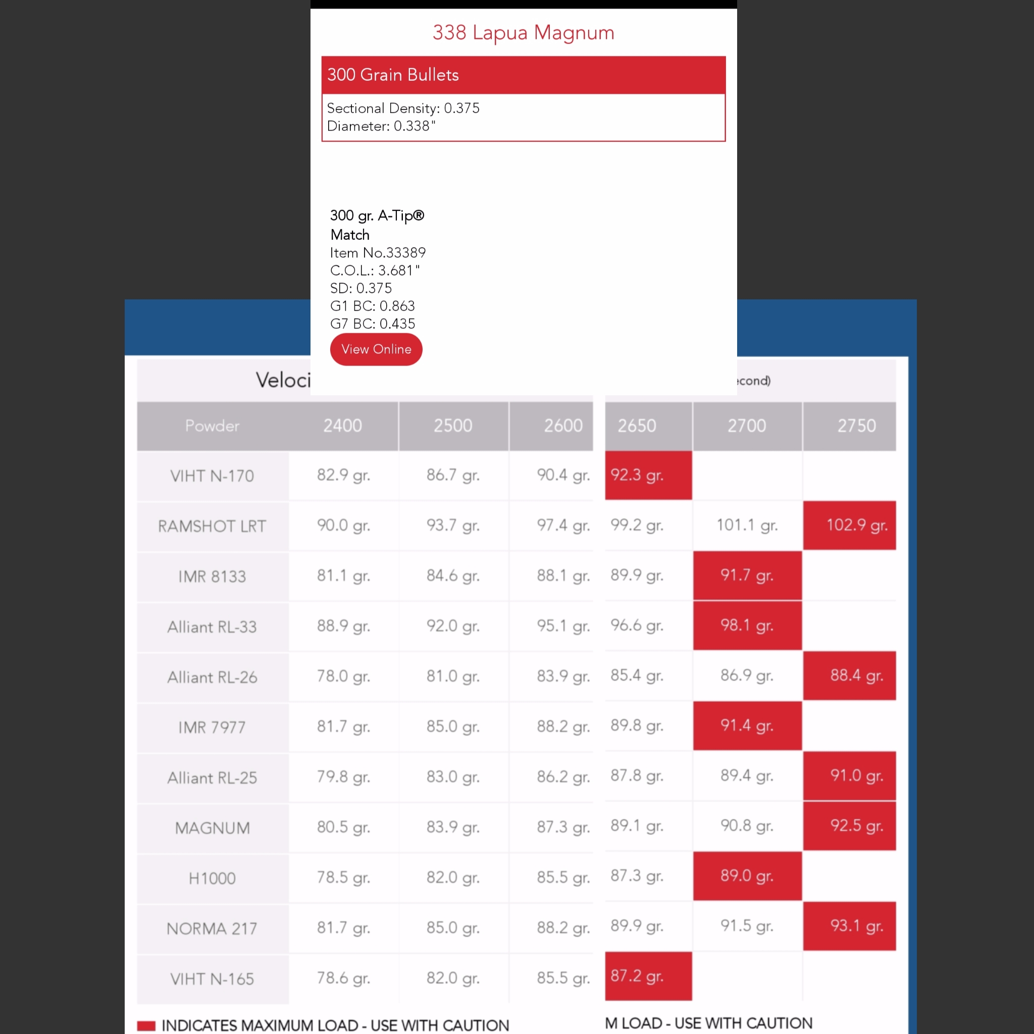

Thank you very much! I'm surprised they don't list data for their 300gr bullet.
I know! I have the unofficial 11th edition in my phone. I'll look and see if they show anything
