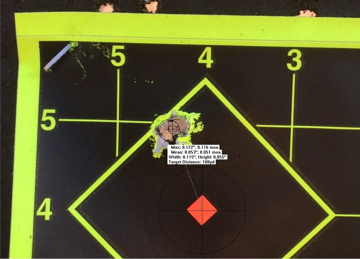

I bought 100 pieces of Lapua brass but haven't loaded them yet. Workmanship and uniformity look great. But during load development with the Hornady brass, I shot a couple of three round groups in the 1's at 100. So I don't expect the Hornady brass to be much of a limiting factor. I'm running 41.8 - 42.1 gr of H4350 (near max load so usual caveats) with the Hornady brass at about 3060 fps. Didn't chrono the factory loads.
