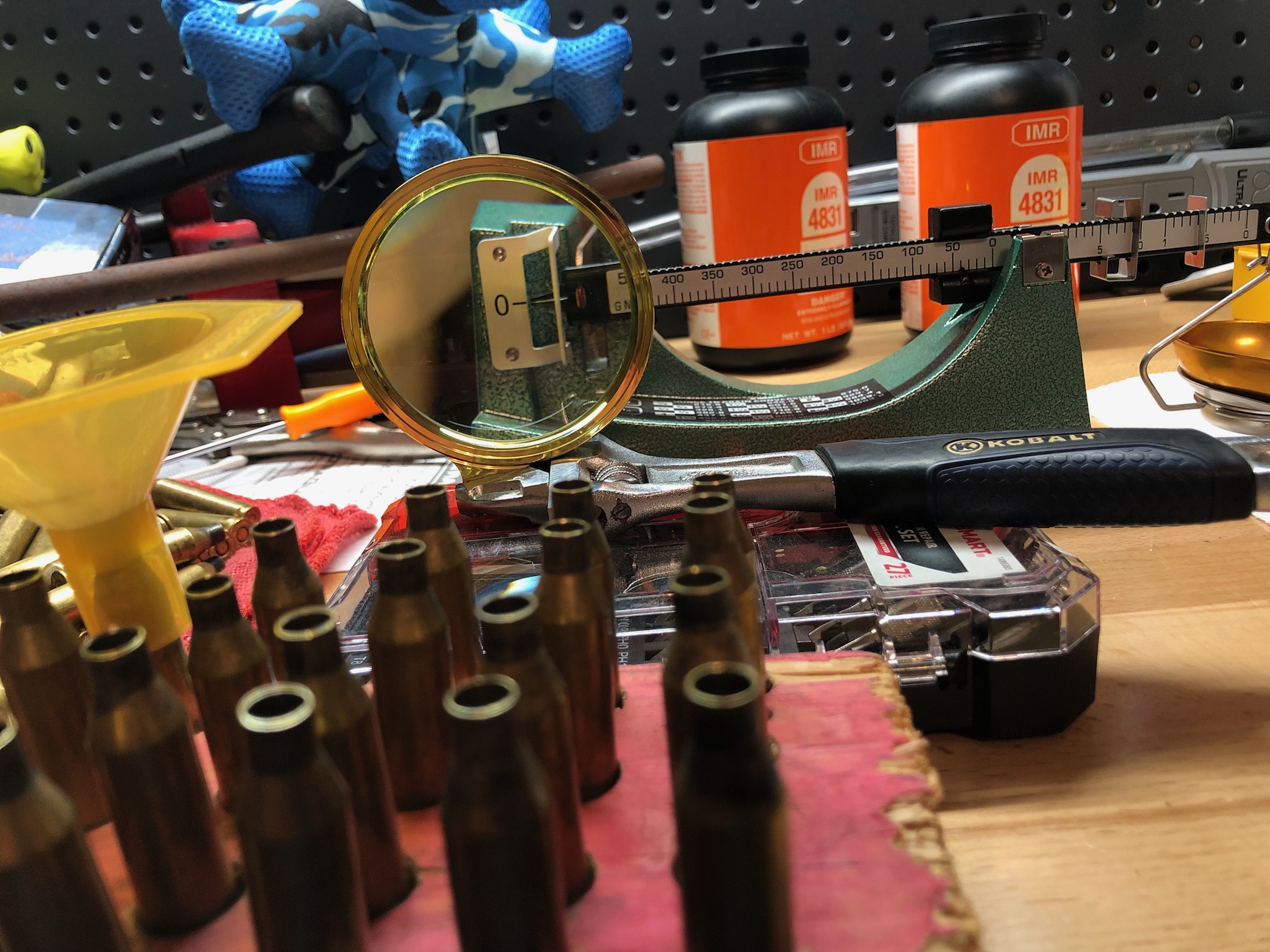

So how accutare is my RCBS 505? I make sure my scale reads zero every time I set it up. I have check weights that I have checked the scale with and its dead on. I've weighed a charge, taken the pan off and then put it back on, reads zero again. I've weighed a charge, then changed the scale up 0.1 and down 0.1 to see where the needle sits and it's probably a 1/3 to a 1/2 way up and down the scale the needle points at. so that spread from zero to the 0.1 difference can be easily seen. When I trickle a large grain of IMR4831 I can see it move the scale more than when a small grain goes in.

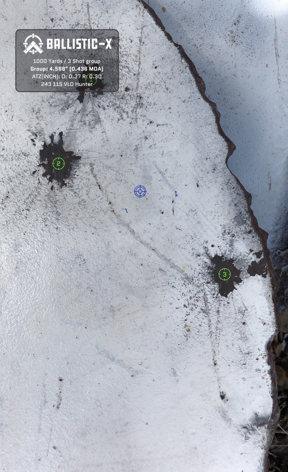

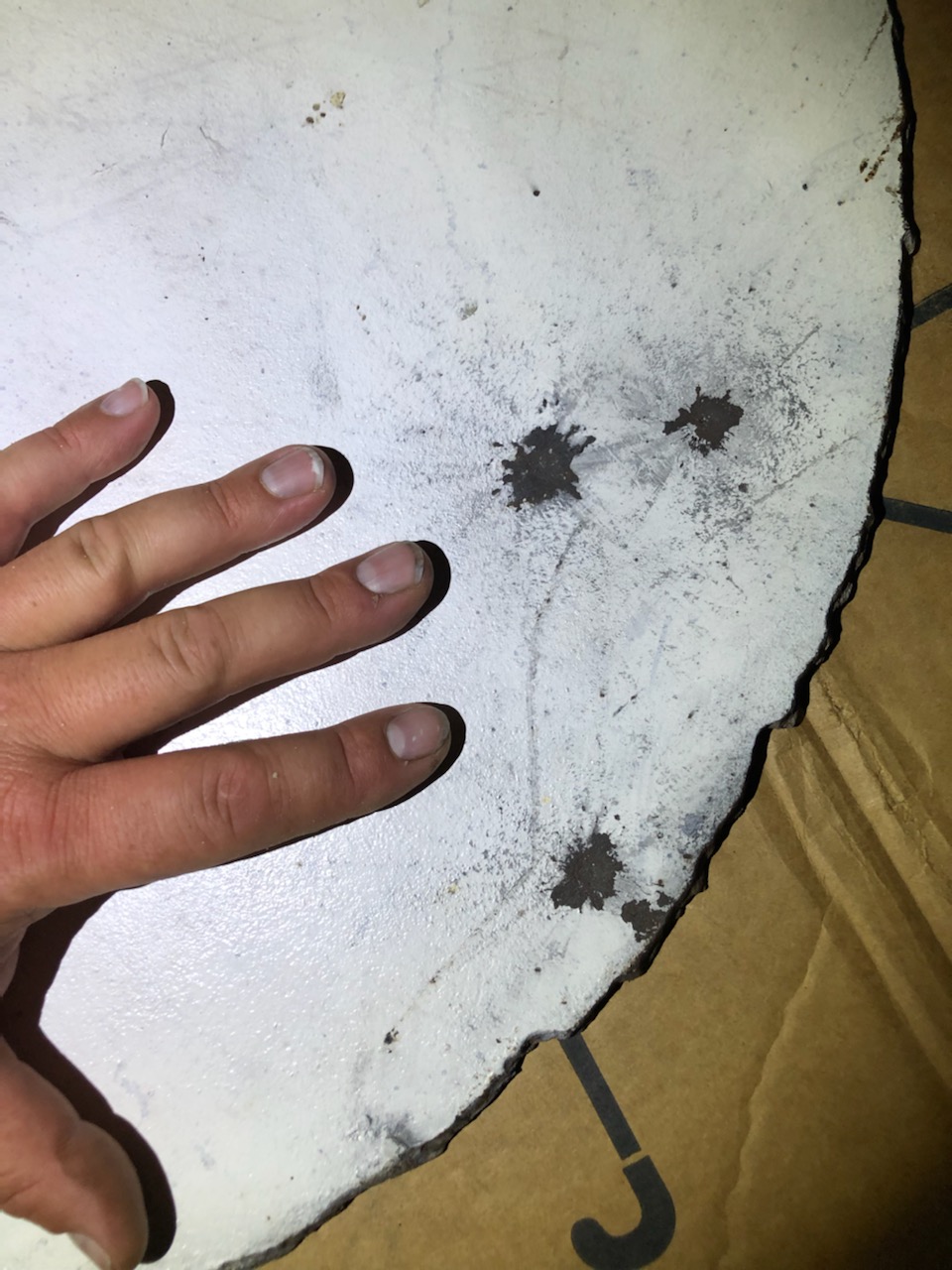

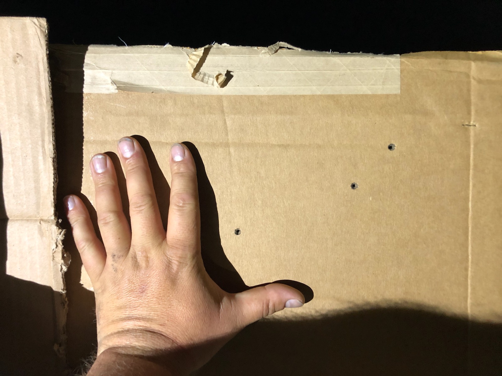

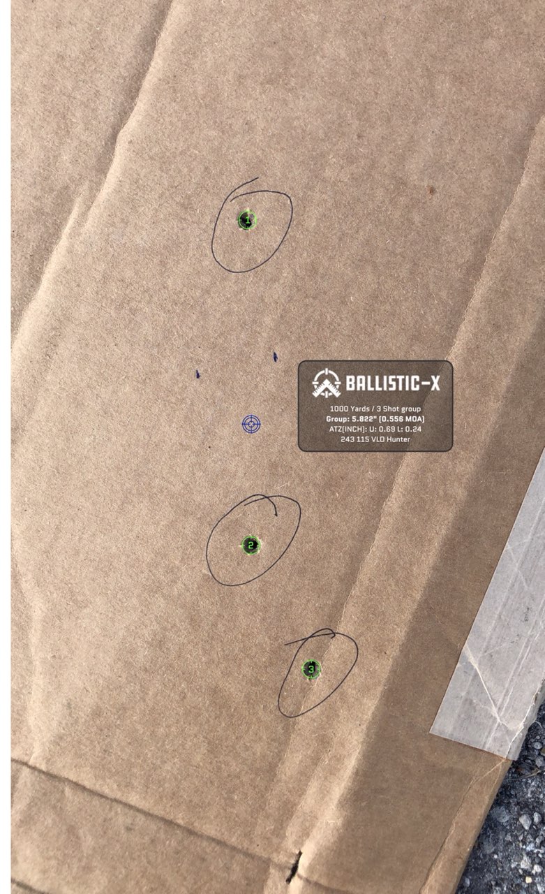

Here are a couple 3 shot groups at 1,000.

I can see smaller than 0.1 on my scale, and I get as close to zero as I can. And I use a magnifying glass.

I like that magnifying glass setup!

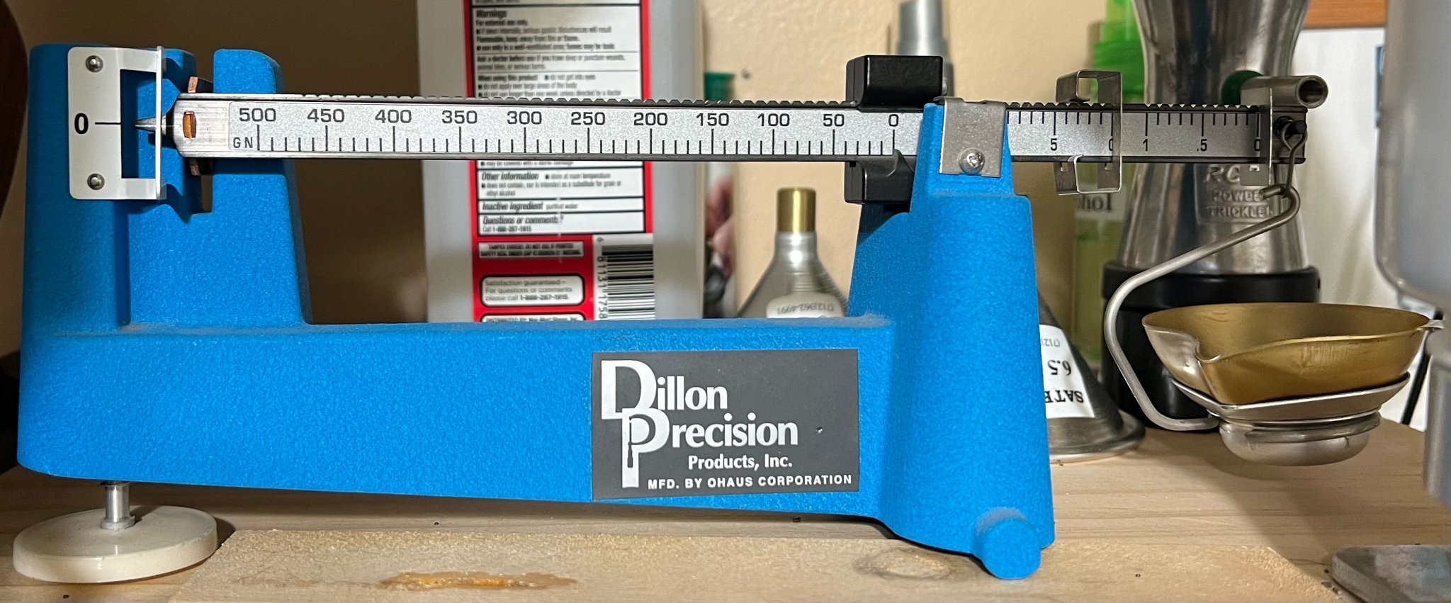

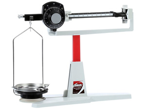

Call me a beam guy as well. Have used several digital scales over the decades but the drift (despite all efforts at eliminating it) kept me from achieving consistency. My Ohaus-made Dillon Eliminator is boringly consistent - and that's a good thing!

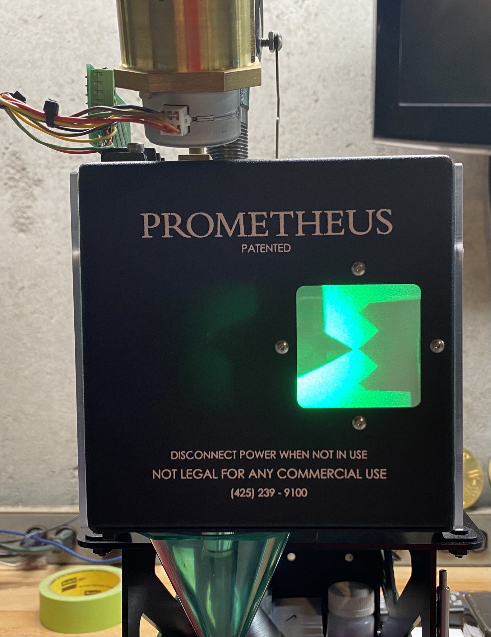

Where the gains typically need to happen is how one gets the powder in the pan. You can scoop it, you can trickle it, you can use tweezers, or you can use some advanced way to drop powder. The big advantage to things like a Prometheus is that it can drop really accurately and trickle in very fine increments. On top of that it can do it quickly and repeatably. The 'scale' part of a system like that is just one part of the entire system.
