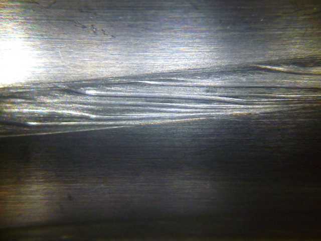

This is what happens when you use a brush with an abrasive cleaner! I've posted this picture several times and it never gets old as to what can happen!
This was a 7mm (284W) F class barrel. At 100 rounds accuracy started to suffer. The picture is at 800 rounds. The bore and groove should measure .277" x .284". It now measures .279" x .2855"! So basically polished a full .002" out of the bore and .0015" out of the grooves. The lands (the bore) sticks up so it will take the brunt of the damage from improper cleaning.
The gouges are from the bristles of the brush and the brush is trying to rotate with the twist of the rifling but there is no way every bristle is going to follow/stay in the grooves. So the bristles will ride up and over the top of the lands and down the trailing side of the land.

As an update.....
People keep doing it!
Got in a 260AI F class gun last week. Similar gouge marks are showing and the shooter has polished a full .002" out of the barrel.
Bore should measure .256"....it now measures .258"!
Groove should measure .264" and those measure .2657".
Supposedly the barrel only has a 100 rounds fired on it.
Bullets are going thru the target sideways even before a they get to a 100 yards. Why....basically the bullets are skipping/sliding over the tops of the lands/rifling. Think about it...if the grooves are almost at .266" and the bullet diameter is .264". That only gives you a .001" per side to bite and drive the bullet and stabilize it.
Later, Frank

Not the first time guys have done it to a brand new high end barrel.
I've told guys this. If you have a lower quality or a factory type barrel that is really rough and fouling bad and you don't have a lot of money to rebarrel the gun and or the barrel is coming to the end of it's life and you want to try and smooth the bore out etc....you've got nothing to lose. Try something...or experiment on something where if you wreck it your not out a bunch of money.
On a barrel like ours...I tell guys if your having a problem give us a call first and let's try and figure out what is going on before you start doing stuff to it that might make the situation worse or you damage it to the point that it's junk etc...
