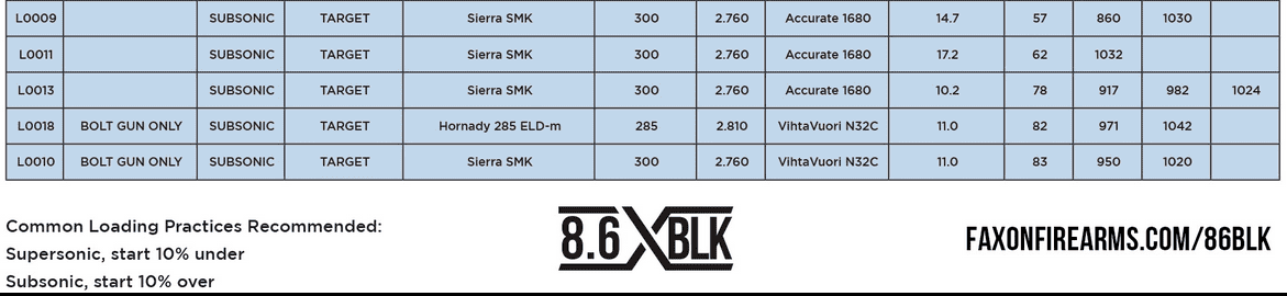

    The Faxon load data show this running 300 smk or 285ELDM, which I cannot help but think is a very expnsive 200 yard bullet. 🧐
    Field reports have this chambering shooting accurately well past 400yds. Of course it’s expensive, but it’s not a gun I’ll shoot 20K rounds a year through. Just a rifle to slap steel hard at distance with a whisper quiet rifle.

    The cost of a bedding job or truing an action seems trivial in the context of feeding a rifle that eats $1-1.50/each bullets.
    If you need to shoot solids or bonded bullets to keep that 3 inch twist from shredding your SMKs or ELDMs, god help your wallet :ROFLMAO:
