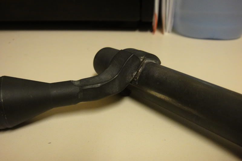

So I decided to start reloading the cheap way. Went with lee classic reloader. It only sizes the neck and it said use brass from the gun you fired it from. Well I own 2 308s but most of the brass I have was out of this gun so I thought no problem. I loaded the rounds up and remember the use the same brass thing. So I start seeing what brass will work in one of my guns (it has a match cut chamber fwiw). Well after around 7 rounds one gets stuck (some wouldnt let the bolt go home but I was able to rack the round out). I grab my Rubber mallet and start lightly tapping the bolt. It feels like it is coming and finally pops out. I try to push the bolt home and notice something is not right. It seems that I damn near ripped the handle off the bolt. So How f---ed am I, how much will this cost me to fix and when I take/send it in to get fixed do I have to send the gun with?

That can be shaped back and soldered or welded on. Some folks also like to have screws installed that will prevent this.
Find a used RCBS Rockchucker so you can re size the case. Takes the guess work out of it and will give more consistent loads.
If you need some dies, I will give you some RCBS dies if you pay the shipping. That is if you are short on cash.

I've done that twice already. Best to get it welded on. There is a reason why a lot of aftermarket actions now use a 1 piece bolt now.

I don't see any evidence of an overpressure condition, just a piece of brass that was not properly sized and a bolt handle that nearly broke getting it out.
Just get your bolt repaired and you'll be good to go.

Send it to Dan and have him put on a PYG bolt handle, then you can interchange bolt knobs if you want. Contact him, there is a measurement you will need to give him as well that is in relation to the action. Dans40X is GTG.

Well I don't think there was pressure signs due to it being a live round. I never fired it. The bolt pushes forward and then engages the lugs about 1/8 of an inch and stops. When trying to cycle it back it goes back up but wont come rearward. I learned my lesson here and hopefully i can get a full length die and press. It only takes money and I don't have that much right now. Maybe for my birthday.
I will PM Dans40x and see if he can fix it. Thank for the info everyone.

I have seen this happen more than a few times without a rubber mallet or a tactical handle. On hunting rifles I have seen them just fall off while working the bolt normally. When I get my tactical handle put on I'm haveing it tig welded at the same time. I was wondering why with all the tactical handles around here I haven't seen this more.
