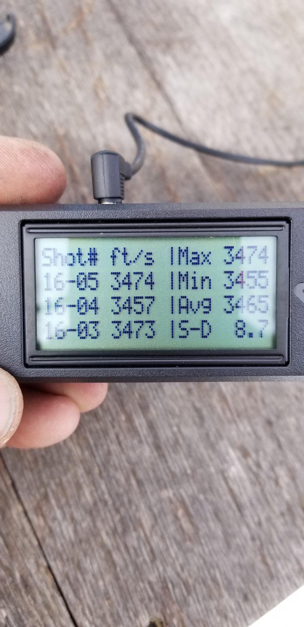

With an SD of 8.7 and an ES of 19 fps, you are in the right ballpark in terms of the quality of your reloads.

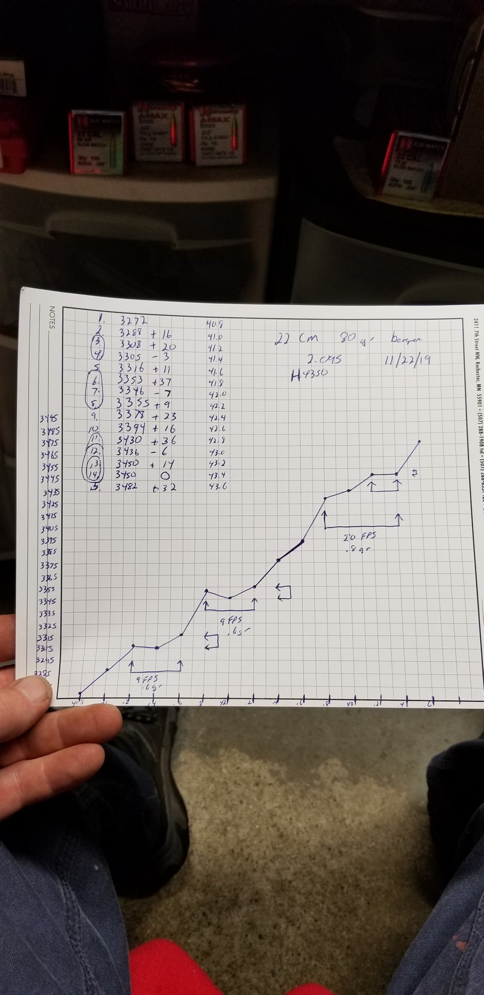

Here is some info that I perhaps should have included much earlier. Its the ladder test used to determine the load and the target I shot while conducting the test. Maybe youfellaswill see something that I don't
