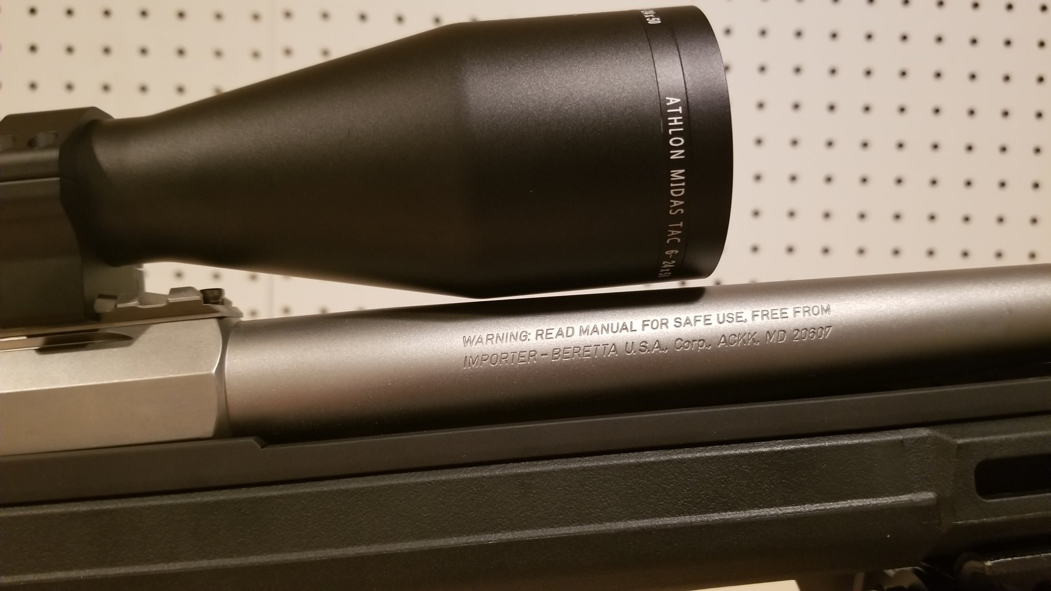

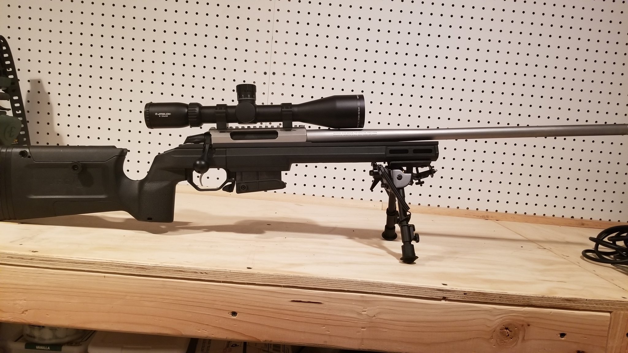

While admiring my Tikka CTR in 6.5 CM after mounting it in the KRG Bravo, I am noticing that the scopes objective seems very close to the barrel. I understand that goal is typically to have it as close to the centerline of the bore as possible, but this seems pretty close. Scope is Athlon Midas Tac 6-24x50, rings are Warne Maxima Horizontal lows. So I ask, "how close is too close?"
As long as there is light between them...although caps usually won't fit at that point.
The close as possible is outdated.
You want the optic in the proper place for you. Doesn’t matter how high or low it is.
I prefer to get the optic as low as possible and adjust my head position by changing the LOP and riser height. Even if that means stacking mouse pads and duct tape. Then you get the best of both worlds.

There’s almost zero benefit to lower height. It’s not a “best of both worlds.”
You should be adjusting the optic to the shooter. Not the shooter to the optic.
While admiring my Tikka CTR in 6.5 CM after mounting it in the KRG Bravo, I am noticing that the scopes objective seems very close to the barrel. I understand that goal is typically to have it as close to the centerline of the bore as possible, but this seems pretty close. Scope is Athlon Midas Tac 6-24x50, rings are Warne Maxima Horizontal lows. So I ask, "how close is too close?"View attachment 7388821View attachment 7388822
I think your good. Just some covers and things won't work or at least without some modification.
Benefit to it being lower is a smaller overall height of the rifle, super minor but I'd rather have that than it be taller than necessary. Theres also literally no reason to have it higher than needed unless I'm missing something there.
Adjusting the comb height and LOP are exactly the right way to adjust the rifle to the shooter.
You’re absolutely missing it.
Set the rifle up to the shooter with LOP and Cheek height first. Then get the proper ring height.
LOP = proper spacing between shoulder and trigger to get the proper reach and trigger press. Has zero to do with the optic.
Cheek height = get the shooter’s head as erect and comfortable as possible. Should only be adjusted slightly for scope height. Basically if say you needed 1.58” rings but they only make 1.5”. You’ll adjust that .08. But when you really need 1.58“ rings and you’re using .94” because it’s “as low as possible,” now your head is being rolled more than it should be.
This is why when you go to a reputable instructor, if they see an issue, they will pull the optic completely off the rifle and get you setup. Then they will place the optic on and move it to the shooter. If the rings are too low, you’ll make it work for the class with the suggestion to purchase higher rings.
And a rifle being 1/4-1/2” shorter doesn’t benefit you in any measurable way.

Thanks for everyone’s replies and advice. I’ll try it out like this tomorrow and start looking at higher rings. I’d at least like to be able to fit some caps.
