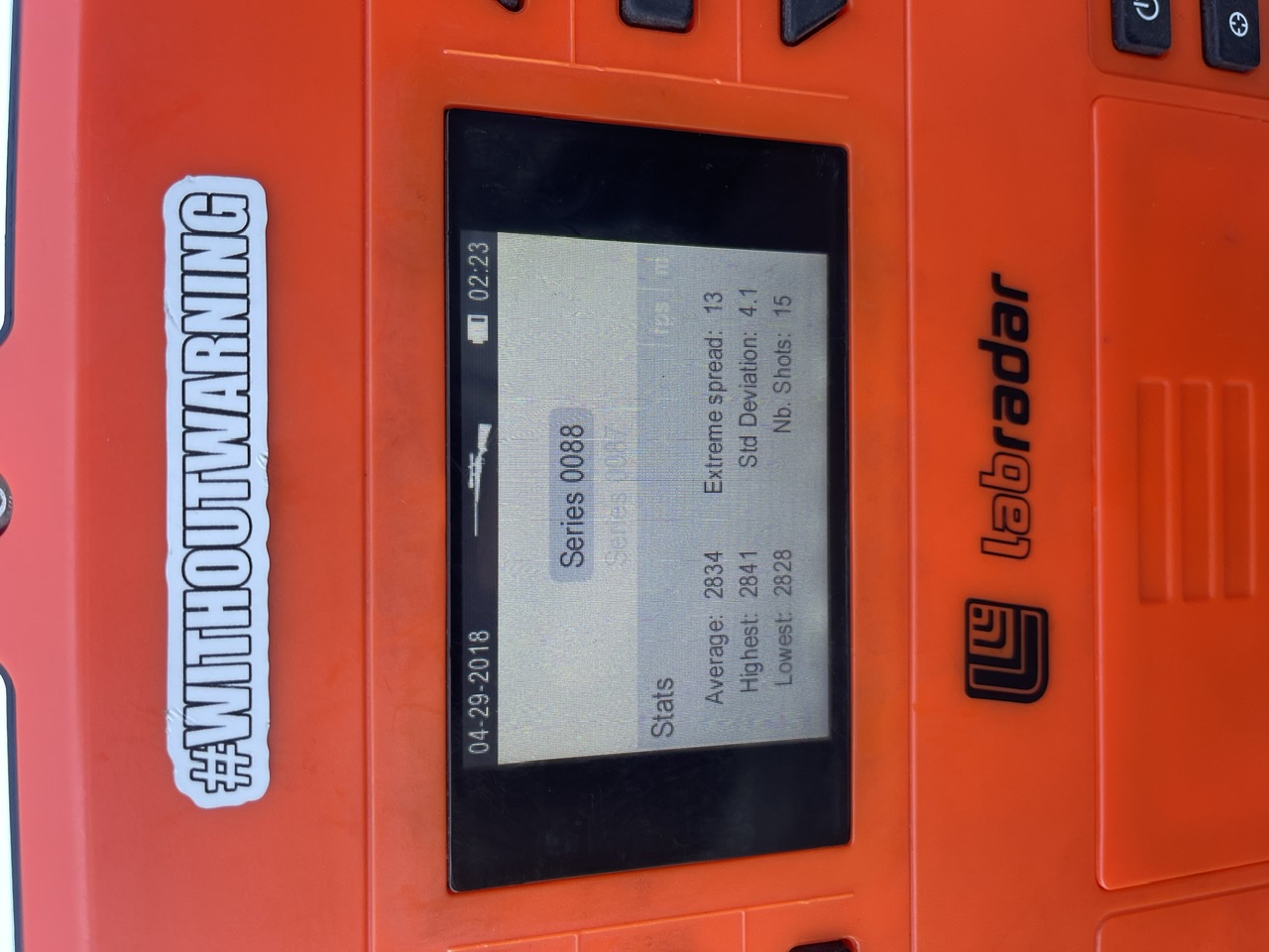

I used to trim, chamfer and deburr every firing. But with this new barrel I haven’t trimmed once. I put a chamfer on the virgin brass and that’s it and this barrel has been the best shooting barrel/load I’ve had in a while. I have about 5 thou of variance and 4 firings on them. Once they grow to trim length I’ll trim them back to min but that’s it. I’m slowly experimenting/trying to stop doing things that don’t matter to save time and make loading quicker and easier and this seems like one of them I can cross off the list.
6GT
Lothar Walther 1-7.5 twist 24 inch
Alpha ocd brass bumped 1 thou and 2 thou neck tension
110gr atips 30 thou off lands
31.9gr h4895 2835fps
Cci br4 primers
