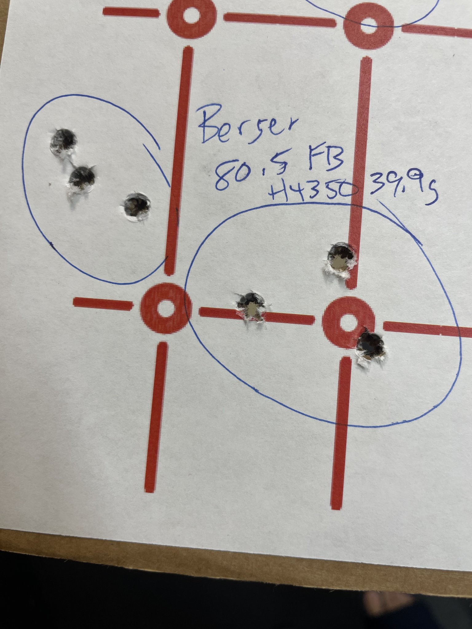

Im running an ultra 7 30 cal. Ive only
Really used it on my gas guns. Built a 22 creedmoor for coyotes and running a can. It was built by a very good gunsmith. Well for 170 rounds I chased load development with 80.5 bergers and 75 elds. Best I could get was .5-.6” at 100. I had 4 rounds left and light bulb finally went off and I took the suppressor off. Shot 0.26” four shot group.
So I load 5 more. Shot another .2-.3 five shot group. Not sure what the issue is but a very significant improvement in accuracy. Could the .30 cal bore cause too much turbulence or something. Or do you think its a harmonics issue?
You sure the can is absolutely secure and that a cover isn't sliding forward of the muzzle on you or something?
This is how dramatic the difference was. Also was 3” straight up shift in poi.
Heres 2 - 3 shot groups with and one 4 shot without suppressor.

I saw similar on a 19 Calhoun running a 30cal can. In my case tweaking the load got it better, but running a 5.56 can was the overall answer. Groups got back to normal with the smaller can.
