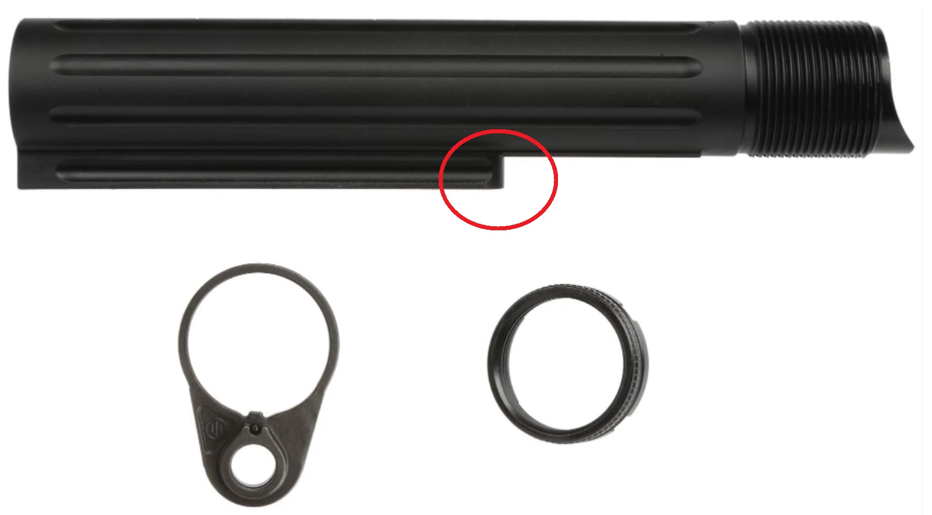

About to buy a Magpul PRS Lite for my latest build but I wanted to see if other people here are running this stock. I’ve heard that they can have fitment issues with certain buffer tubes but I was wondering if those issues have been resolved.
There are fitment issues though. Let me explain.

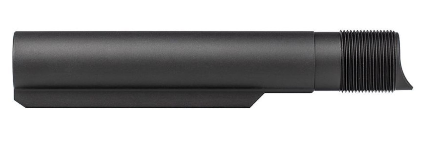

Look at the picture below. This is an enhanced PWS buffer tube. It will not be compatible with the PRS Lite. The little area of the channel that I have circled is the part on a regular buffer tube where the stock will index. If you use one like this your stock with rock back and forth about 1/2 and inch or so.
The PWS buffer tube is awesome, but it just doesn't work with the PRS Lite. Use a standard buffer tube design and you will be fine. On a standard one that area is sloped. The second picture is a standard buffer tube.

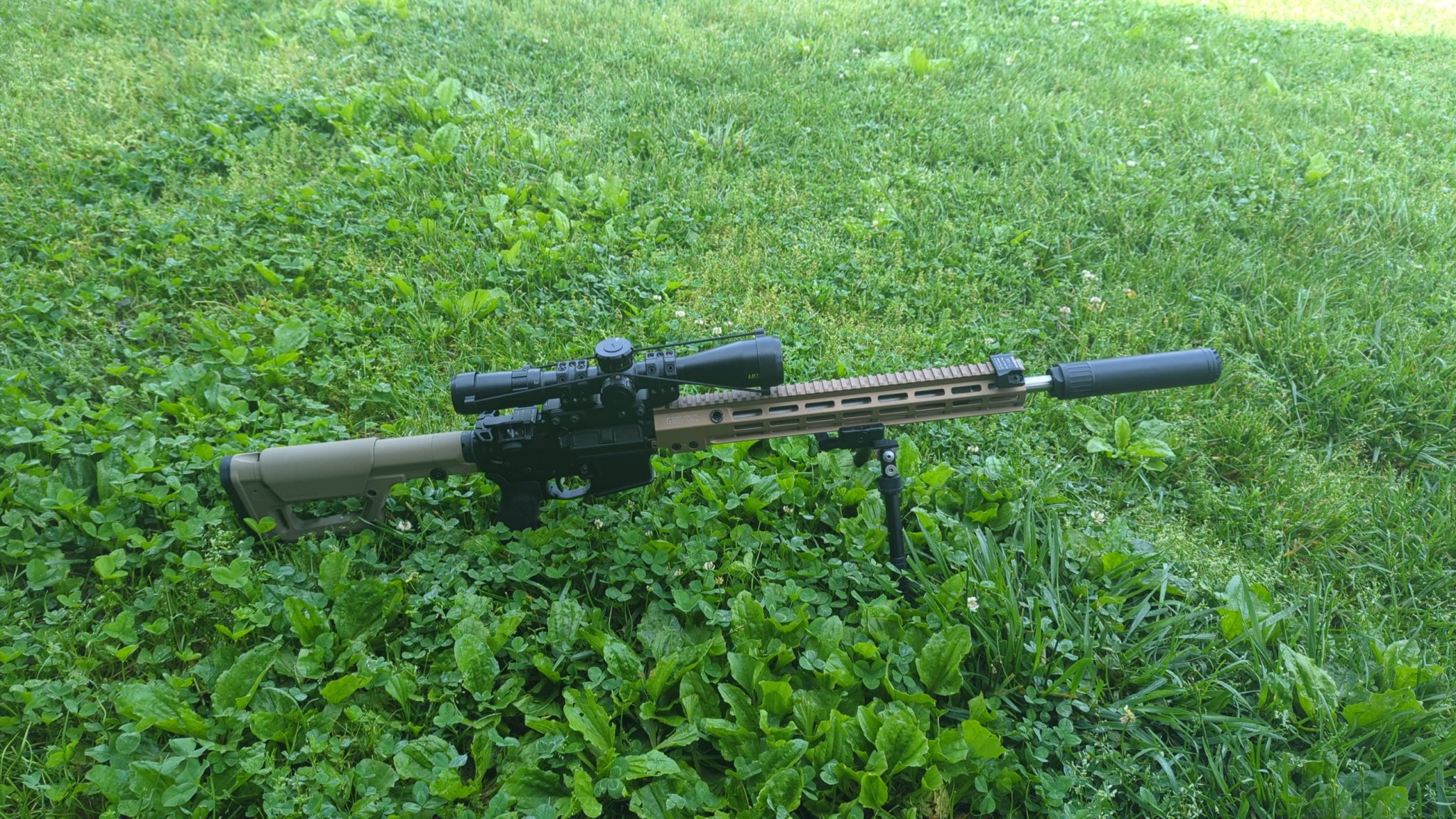

I just finished a custom .308 for a customer who specified the PRS Lite.
I was pretty underwhelmed. The cheek riser is too far back (in order to clear the charging handle) on the stock to do any good. A number of carbine type stocks provide a better cheek weld, more adjustment in LOP, weigh much less, and cost less.
I was pretty underwhelmed. The cheek riser is too far back (to clear the charging handle) on the stock to do any good. A number of carbine type stocks provide a better cheek weld, more adjustment in LOP, weigh much less, and cost less.
I don't know what i expected, honestly. Maybe for magpul to take my disappointments from the PRS line and fix a couple thing, LOP and riser for starters. I have one on my latest large frame I put together, but i'll bitch about it whenever possible. What i'm most salty about however, is that it's the only one i have that I don't have a LAW folder on because that sends the LOP from "why is this so fucking long?" to "ok now its just ridiculously long"
Nice build regardless though. I'm sure he's happy at least.
No. You can solve the issue by 3d printing or creating a spacer out of *insert durable material of choice* to fill the gap between the buffer tube and stock though. I used a piece of delrin to make it work with a PWS buffer tube.
That rifle does look tits though, so that's gotta be worth something.
Not to completely derail the thread, but is this cerakoted armor black, graphite black or neither? Have had similar experiences with the PRS lite having the cheek riser too far back.
