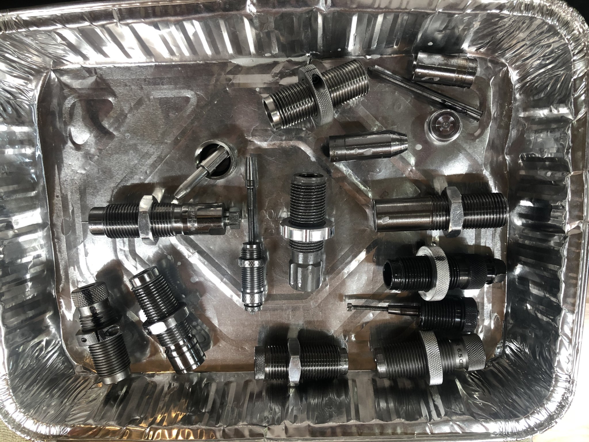

I just did mine this weekend. Redding bushing die, mandrel die and micrometer seater.
1. disassemble die.
2. blast with brake cleaner.
3. Nylon cleaning brush with Boretech, then a patch.
4. light coating of oil when putting back together.
5. light coat of case lube when not in use and store in a ziploc bag to prevent rust.

Took them apart, filled the inside with OneShot foam, and let it sit for a few hours. I thought i saw a tinge of blue, but wiping up the liquid that dripped out with a white paper towel, it seems it is mostly carbon residue.
Maybe i have too many sizing dies... 😊
