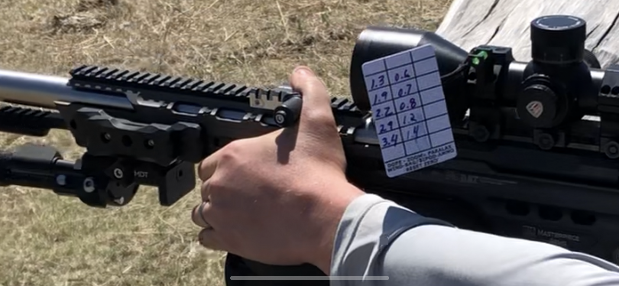

Gamechanger under at magwell/balance point
Support hand gripping the GC, MPA siderail and home made post off the side.
I have a full modified ESR nightvision cover over the barrel. It has the rail removed and grip tape added.
I do place my hand on top of the scope resting on the grip tape there for some positions like a window sill.
