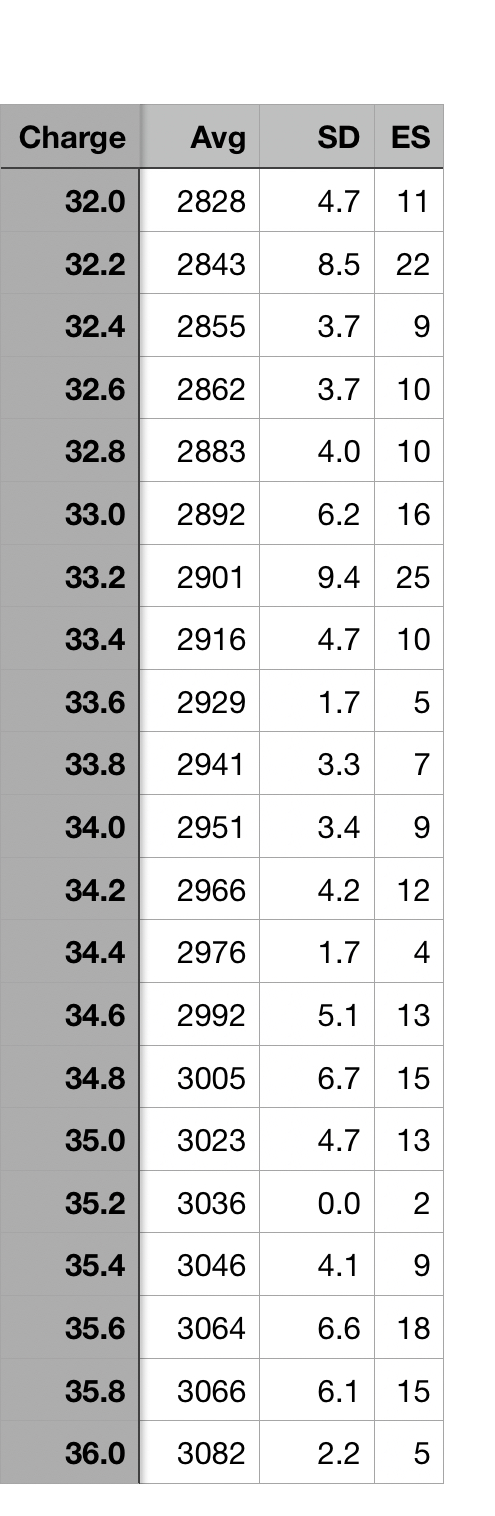

    Here is some data. If anyone can tell me why you couldn’t pick any powder charge from this chart and tune seating depth, feel free:
    @Dthomas3523 I couldn't agree more, although I will point out that 36 grains of Varget in Dasher comes out to be around 80k PSI in my software...
    I also don’t use groups or poi or anything on paper *at all* to choose a charge weight.
    If I’m doing load development, I use a chrono for charge weights. Once I’ve picked the charge weight, I don’t change it based on the bullet or paper. I change seating depth and such and work it out that way.
    I’m familiar with your method, but you're asking about this method, and you could answer the question for yourself in 20-25 rounds. Not a difficult process. In one string of fire you found max charge, found accuracy, and found a forgiving charge range. Consider you’re starting with a new barrel. All that left is seating depth. For me I pretty much know where I want to be anyway, and don’t have to change much at all.
    edit: Regarding your charge test, as I said earlier, those won’t print in a linear fashion up the target, but ranges of them will cluster together. You said in essence in that same post that you may need to rezero and you need a chrono. This is what we'd like to avoid.
    I don’t look for a node for SD/ES. POI is what I’m looking for. Again, if you have a fat barrel that harmonics won’t affect much it may not matter. But I’ve shot enough load tests on gas guns with .750 barrels to know the POI moves around significantly with different charge weights. If you pick a random load you may end up .1 away from a POI shift and that’s not where I want to be. I usually know about how fast I want to run a bullet so I load charges around that target velocity and skip the ones I know I’m not going to use. It literally takes 25-35 rounds at the most to confirm a consistent POI so to me that makes way more sense than just picking a charge. If they all print the same POI then I haven’t lost anything. A barrel needs 100 rounds to break in anyway. That being said I do agree that loading 5 rounds of an entire acceptable range in .2 grain increments is a waste of time and components. I know I’m not going to use 140s at 2620 FPS so I don’t care how it shoots.
