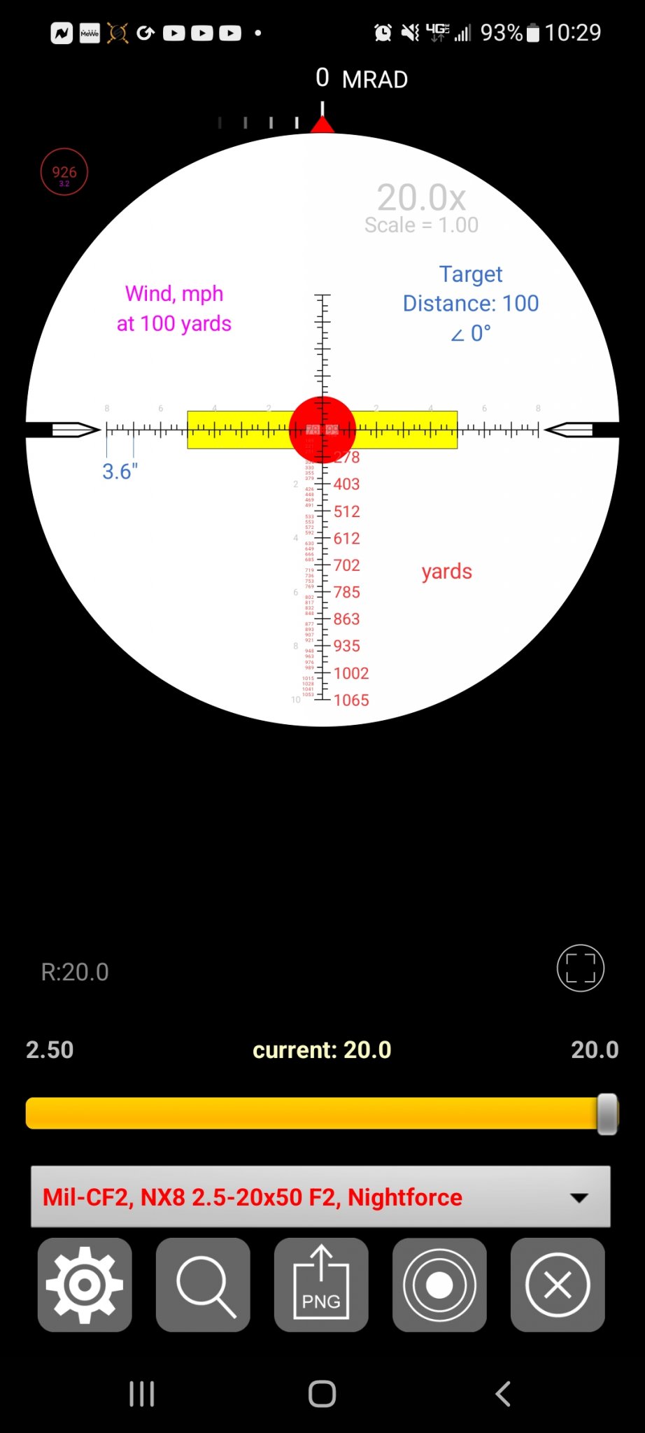

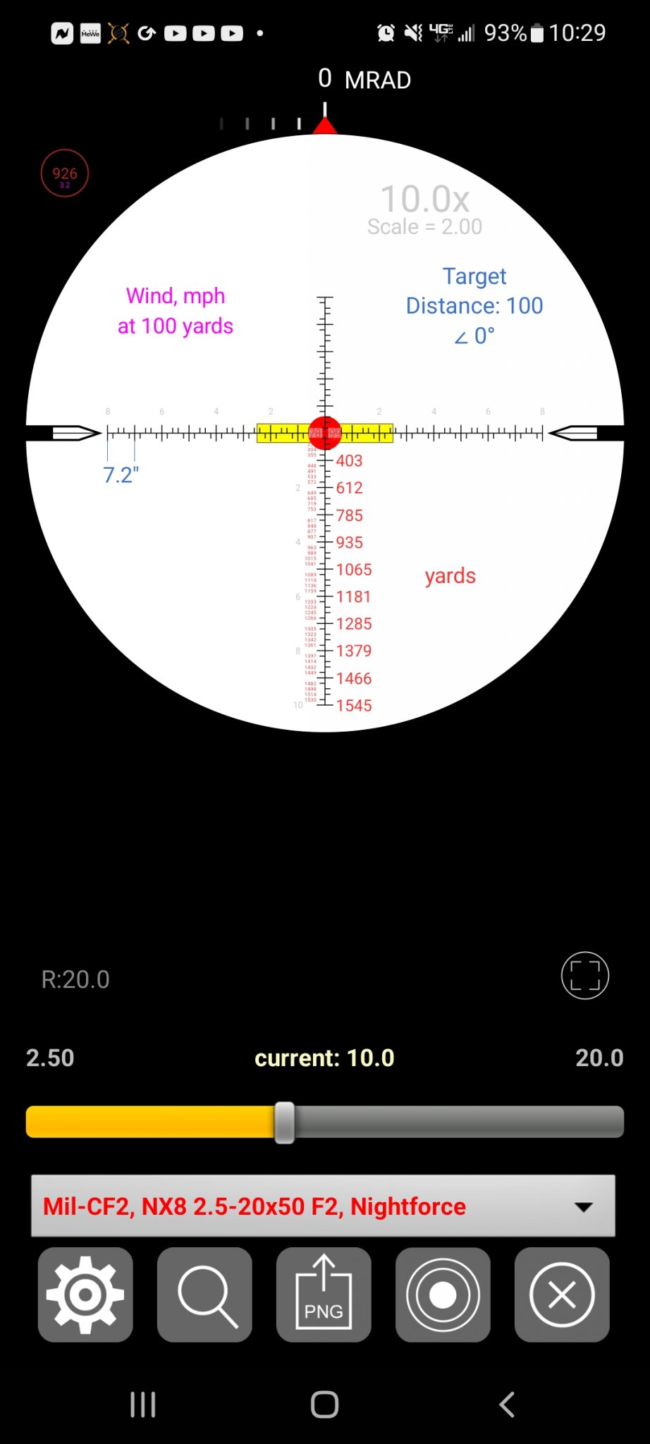

Best would be to look at a ballistic app like strelok it allows you to zoom in and out on sfp reticle to show the holds at different zoom levels
First one is a 5x36 bar at 20x second one is at 10x on a mil-c sfp to show what I mean

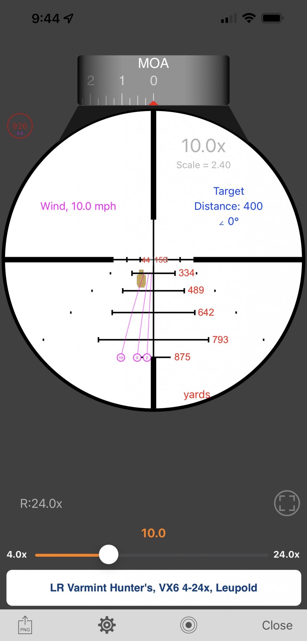

Hmmm there seems to be a bug for some Nightforce reticles in Strelok, at least on my iPhone. The wind drifts don’t show, and the wind mph doesn’t show either. So, I used a Leupold MOA reticle. Forgive me lol.

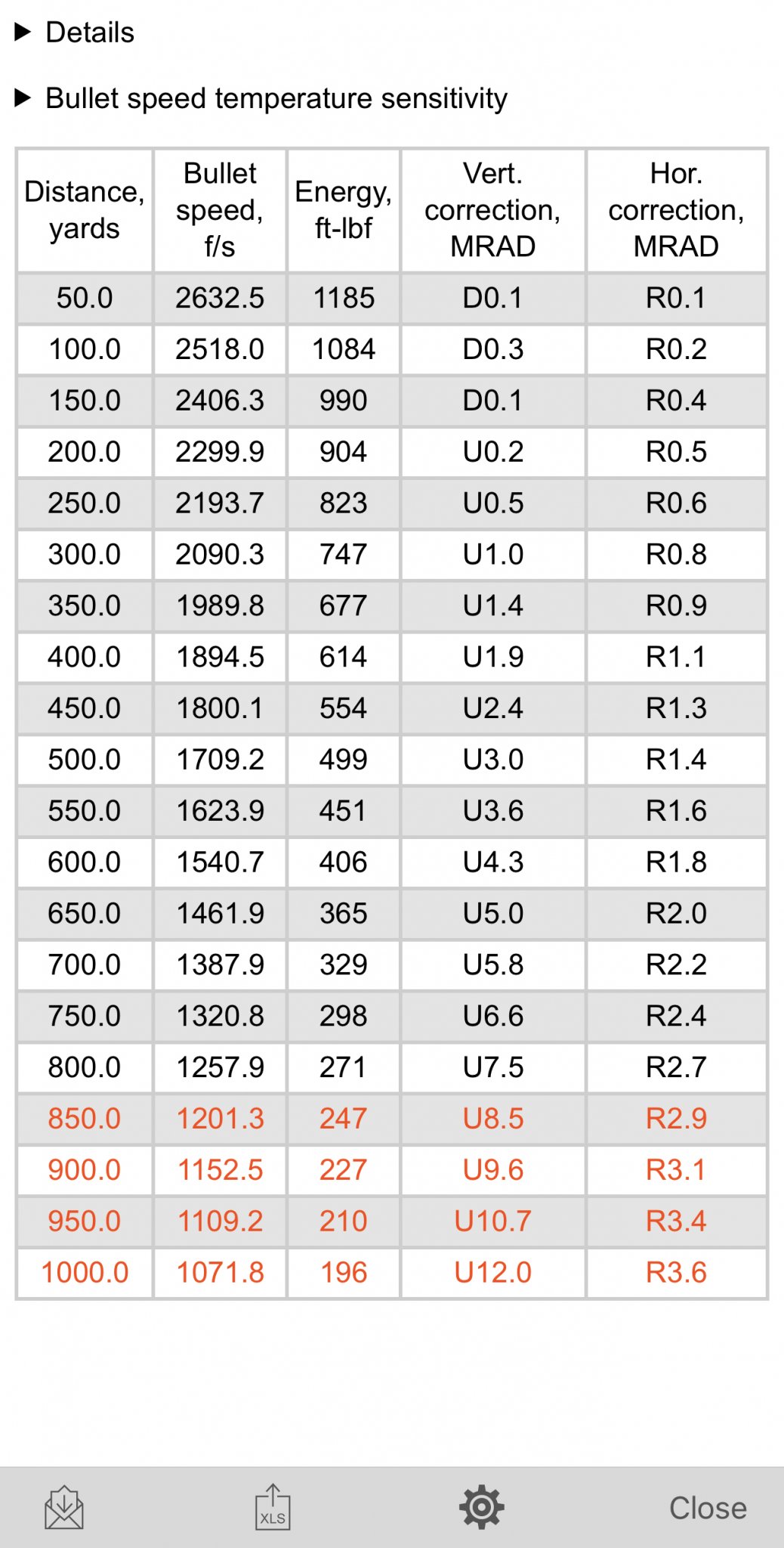

Below is a sample table. You can configure it with MRAD or MOA, drop in inches, time of flight, etc etc etc. In my sample, the zero is 150yds, and I have the option checked for Strelok to show the effect of wind on drop. In this example, at 150yds the zero is slightly affected by the crosswind because of the right hand spinning of the bullet. Pretty neat.
