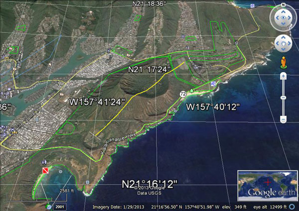

Koko Kai Place is approximately 2,550 yards directly downrange from the Koko Head rifle range firing line, behind the Koko Head Crater rim which rises a maximum of 678 feet above the floor of the range.
