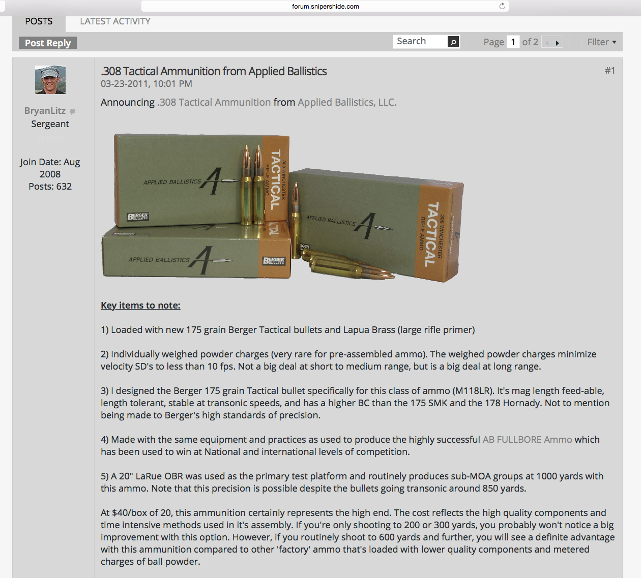

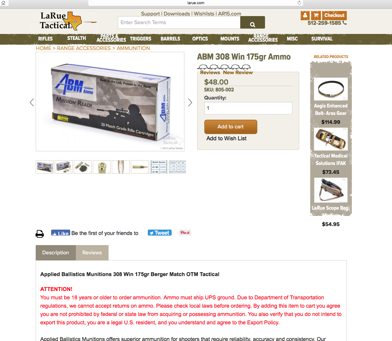

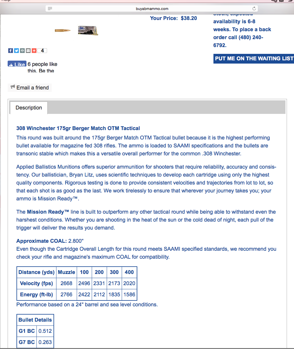

I don't reload so when I need consistent 7.62 ammo its expensive!! Just purchased several hundred rounds of Applied Ballistics sourced from LaRue.....have used it before. Single digit MV variation is important when I shoot a 16" OBR at 800 -900 meters. Do you think you could spec similar ammo with at a significantly lower price point ? Thanks.
