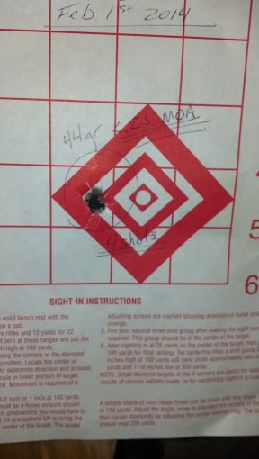

I don't shoot FTR, but I use LC for 80% of my reloaded .308. Below are the results... Just gotta pay close attention to what your doing! Quality in = Quality out!
FYI, this is out of a Savage 10FCP-K. 4 shots @ 100yds. It'll do this regularly if I do my part. You don't need Lapua for extreme accuracy, though it does make things easier...

I see the first hole, but my computer is not showing the other three.
