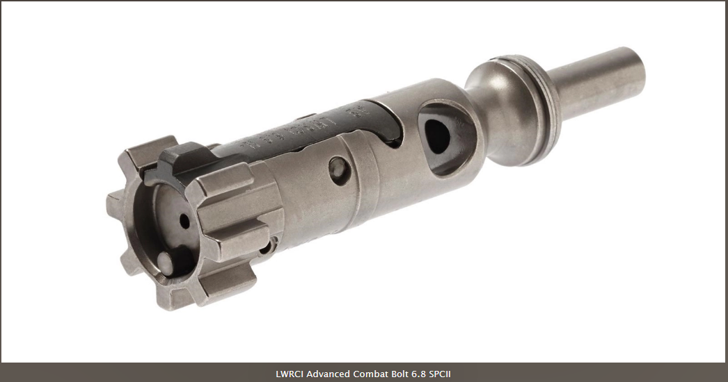

FWIW - I decided to give the LWRC bolt shown below a go on a .224 Valkyrie build. Cant speak to it's longevity, but looks to have good potential.
Fits standard mill spec carriers. $129 when on sale.
From an engineering standpoint I agree with all the changes they made. It's similar to the LMT, but not a copy. From what I have found both this design & LMT's date back to 2003 ish with a lot of updating since.

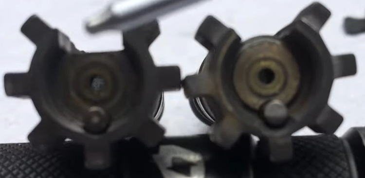

BCM on left / LWRC on right. Notice extractor lugs & bolt face are fully supported on LWRC.
