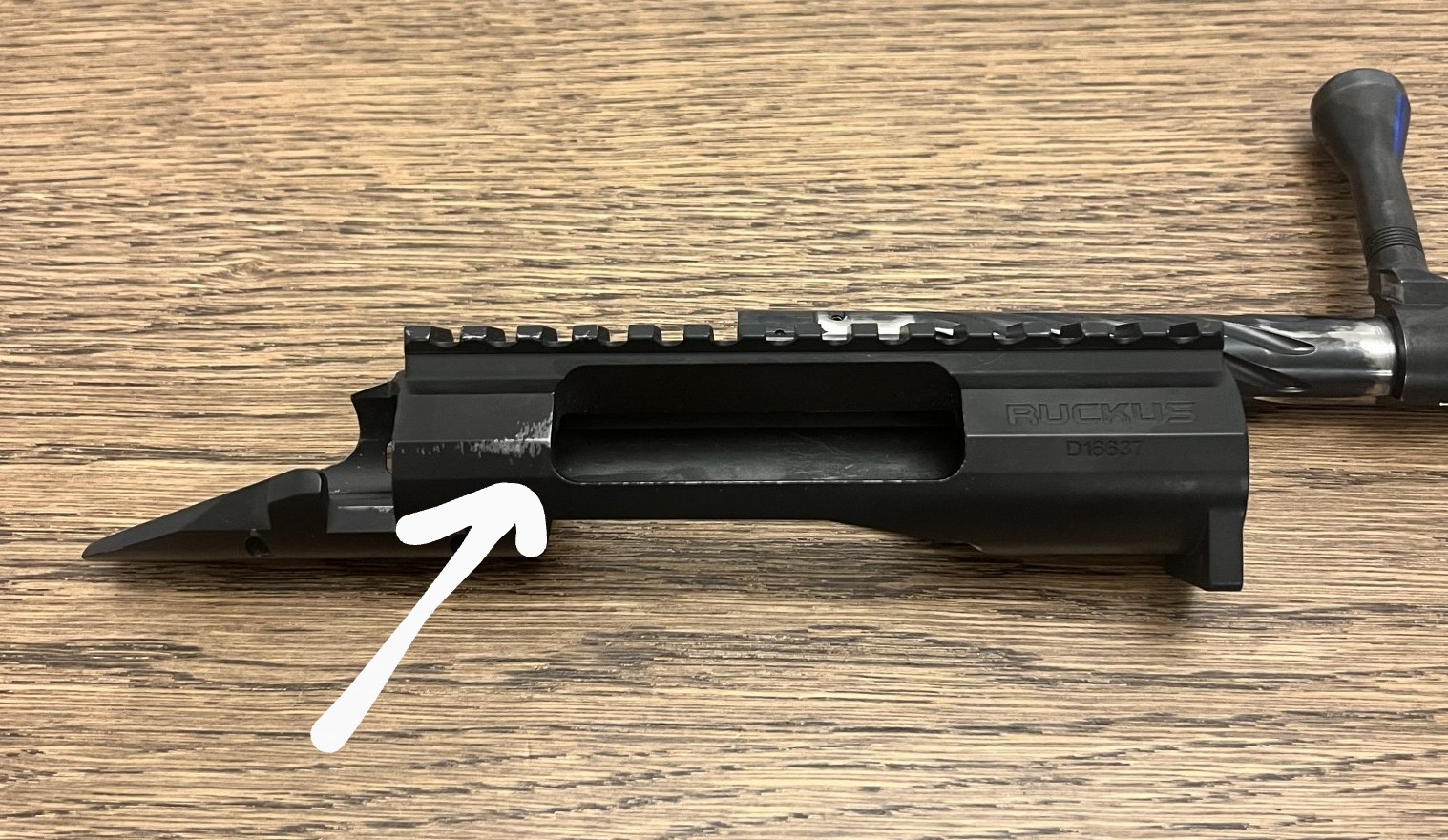

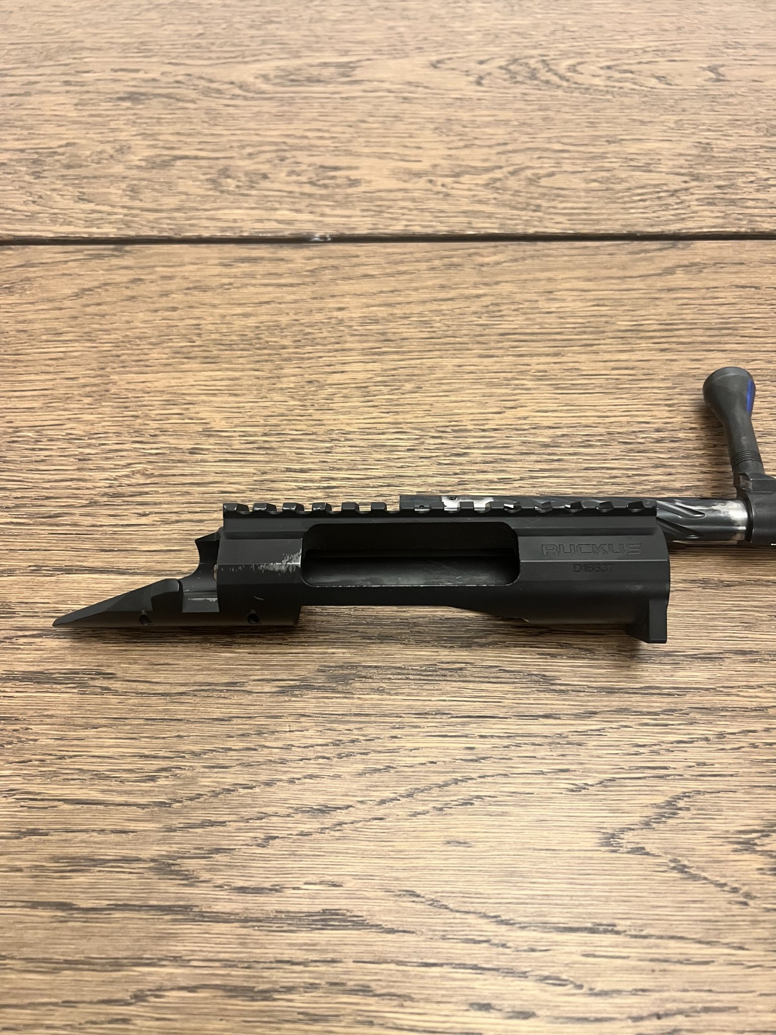

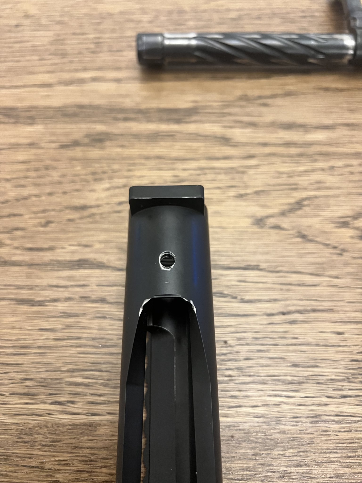

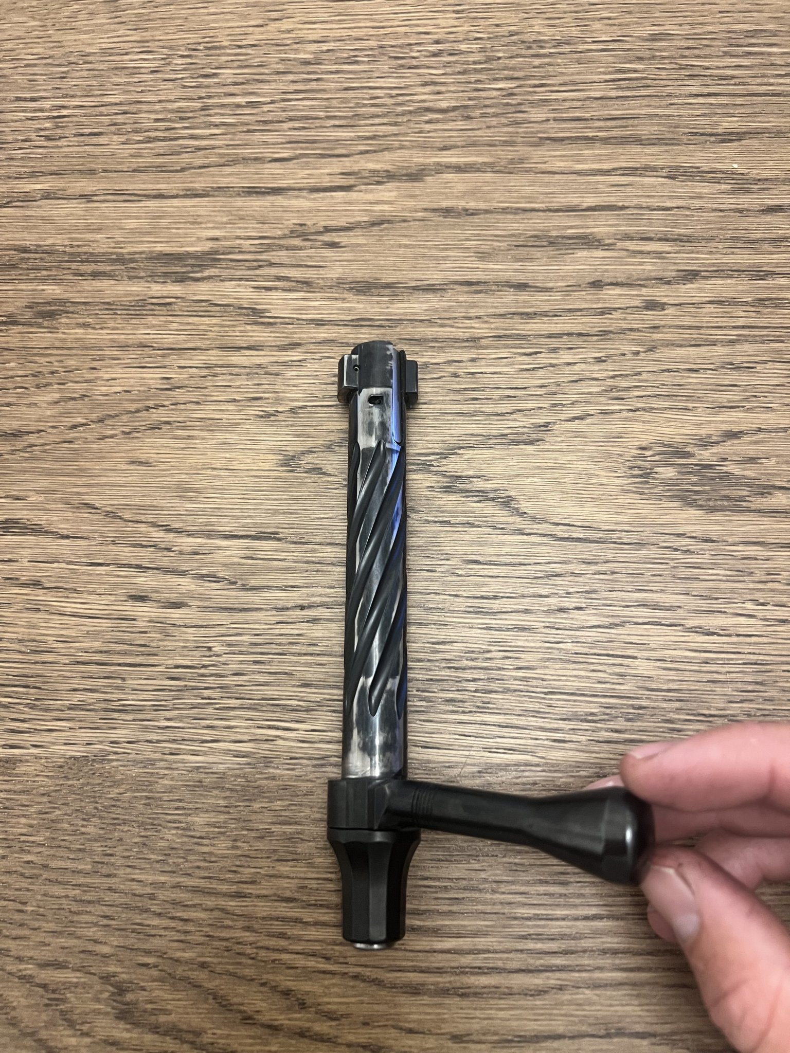

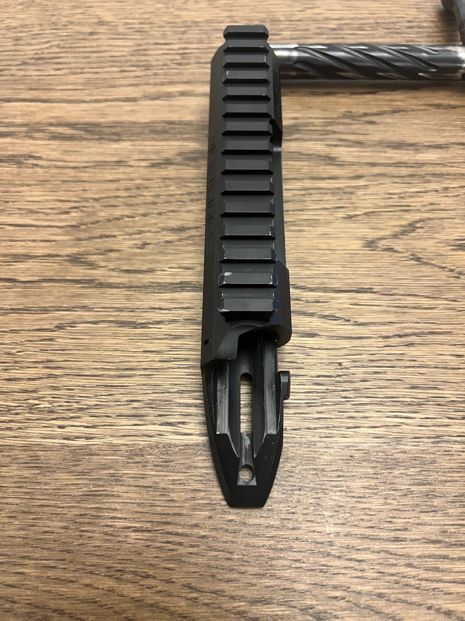

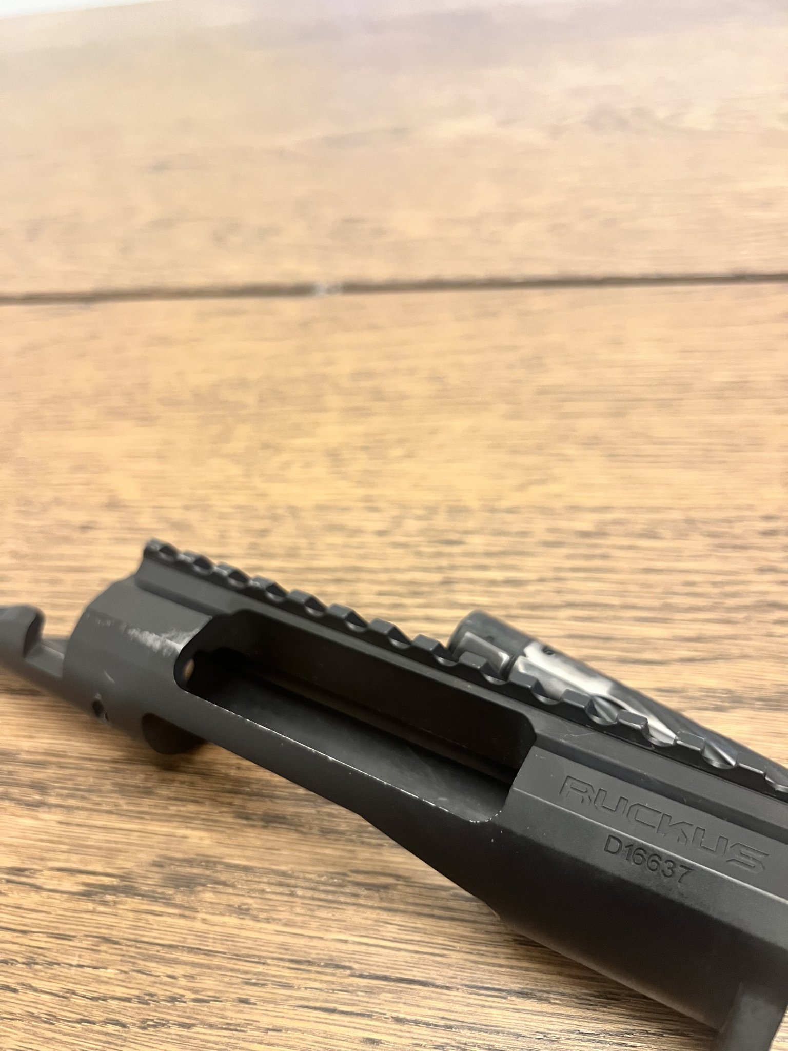

Looking for some input here. Purchased a BA from a member here. Was told specificlally “350 rounds on barrel and receiver”. This is what I received today.
I take good care of my shit so maybe this is just what 350 rounds of abuse looks like. But what do yall think? Anyone have a receiver that looks like this after 350 rounds?

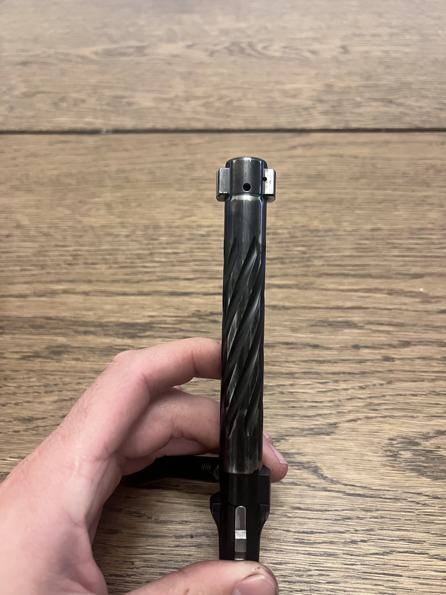

Nitride is chipping in several places. Bolt stop also has excessive play in it.

What is excessive? And how and what are you measuring it against? Looks like it could be 350rds fired, with a bunch of dry firing.
To me, it seems the nitride has chipped/worn more than I would expect. And more than I’ve seen on my receivers with the same round count. Both another Rukus and a TL3
Those marks are normal on a well used action from the cases hitting the receiver; it happens on virtually every bolt action.
Are you sure that is nitride?
It could be Cerakote or paint, which would wear a lot faster.
The action looks like some of my customers actions which have had several barrels shot out on them and which I've barreled multiple times.
Are you certain that the coating is nitride?

I have a nitrided Lone Peak action with 3x that many rounds and the only place that shows a little wear is on the bolt lugs.
It looks like Cerakote to me, but still more than 350 rounds.

Nitride is not a coating, and cannot chip. The surface color can wear away, but the base metal remains nitrided. That receiver appears to have cerakote on it. The bolt looks like it may be nitrided but hard to tell due to the picture quality.
Yeah I understand some brass rash. But at 350 rounds it still should only be that, just brass markings. But this has gone through the coating and down to the steel. Like you said, to me, looks more like a receiver that has seen a couple barrels. Or a poor coating
I'm going to go with air dry Cerakote and they didn't blast the surface. Defiance Actions are tumbled to near mirror finish. The coating would probably wear that quick in 350 if that's the case.

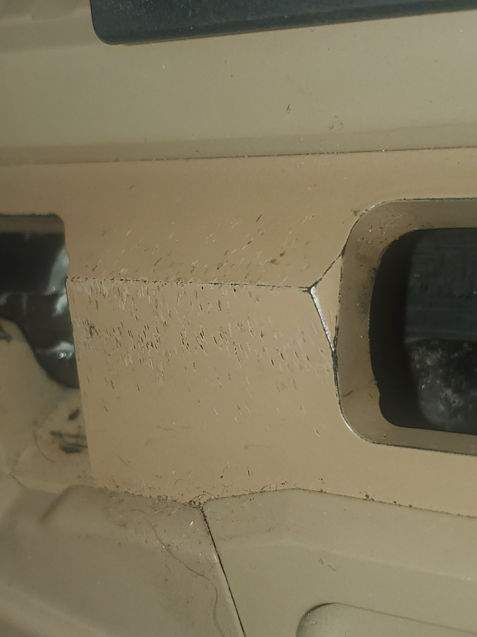

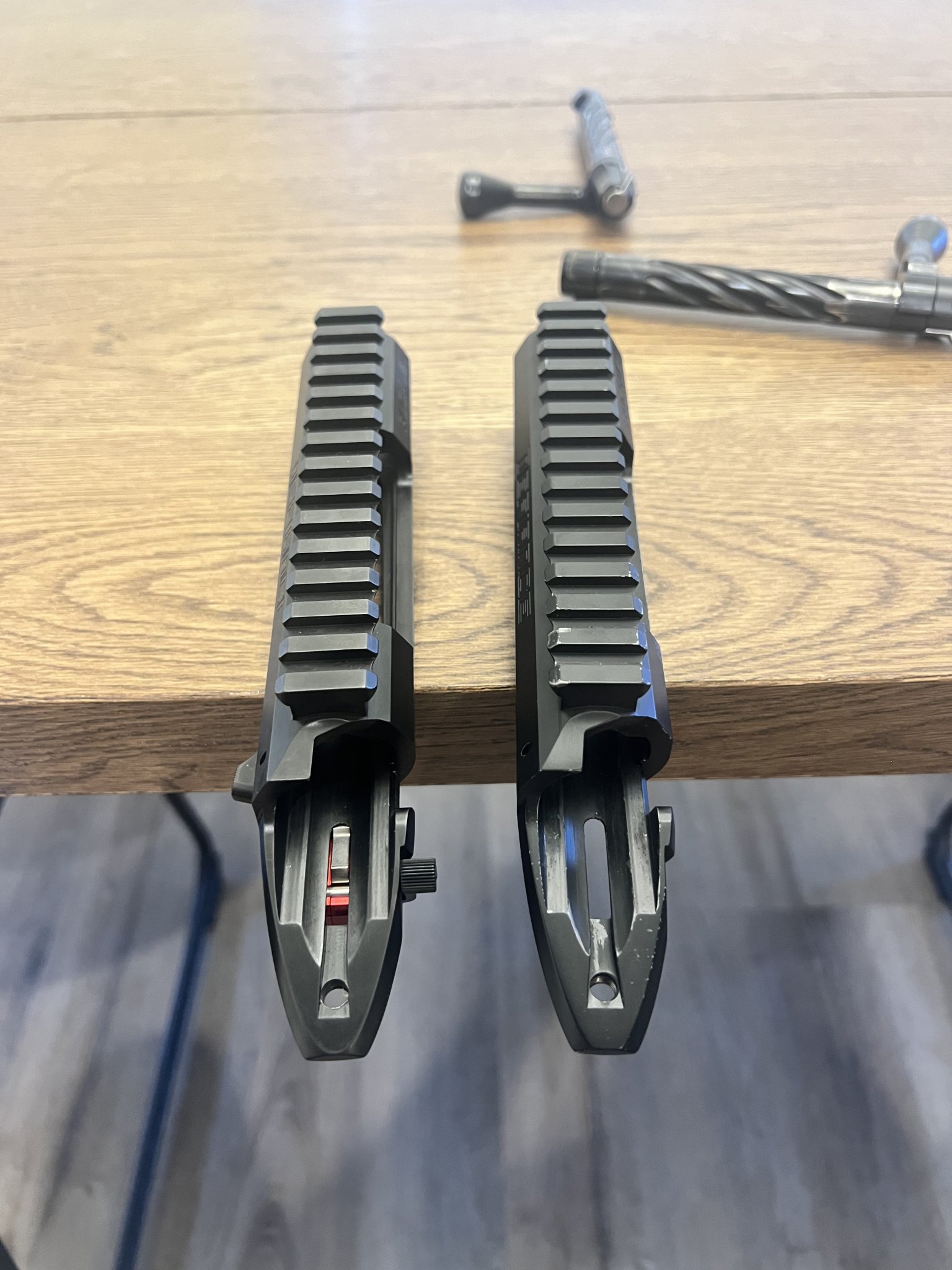

Here’s a picture of the tang area next to my current Rukus. You can really see the flaking of whatever material it is. A lot of the edges have material coming off. But if you zoom in you can see it.

I get it looks worn, but if it functions perfectly it IS only cosmetic. I have several actions that look worn like that and slide like glass. Often they get better as they wear if they started tight.
I get where you’re coming from. But you gotta disclose this when selling. Period.
I understand I should have been more thorough in asking. But if something looks like this, it needs to be shown or told to the buyer. As you can see, most would agree with me. Shit doesn’t look like this after 350 rounds.
The bolt stop isn’t only cosmetic. Nor is a magwell with burs from a magazine. And neither is corrosion on a cocking piece. So there is both cosmetic and actual wear on metal.

The "flat" or "matte" spots inside the lug raceways are what over application of oven cure Cerakote look like. It's also what Duracoat starts to look like after a lot of wear, which is what I'm leaning towards, because some of that just doesn't look like how Cerakote wears to me. I've only had 1 Duracoated BA & it wore in exactly like that... but it took a lot more than 350 rounds & still didn't look even half that bad

I agree that looks like cerakote. My tl3 that I bought on here used with 5000 rounds that I’ve put on it plus countless dry fires, has no exterior surface that looks like that. The bolt has almost all the nitride worn off though and it was decently worn when I got it.
Opinion: OP normal, seller is a cunt......
You declare that shit if you're a reasonable person. 350rnds it should look new, not like an improvised hammer. Anyone happy with that shit, likely treats their stuff like the seller and thats cool, it's yours...... not cool to imply otherwise when selling.
If it was a Deviant instead of a Ruckus, I would try to buy it and eliminate your pain.
100% a shitty cerakote job.
