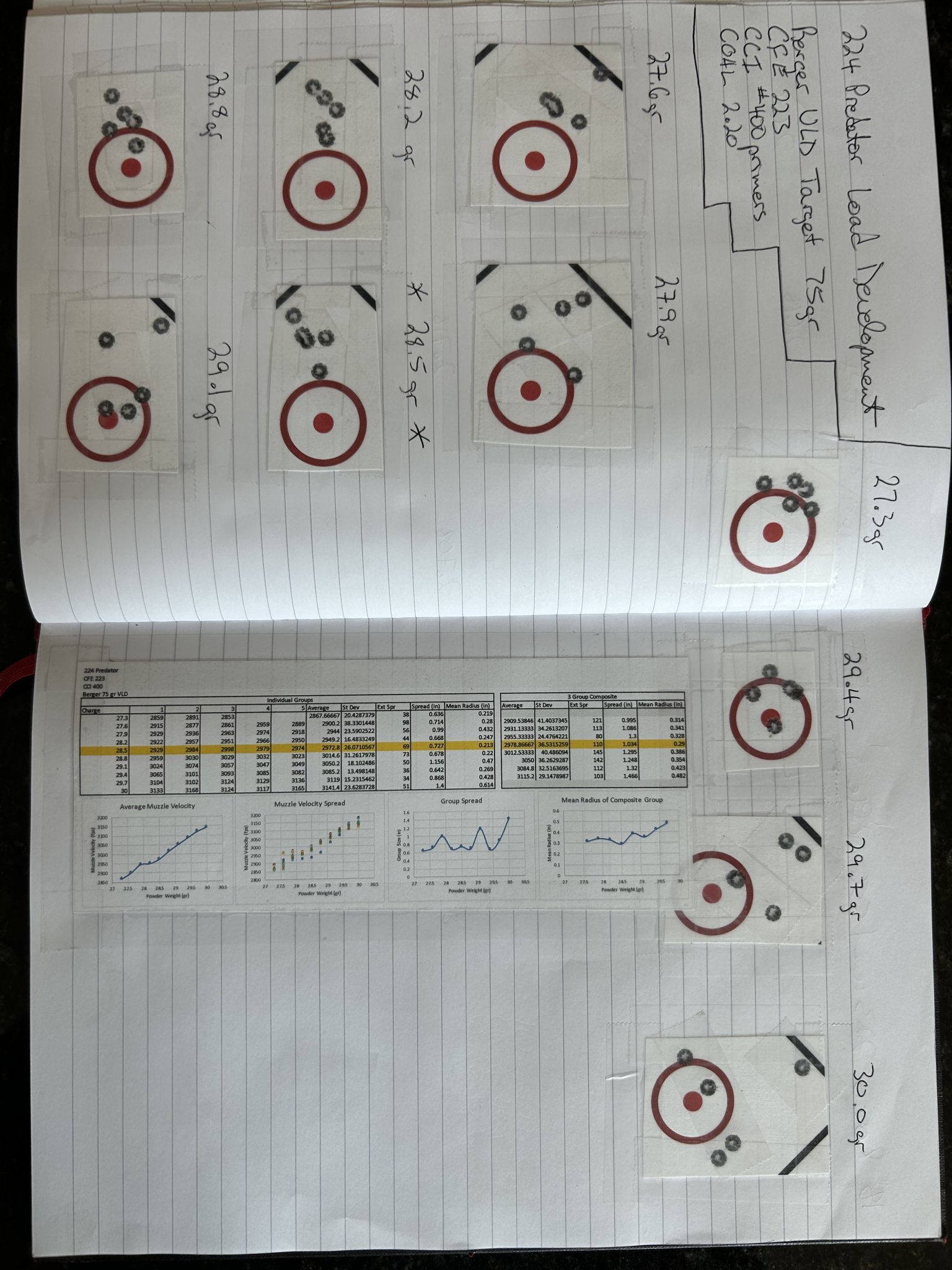

Here’s what I would do…
Load 5 cartridges of your “pet load,” trickling the powder to the desired weight. Load 5 more at 0.3 grains less, and another at 0.3 grains more. Shoot these at 3 separate targets. Then overlay all of the impacts onto a single point of aim and measure the aggregate group. Also look for a shift in the aggregate group’s average point of impact. If you are happy with the extreme spread of the aggregate group, and the poi isn’t shifting around, you’re good to go.
For example…

This is a really good idea. I am going to do this. 500 yards should give some good information.
