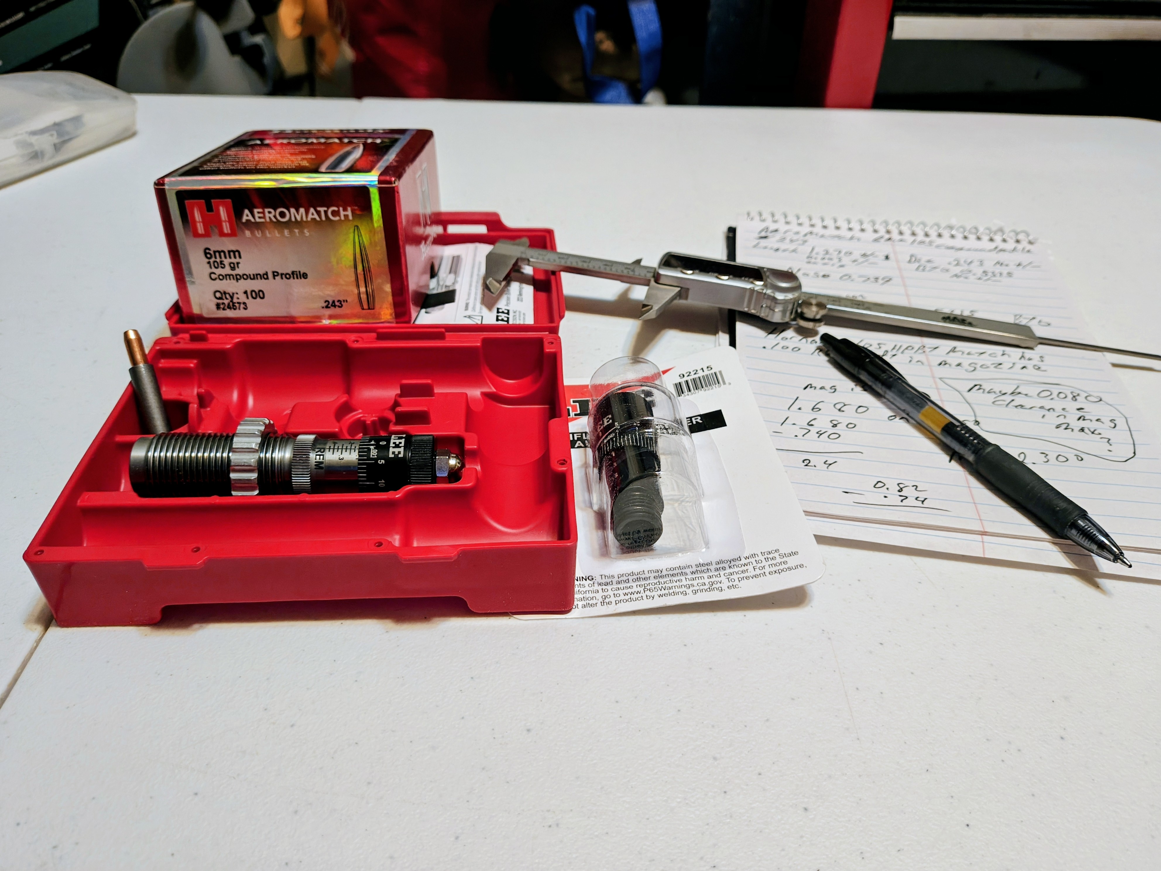

Aimsmall55 Gunny Sergeant Full Member Minuteman Oct 23, 2010 2,715 82 41 Madison, Ms Today at 1:14 PM #1 Today at 1:14 PM #1 Recently purchased a PWS 6 arc upper. New to the gas gun reloading and want to work my brass as little as possible. I figured a 5/1000” bump just to make sure everything cycles in the gun. Does this sound about right??
kilizyrag Sergeant of the Hide Full Member Minuteman Nov 24, 2022 130 184 Colorado Today at 2:05 PM #2 Today at 2:05 PM #2 If you can bump consistently at .0005" go for it. .002-.003 should be about right. Reactions: lash
lash Swamp Rat Full Member Minuteman Sep 28, 2012 14,370 34,321 66 Central Florida Today at 2:10 PM #3 Today at 2:10 PM #3 kilizyrag said: If you can bump consistently at .0005" go for it. .002-.003 should be about right. Click to expand... Uhm, 0.0005” is 5 ten-thousandths, he was asking about 0.005” which is 5 thousandths.
padom SuperMod Staff member Moderator Supporter Full Member Minuteman Mar 13, 2013 13,743 10,882 Southeastern, Pennsylvania Today at 2:10 PM #4 Today at 2:10 PM #4 .003 bump is pretty standard in a gas gun Reactions: Aimsmall55 and lash
kilizyrag Sergeant of the Hide Full Member Minuteman Nov 24, 2022 130 184 Colorado Today at 2:15 PM #5 Today at 2:15 PM #5 lash said: Uhm, 0.0005” is 5 ten-thousandths, he was asking about 0.005” which is 5 thousandths. Click to expand... My bad! Reactions: lash
lash Swamp Rat Full Member Minuteman Sep 28, 2012 14,370 34,321 66 Central Florida Today at 2:25 PM #6 Today at 2:25 PM #6 kilizyrag said: My bad! Click to expand... No harm, no foul.
Aimsmall55 Gunny Sergeant Full Member Minuteman Oct 23, 2010 2,715 82 41 Madison, Ms 12 minutes ago #7 12 minutes ago #7 Thanks guys. I appreciate the feedback. Cheers
