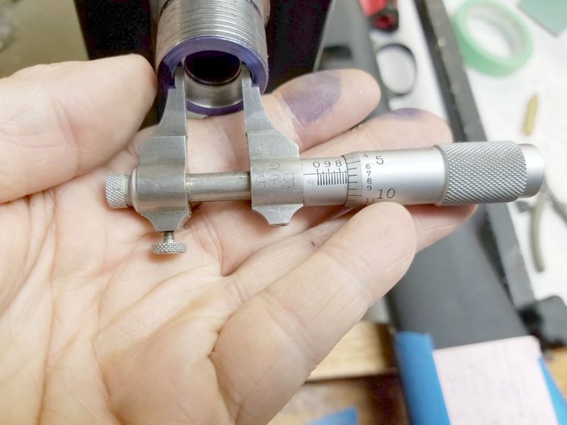

Gunsmithing How much do you open barrel breech for PTG R700 magnum bolt for the AR15 type extractor?
I usually cut the counterbore .720", usually .715" will work but just to be sure I open them up to .720" with a boring bar.
I was calculating and measuring and thought 0.717" was going to work. It did not. I just kept boring out 0.002" at a time until it worked at 0.731".
