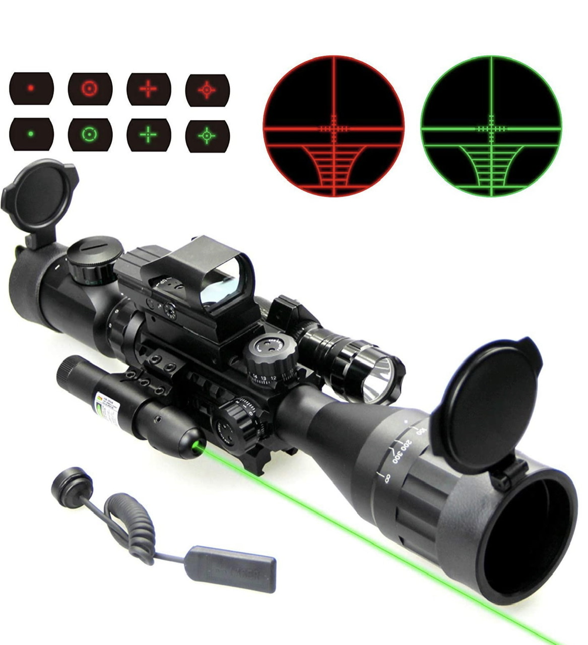

    I’ll just leave this here:
    In last year’s coveted “87th Annual World’s Greatest Rifle Scope” competition, this one took the top four spots. Everyone else was vying for 5th place.

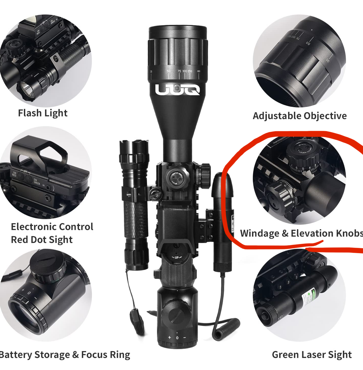

    $550.00
    Don’t fight over it. Lol
    Reactions: carbonbased
    Note that one of the “features” they list is circled above.
    edit: they cheaped out and didn’t even include NV + 4K thermal on this damn POS? Phishaw!
    The placement of the turrets in a visually obstructed position was a strategic design decision.
    No don’t you see you can engage at close range with the red dot and with it being perfectly in front of your turret you’ll be able to dial your elevation to transition to the scope for the bad guys at distance. Such a time saver
    Guys, guys, guys, can’t you see the genius of this design? If the bad guy sneaks up on your overwatch position and attempts to mess with your windage turret (they all want to, everyone knows) the laser will cut his fingers off.
    C’mon fellas, FOCUS!
    Reactions: KeithStone

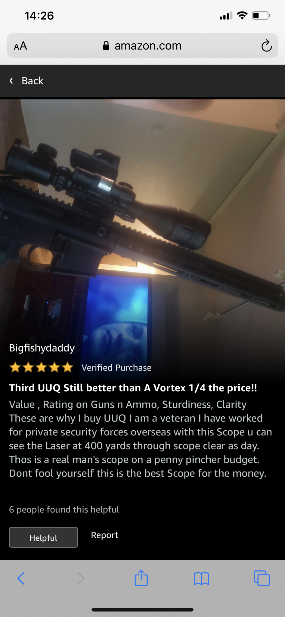

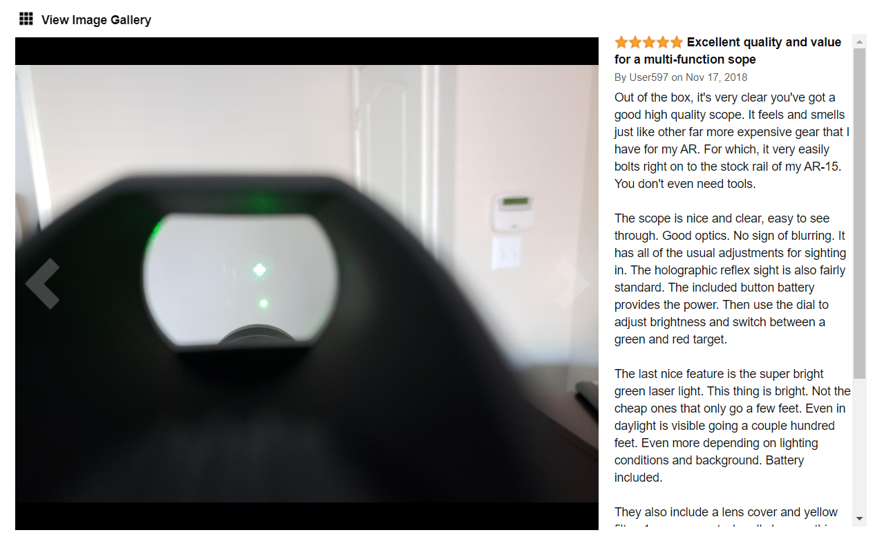

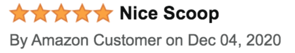

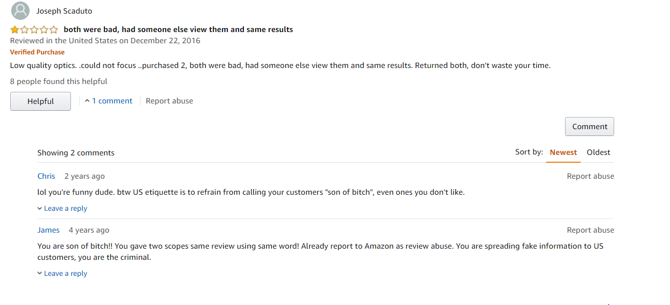

    JESUS SAVE ME I just read some of the “reviews” of the UUQ scope. As a species, we are .1 mil above water apes.
