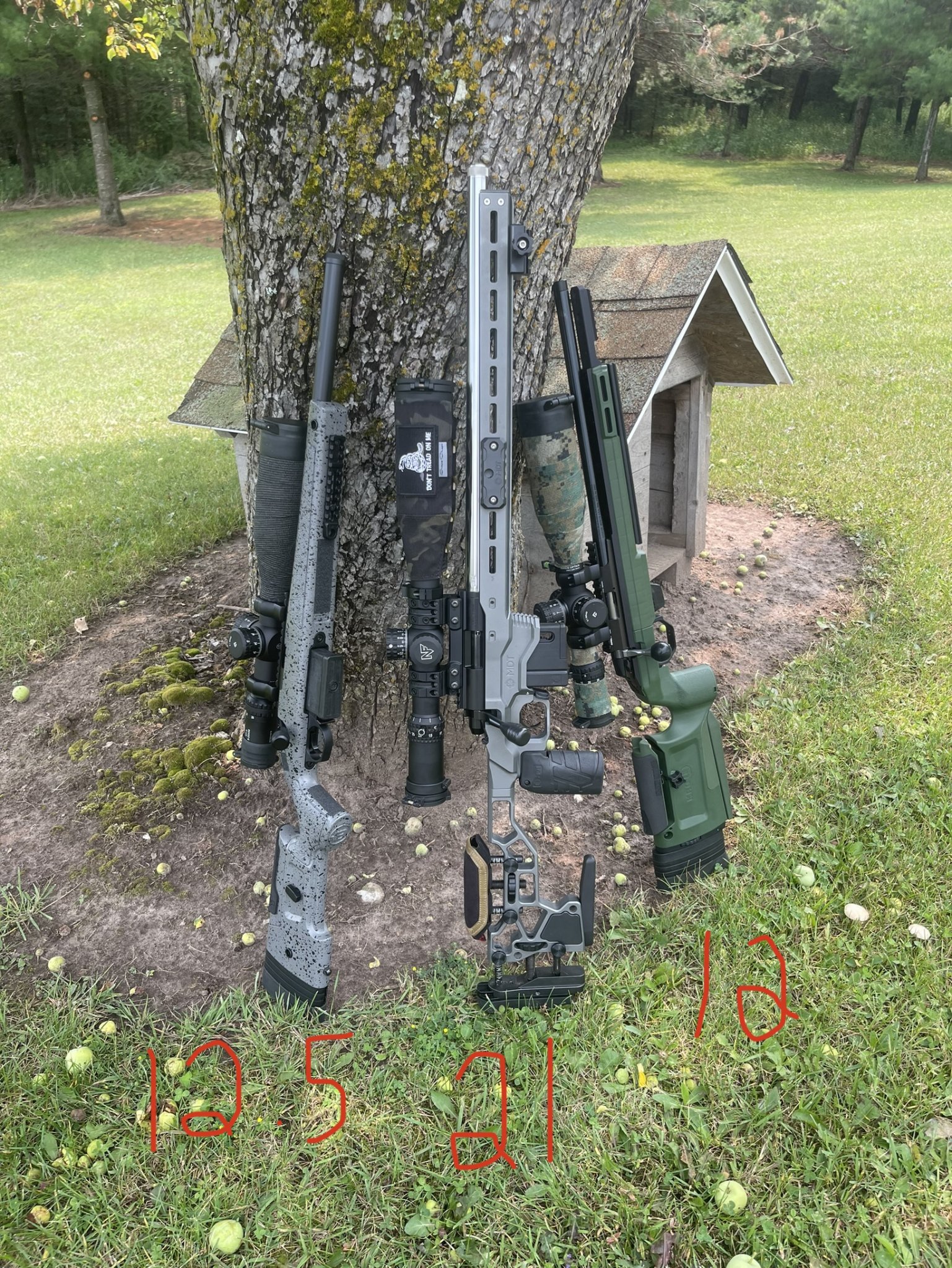

I like chassis in general. Especially compared to cheap plastic stocks like the T1X comes with.
I have a 15.5” LOP. So almost no factory stocks feel great for LOP. About every chassis or stock I run is maxed out
Couple that with ability to add rails, accessories, weight etc and it becomes an easy choice. Cost aside of course. You also don’t get the forend flex like a cheap stock has. As well as aluminum bedding blocks etc
There have been people who put the T1X in a chassis then moved back to original stock. Stating the weight savings and for their use they couldn’t see the accuracy difference between the two
My B14R has a decent factory stock. Warming up to it a lot
T1X KRG Bravo
B14R factory
Vudoo 360/MDT ACC
Weights listed below rifles
