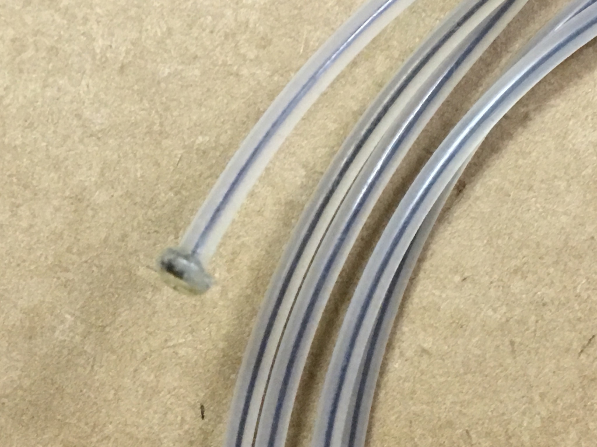

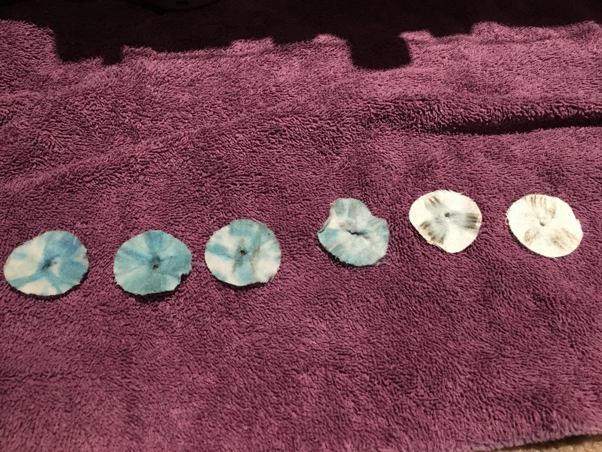

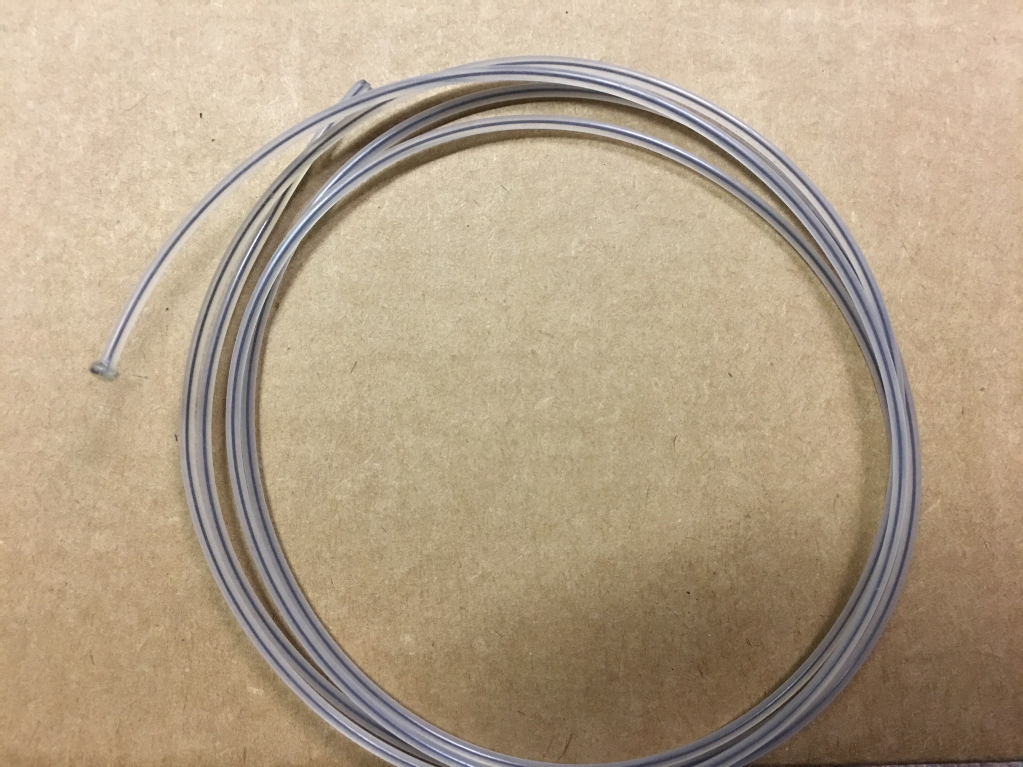

Here’s what I use on my precision barrels. It’s just a piece of weed eater line that I’ve melted one end to make a button to hold the patch. I poke a hole through the middle of the patch, slide it on the line, feed it through the bore, wet the patch, and pull it it the muzzle end. Always the same direction. I’ll scrub my AR barrels, pistol barrels, or shotgun barrels occasionally, but I’m a po mo fo, and I can’t afford to damage a $5-600 barrel. I use my weed eater line and pull patches through till they come out clean.
Need to keep the plastic covered things clean, so you don't get rock dust etc sticking to it and abrading the bore.
