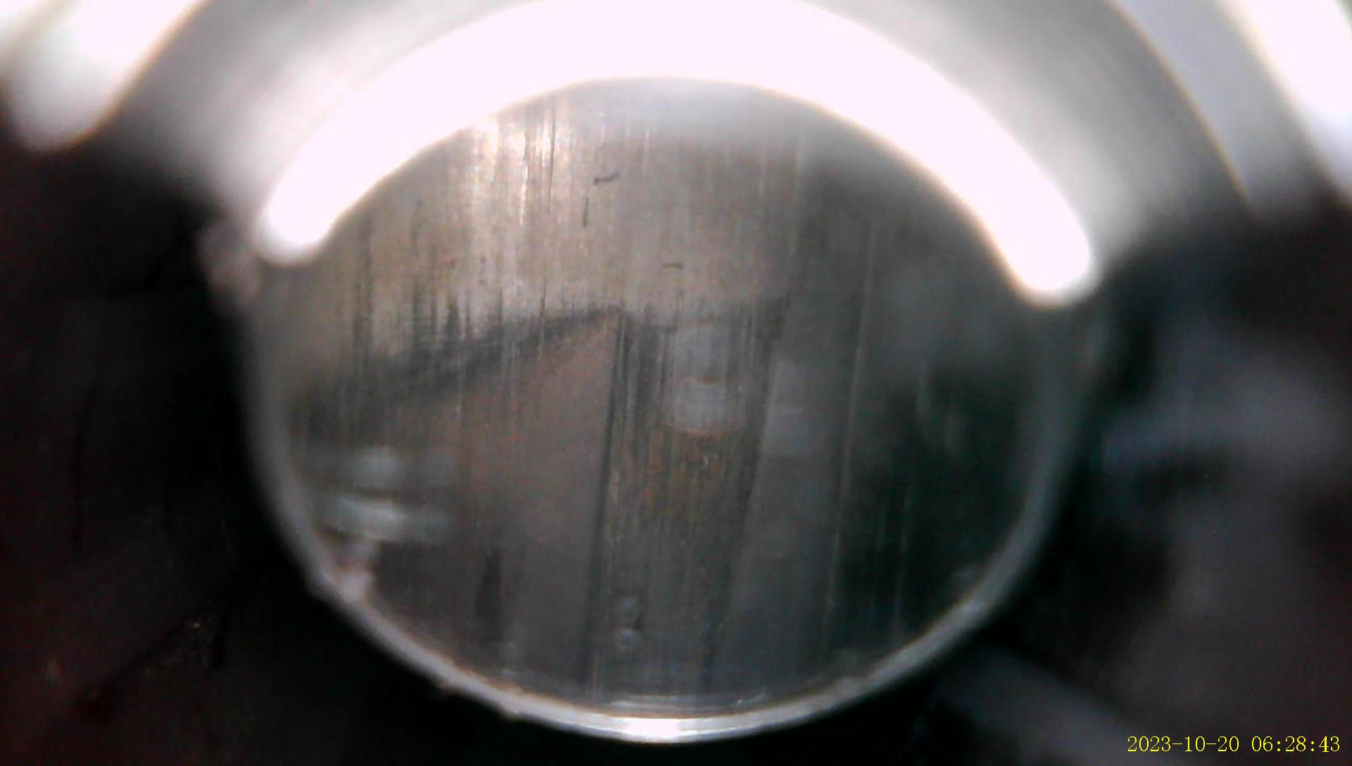

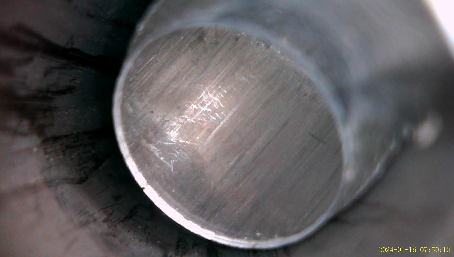

    Hi guys - the rifle is a Rem 700 5R Gen 2 SS in .308 Win (love those succinct and brief names, eh? LOL). I bought this rifle new 5 years ago so not immediately before Rem was broken up. But this is certainly well into the period where the private equity guys fucked that company over royally and was turning out subpar products. It shoots ok for a deer at 200 yards and in but its not a tack driver by any means. Rifle has 1,200 rounds thru it.
    I didn't have a bore scope at the time it was new and then after I did have a scope (mostly to check for state of cleaning on my precision rifles) I never looked into this barrel until recently. And when I did I was shocked to see that about 35-40% of the throat...and a bit beyond...seems to be missing. This is not throat erosion from shooting....the other half of the throat is right with the lands of the lead coming up to the free bore as you would expect. Its just gouged out.
    Questions to the experts:
    1. I'm mostly just wondering how they could have fucked this up this way? if the throat reamer was off center or cocked relative to the bore, then it would have eaten the throat all the way around as the barrel was spun in the lathe. Is this right?
    2. Can the barrel be set back just a small bit and have the chamber extended again and the throat re-cut?
    And ideas?
    Thanks for looking.

    I'd say you need better pictures because it is hard to tell from what you have posted. What borescope did you use?
    Teslong. I have to say having the rifle in the vise, trying to hold the scope in the proper place, and hit the photo button on the scope seemed to require a 3rd arm! haha

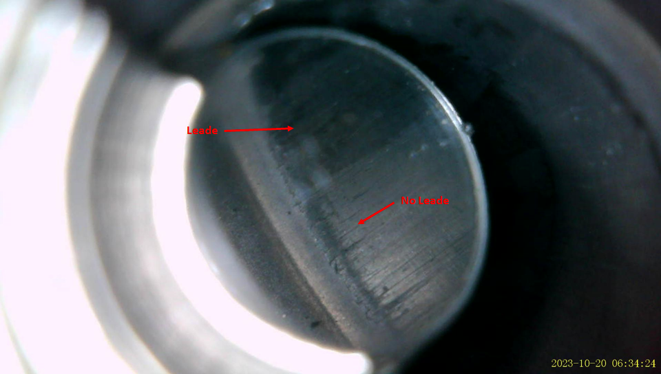

    I actually just received a set of the caliber specific mirrors from Teslong (well, Amazon) but it was after I took these. I'll def get some better pics.
    I think the 2nd of the three pics I posted show it best. The top of the pic is the chamber end...and it shows the free bore...and zippo leade.
    Thanks for the responses guys...I'll post some better pics...well, I hope to get some better pics! haha

    That throat was not (in 95% of cases) cut by an off centre reamer.
    The pilot, be it fixed or live, was waaay undersize. Thats what causes the throat to be hugely off centre like you showed.
    If it shoots, let it ride. If it annoys you, pull it and a 'smith can correct it. Best results are a new tube.

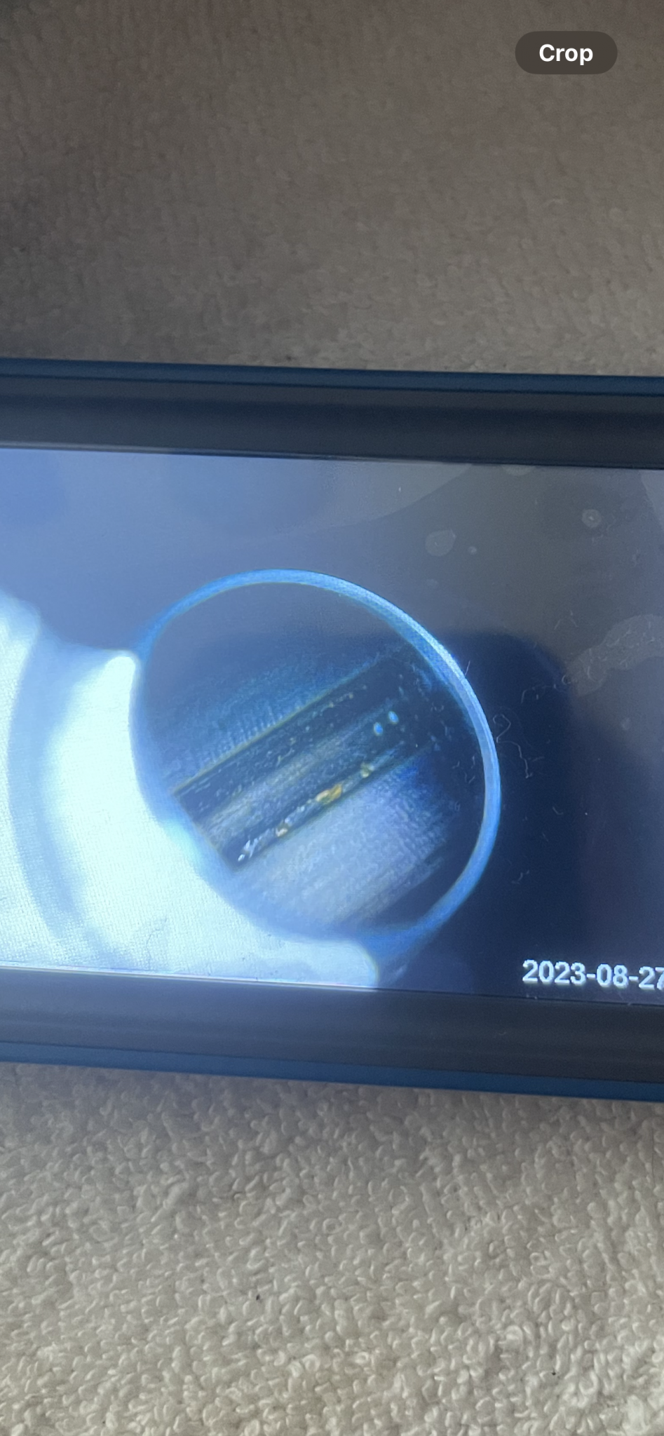

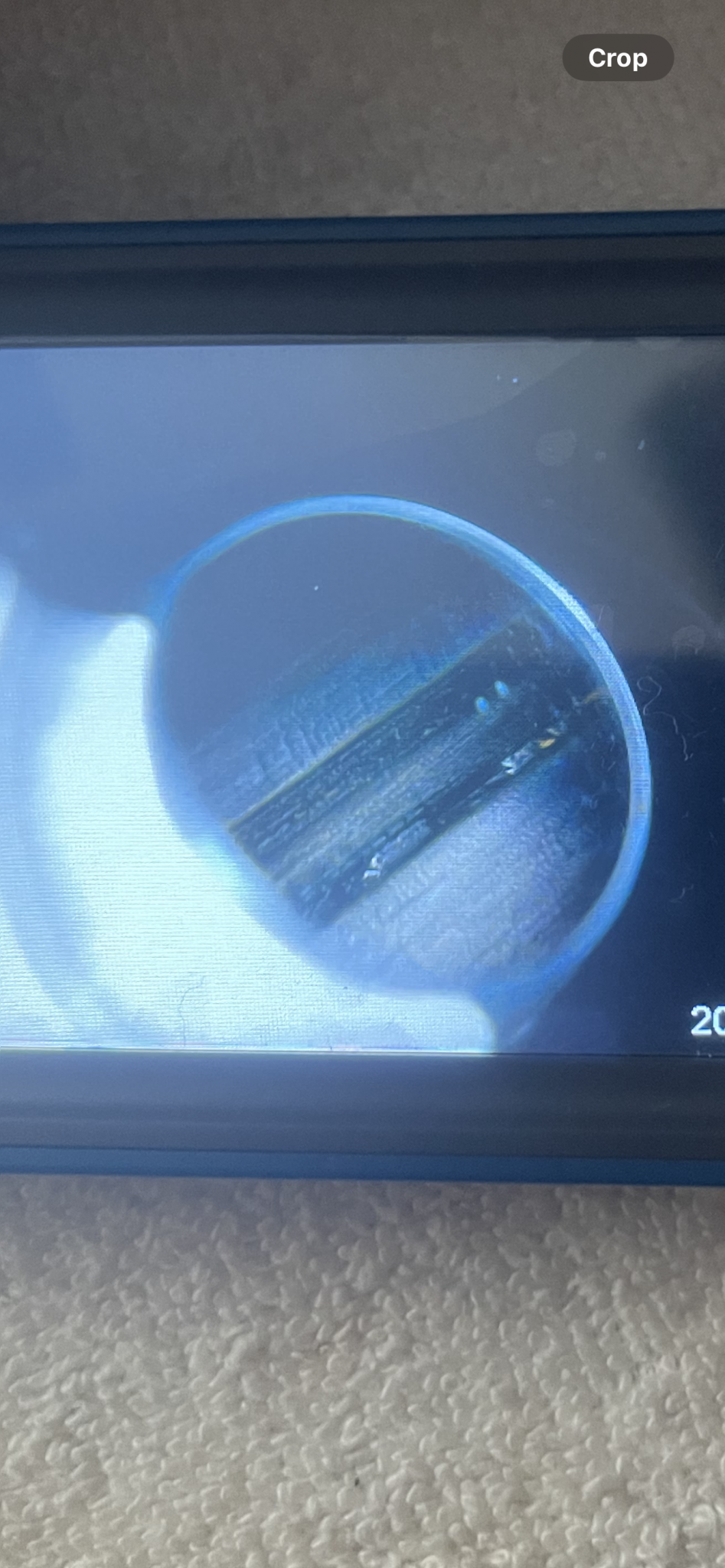

    All - I was asked for better pics, with and without mirror (and pics without from both ends) on the scope, and I did recently receive the 30 cal mirror from Teslong. I will get those done later today and post.

    Reamer wasn't on the same centerline as the bore. It's a production rifle with a crappy production barrel. Why would you expect an $800 barrel on a $1100 rifle?

    In production, often reamers are spun, and barrels stay still. 99% of smiths spin barrels and hold the reamer steady.
    The pilot on reamers is a close fit of thr lands to help centralise the tip as its going in. If not, it can grab one side and "lean" to one side with a bias, cutting off centre.
    The "rigid reaming" method is said to eliminate thia because it reams where it was setup, HOWEVER, its its misaligned to the bore, it will stay misaligned (like production barrels) Floating holders self correct to some extent, which is why smiths use them.

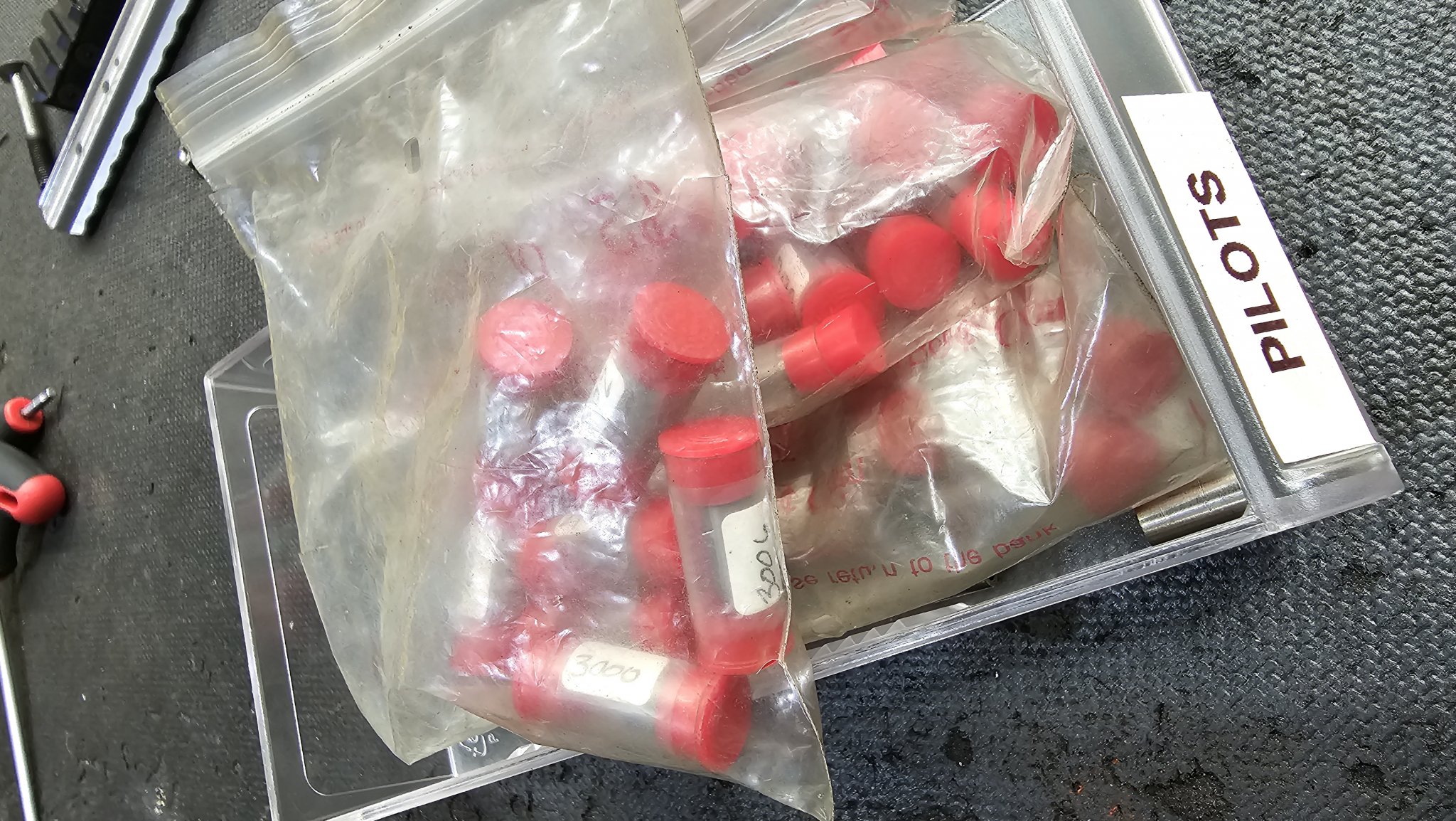

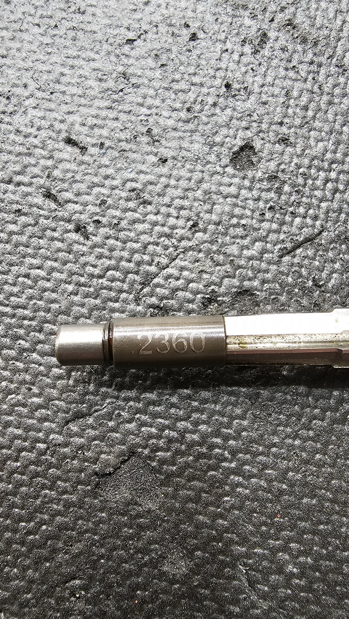

    Often 'smiths have multiple live pilots, to ensure they get the exact land size, so when the reamer goes in, its exactly centre.
    If the drill which made the original hole was blunt, dull, or sharpened off centre, it will drill a slightly bigger hole, and thusly we use pilots to account for that variation.
    If you put this in a barrel with 1200 rounds on it, it will be loose, so id try a few larger ones to make it a better fit.
    Im in Australia, so dont ask me to do it for you !. Happy to answer your questions if you have more.

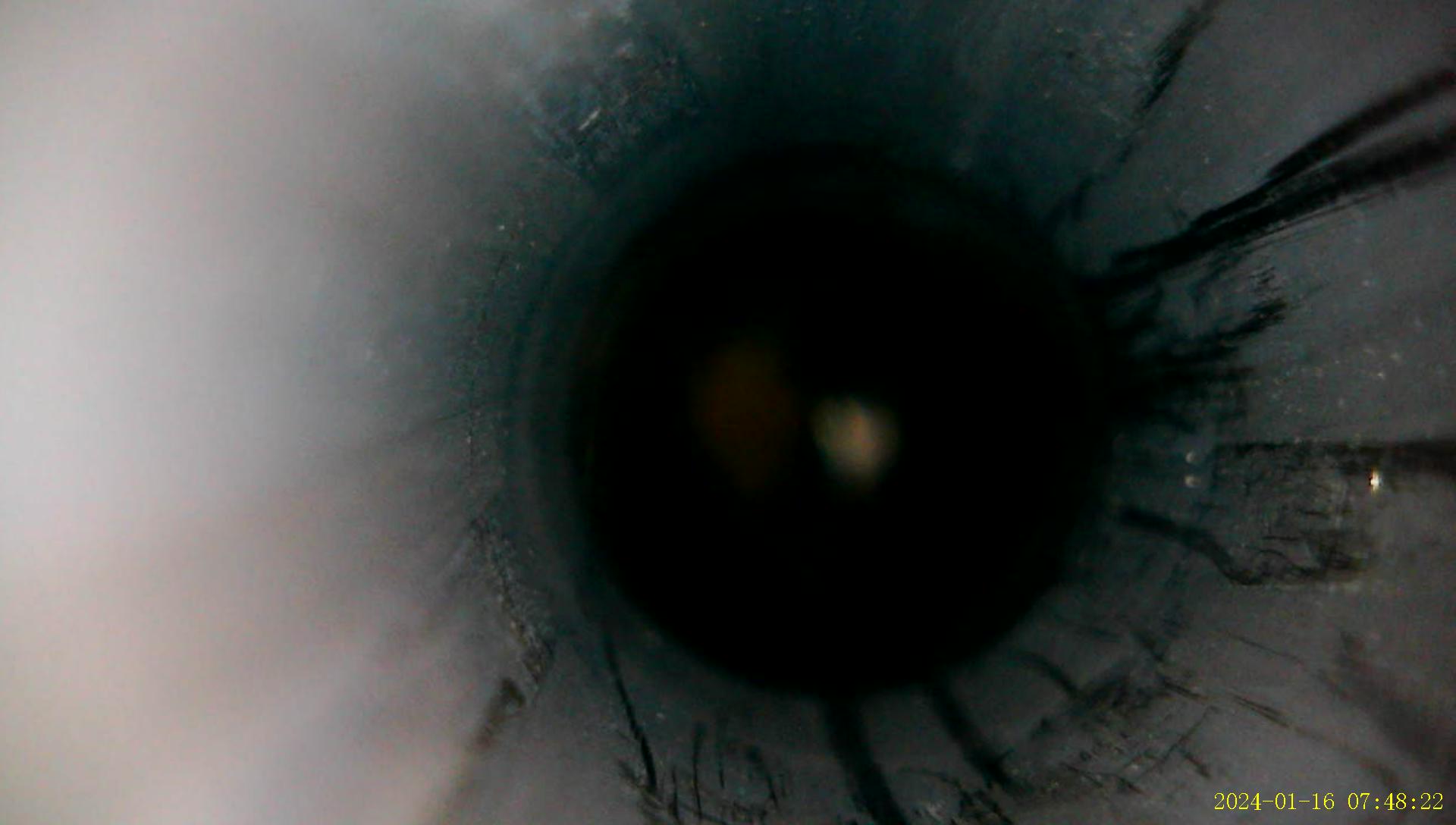

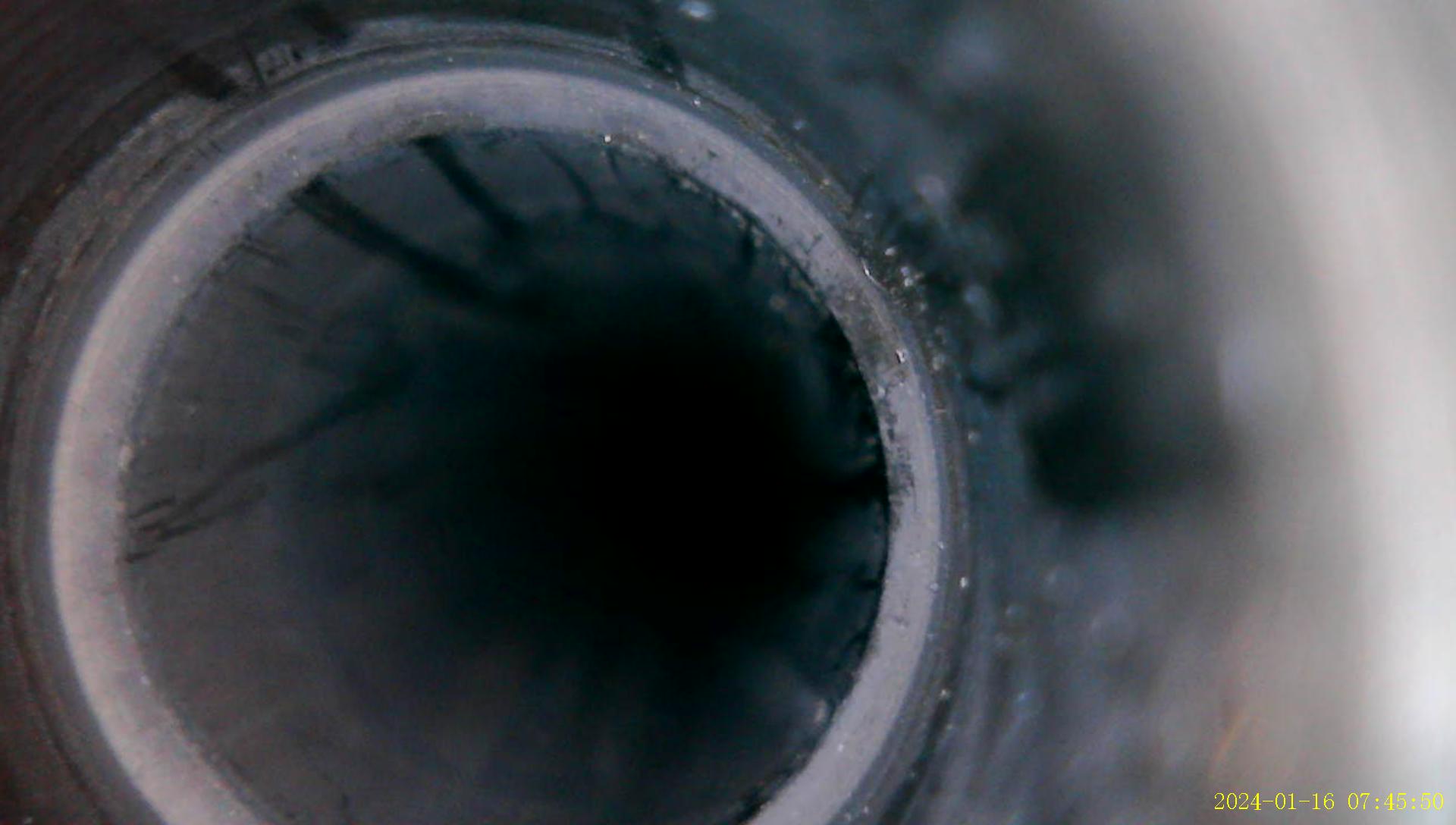

    @6.5SH @Byron - you guys asked for better pics...and 6.5SH asked for pics without the mirror and using the 30 cal Teslong mirror.
    So, I have more rotten pics, shown below! haha I don't know how people get such good pictures...mine have never been very good. And, it probably wouldn't hurt if I cleaned the barrel nice and bright before taking these new pics. LOL
    But, @iceng very nicely answered my main question which was how the hell did that they do that to the leade while reaming a spinning barrel. Answer, they didn't...production barrels are often reamed with a fixed barrel and spinning reamer. That's what I wanted to understand and I thank @iceng for the answer.
    My other question wrt to can the barrel be set back just the length of the throat plus a little and have the chamber extended and a new throat cut. Answer seems to be yes, but probably not cost effective. And I do understand that spending more money on this barrel may be just putting lipstick on a pig and if I do anything about it, a new barrel prob makes the most sense. Or, just leave it as is as its good enough for whitetail to 200 yds.
    I don't think these pics will illuminate much, but I said I'd take them and post it. If it warms up enough to spend some time in the garage where my benches are, I'll clean the barrel up good and see if I can get better pics just for my own peace of mind.
    Pics without the mirror on
    From chamber end
    From muzzle end
    With mirror on...this is the missing leade section...part of it. Chamber it toward upper left

    No one can tell how far off center it is from those images.
    Seems to does not = is.
    The pics aren't that good (which I thought I went to some effort to acknowledge) but no matter how off center it was, it was enough off center to eliminate 35% or so of the leade. Just not really there.

    Here’s a pic of my AI 308 barrel. Approximately 4,000 rounds. Couple chunks missing but she still hammers. Last time on target it held 1/4 moa for 6 shots at 100 yds
    • Wow
    Reactions: Baron23
    My ffl had a Rem 700 arrive that the bolt wouldn’t even fit in. Another had an order of 10 of the same rifles. 2 came without rifling in the barrels. So this really doesn’t look to shabby
    View attachment 8325200View attachment 8325201
    Looks really good to me.
    And wow....zero rifling in two barrels. Wow, wow, wow.

    One thing you can't do though is just run a reamer in and "clean it up" as someone suggested above - there's already been too much material cut away from one side of the throat; a correctly piloted reamer could clean up the other side that didn't get cut enough, but can't put steel back.
    If the drill which made the original hole was blunt, dull, or sharpened off centre, it will drill a slightly bigger hole, and thusly we use pilots to account for that variation.View attachment 8324124
    you should be single point boring your pre drill before you even look at reaming to prevent exactly what you talking bout
