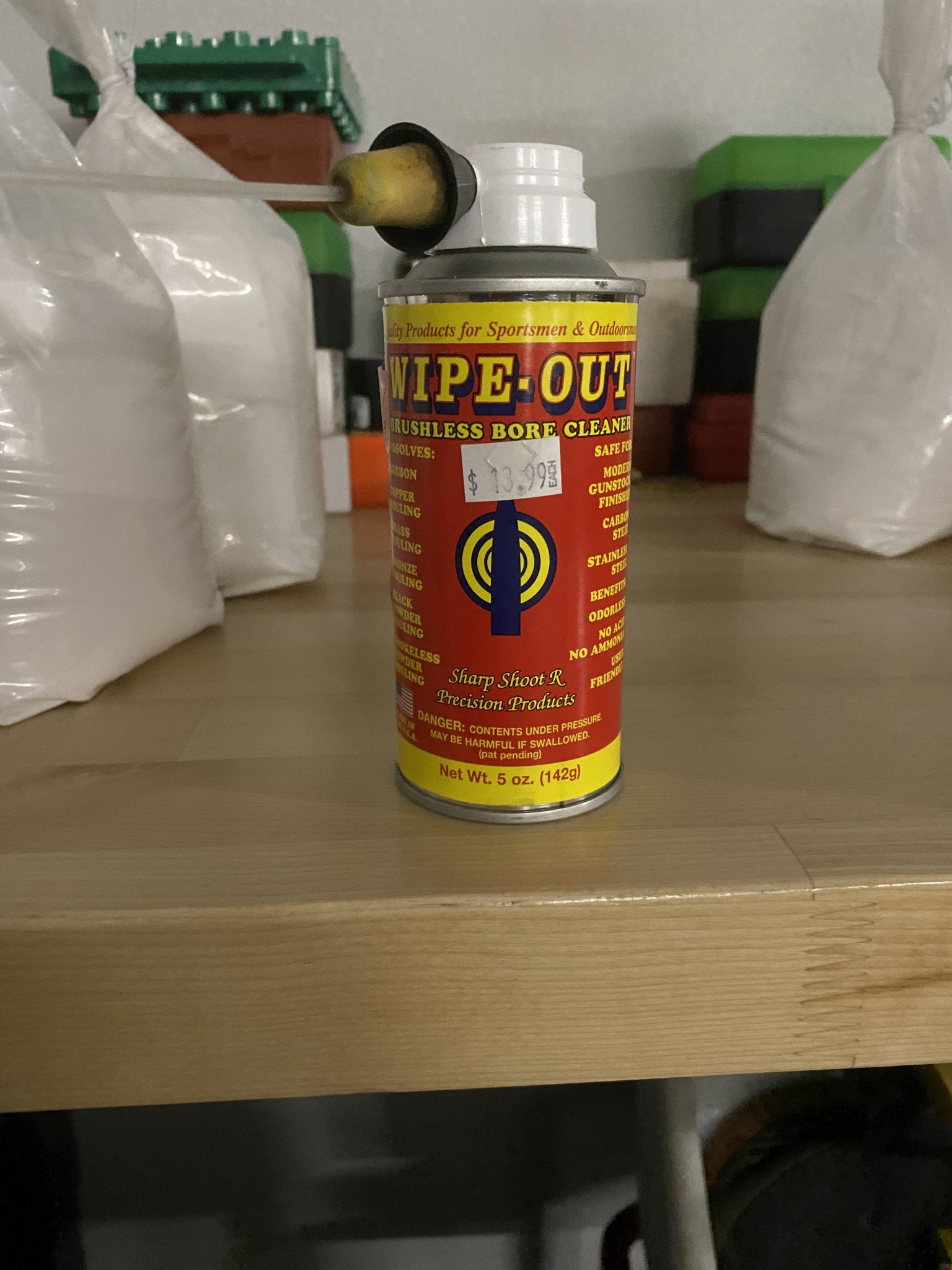

Wipe-Out by Sharp Shoot R’ Precision Products is all you need for copper and powder fouling. Doesn’t hurt your barrel. No scrubbing, no bs. It works and can leave it in your barrel for 24hrs. No harsh chemicals needed. It is the shit.
