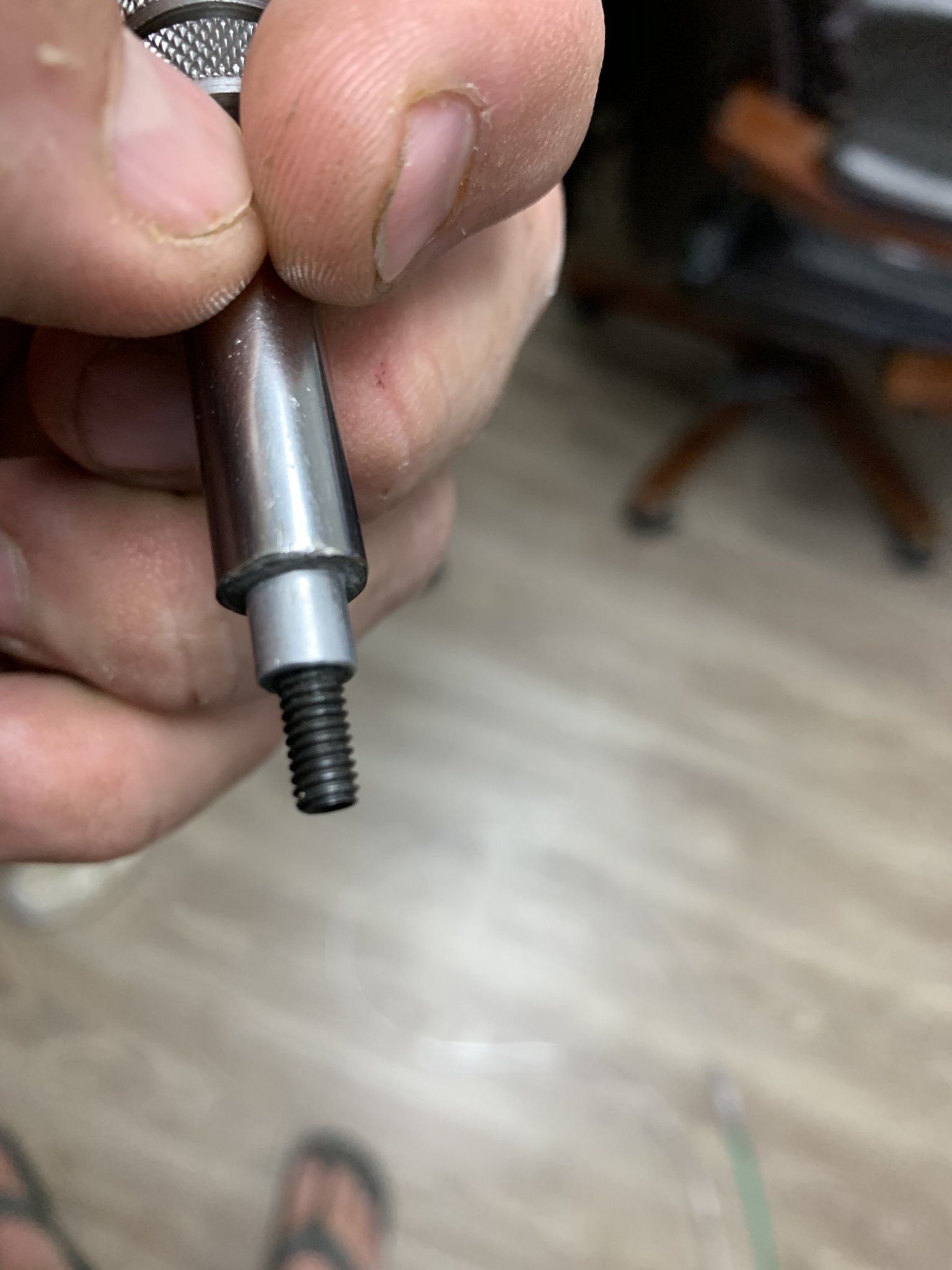

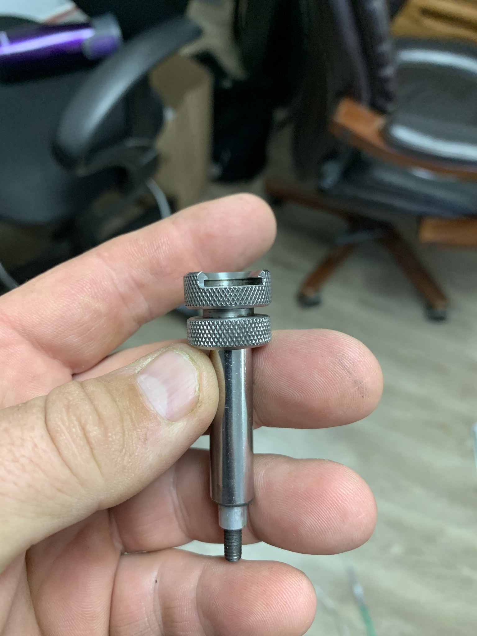

I took a 1/4” magnetic drill extension, pulled the hex end out and epoxied a aluminum 8/32 insert in place of the hex with a 8/32” set screw epoxied into the insert. This extensions stays in the prep center. On the other end of the insert I use the Lee lock stud case holders to hold the case.
The lee studs just pull off and drops onto the insert I built without stopping the prep center and released the case with a 1/4 turn.
