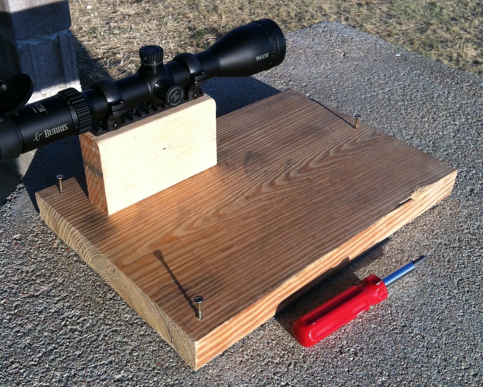

I made a fixture which held the scope and allowed me to dial the turrets. If it wasn't steady enough I put some sand bags on the platform.
