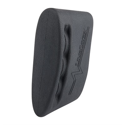

When a shooter loads the bipod, he's doing what you describe in #3 ?
Also, what do you think of "Limb-Savers" ? That would be your #1 above while being in-line with the rifle.
Usefull or a gimmick ?
Great thread (y)
I have one that I had used to increaseLOP on another rifle. I might give it a try since there is no modifications required.

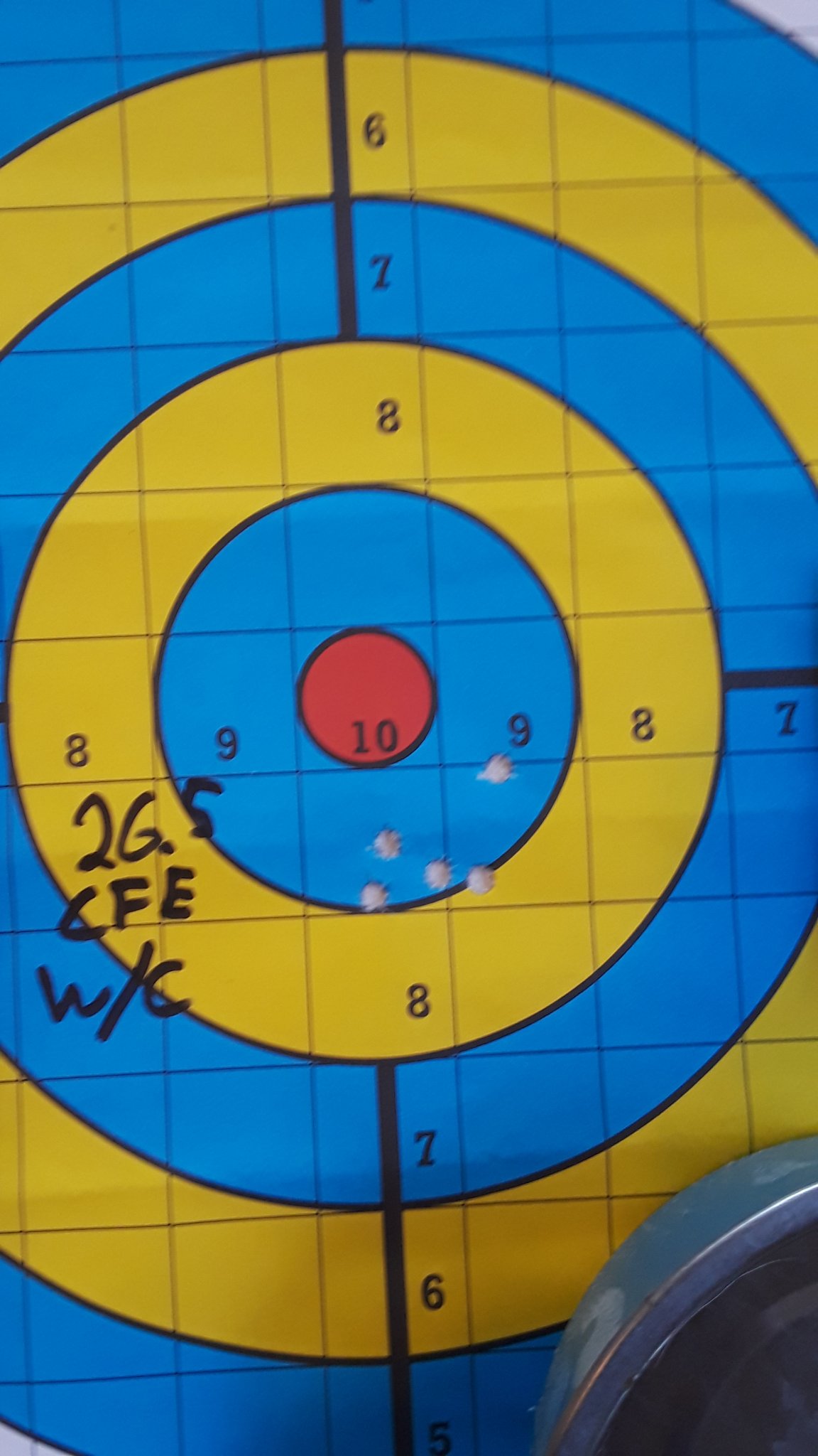

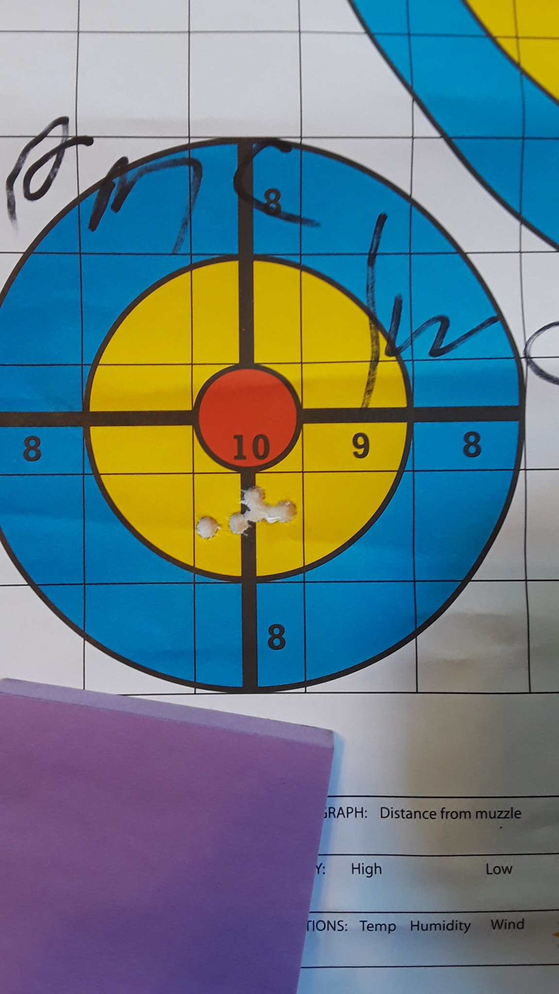

Magpul ctr type stocks give me hell by sliding down the rear bag / rest.
I made a rest to mitigate that but version 1 tips back.
My front rest is working well, steady no bounce, light.
Need to attach a slick bottom surface as it is too grippy.
This is for bench rest load testing and have a lot of ar's in the family
all with the same ctr stocks and upgrading them all is not happening.
I'm getting close, if i can just get a good rear rest would help.
Last trip out I forgot to add a sixth round but was decent.
