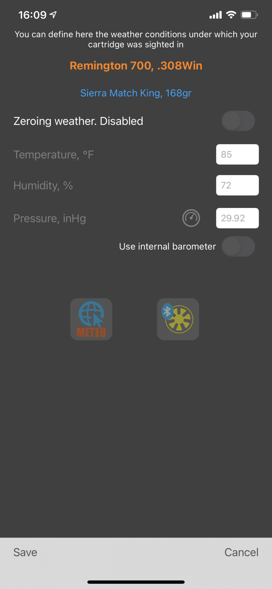

Downloaded strelok pro this week to play with and I can’t figure out how to enable the zero weather? Can anyone help?

if u zero at 100 it doesnt matter but if you tap below where it shows the rifle states

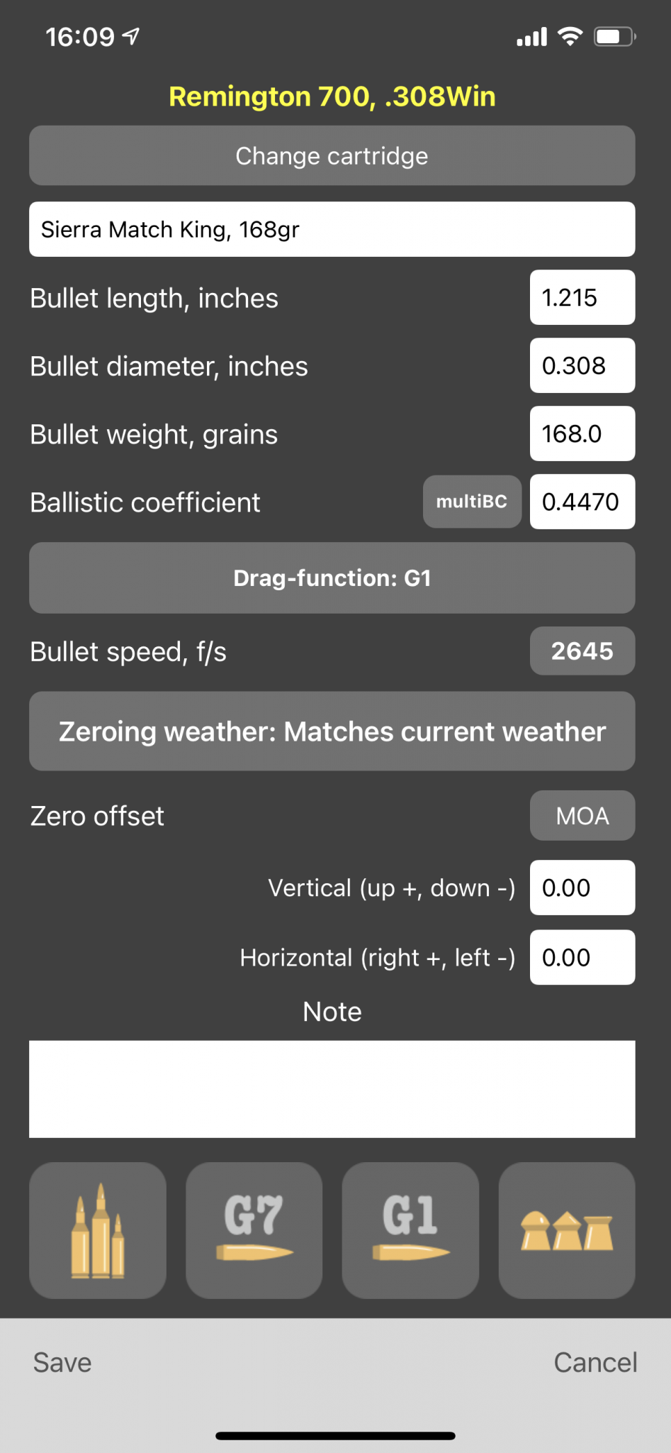

Then tap in the middle where it says zero matches current weather you can change it

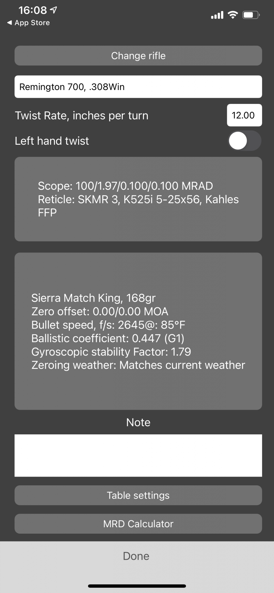

In your ammo profile about halfway down you'll see it. TD is right it doesn't matter at 100 but if you zero and it's hotter than the devil's backside then you go hunting or shoot a match when it's barely above freezing the app will help keep you lined up
If going to use that may consider enabling "Consider Powder temperature" under the main settings gear icon.
You'd then enter the temperature and velocity differences you have recorded in the Bullet speed field under the change cartridge menu.
If you've NOT done testing at different temperatures and recorded the differences, you really shouldn't enable any of this.
