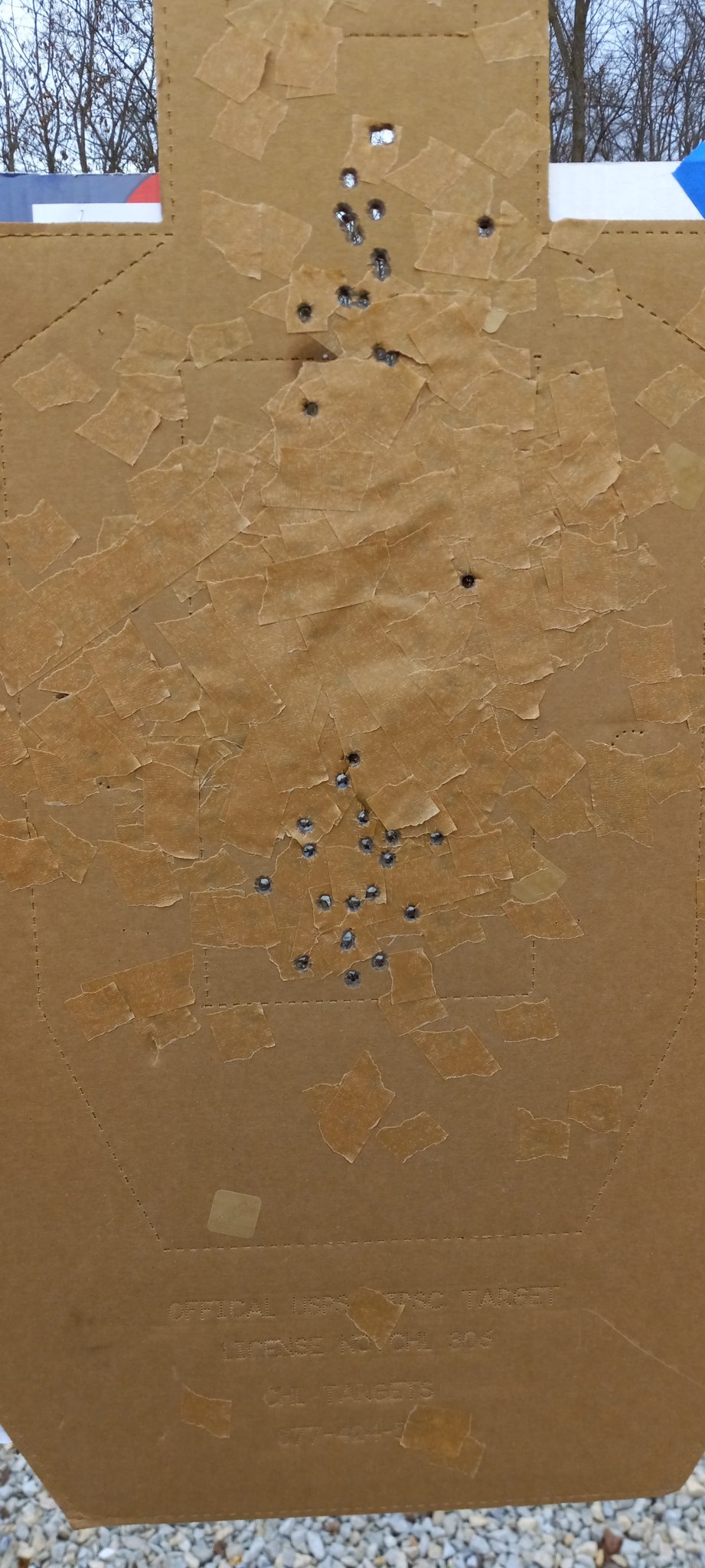

This is what doubles at 10 yards looks like with splits in the .18 - .2 range.
If the best you can do on a 10" circle at 10 yds is 60% hits you need to fix both your grip and trigger control
