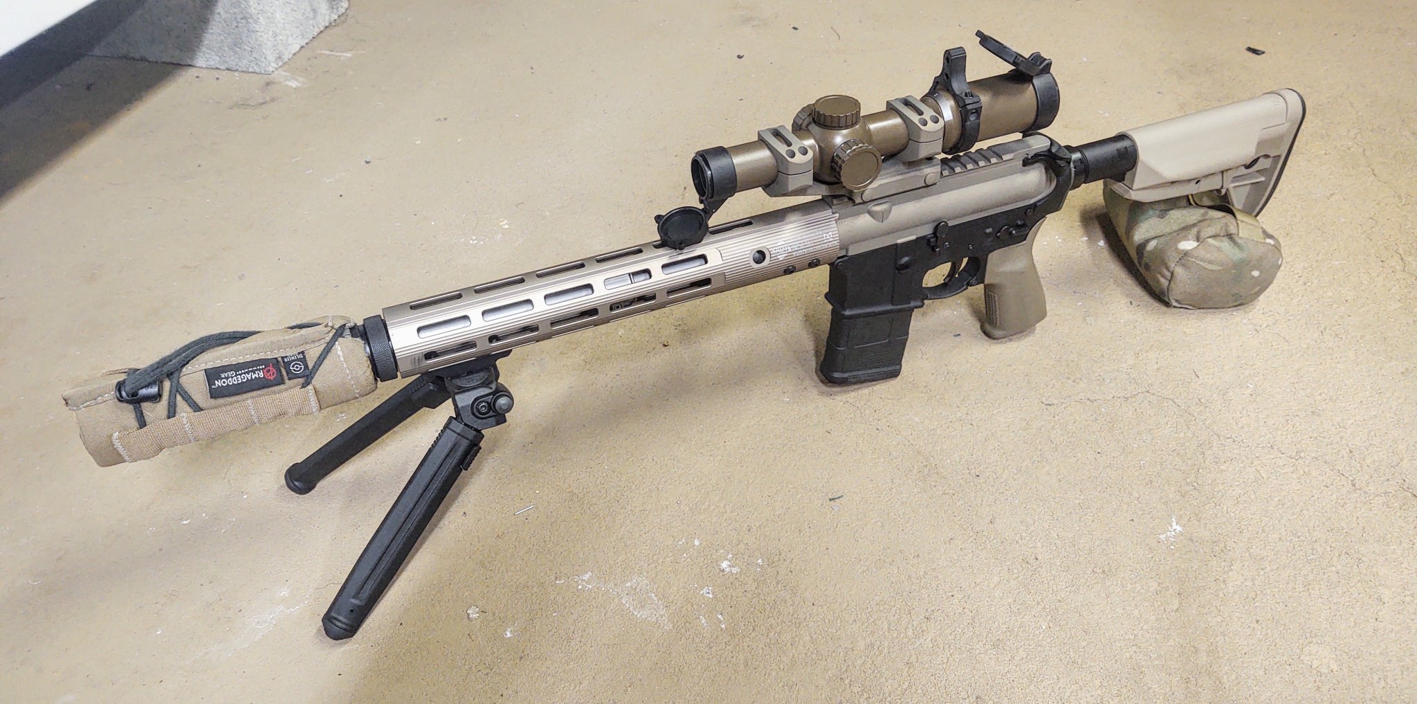

So I've been running the Magpul with the panning disabled on a new rifle I've been testing.
What I've learned:
-it's better than it was when it did pan
-it's still really tall
-the feet are still slippery/slide
-it'd be better with a 45 degree leg option
-it'd be better with different foot options
Not a fan of the bipod overall, though better with the panning disabled. I'm not a fan of Harris, but I've come to realize I still like the Harris better than the Magpul.
Shooting for groups @100, I'm certain the bipod was not as stable as an Atlas CAL, which are my standard bipods.

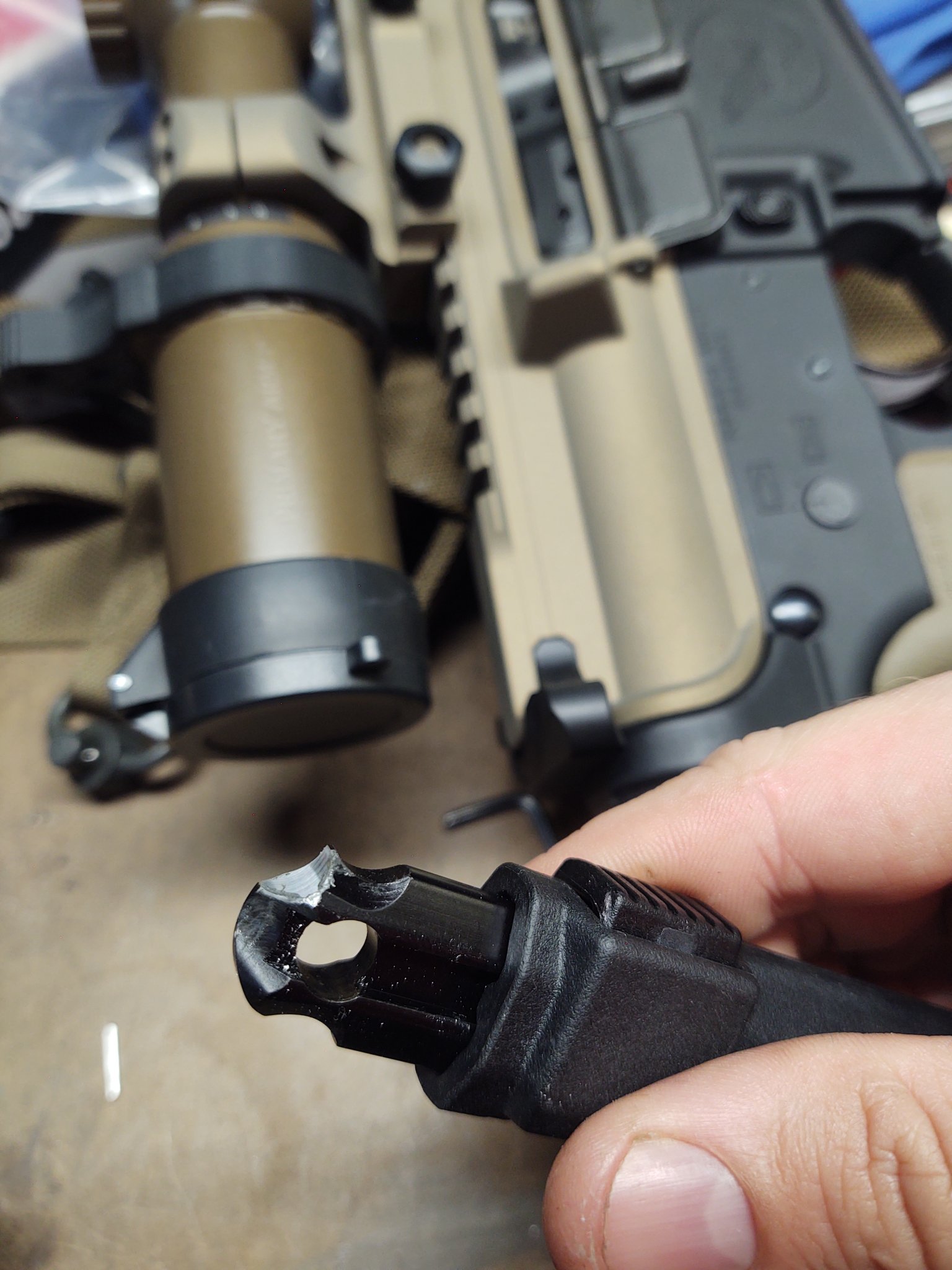

You can fix the 45 degree thing relatively easily.
Still not a great bipod, but it definitely makes it more usable.

The feet are Atlas pattern. Any Atlas compatible foot will work.
