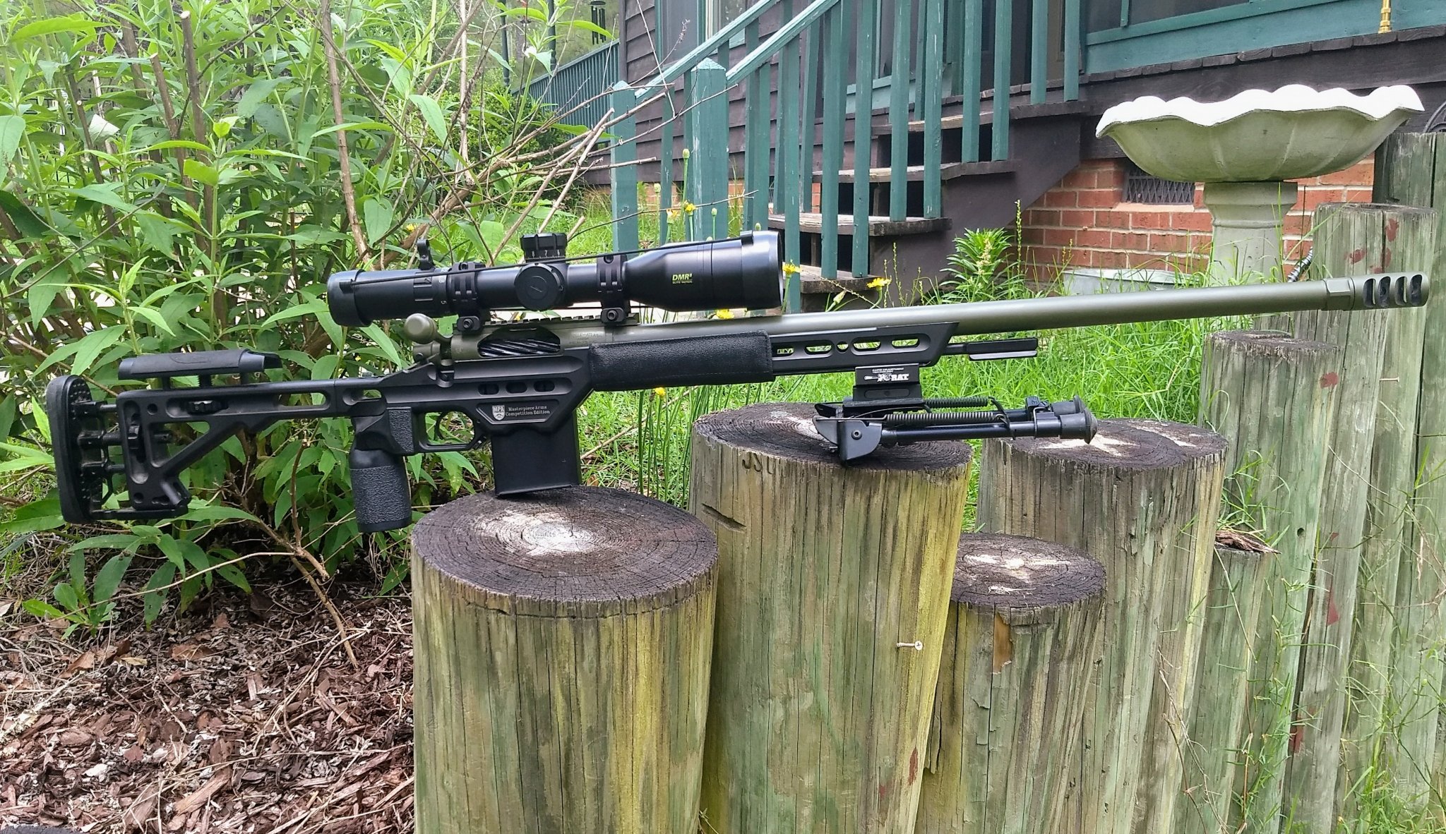

I saw a guy on YouTube a long time ago who shot a .223 at a mile with a 30” barrel. I don’t recall what bullets he was using. I’d be very happy to get it to 1000. As for now I’m using 190 SMK out of my 20” RPR .308 and they get there fairly easily. But I’m showing 38 Mils to get my load to 1760. At least I might catch the splash a little easier.
Here’s one....
Reactions: CarbonMTN
I've shot long distance a fair bit with 223, stay off YouTube is my advice. I agree with Greg above about 600-800 being good near max (regular hits) with 223. I have had several hits at 1000-1100 in matches, but wind blows and I'm dead. Got a 223 trainer, MPA chassis, kelbly tactical Atlas, 25" M24 barrel, and will use Hornady 75 elds. But only shot 77 smk previously. If you want an affordable, fun, rifle to shoot 400-800, it's hard to beat. And occasionally reach out to 1000 on calm days, sure, absolutely.
Dan
NC

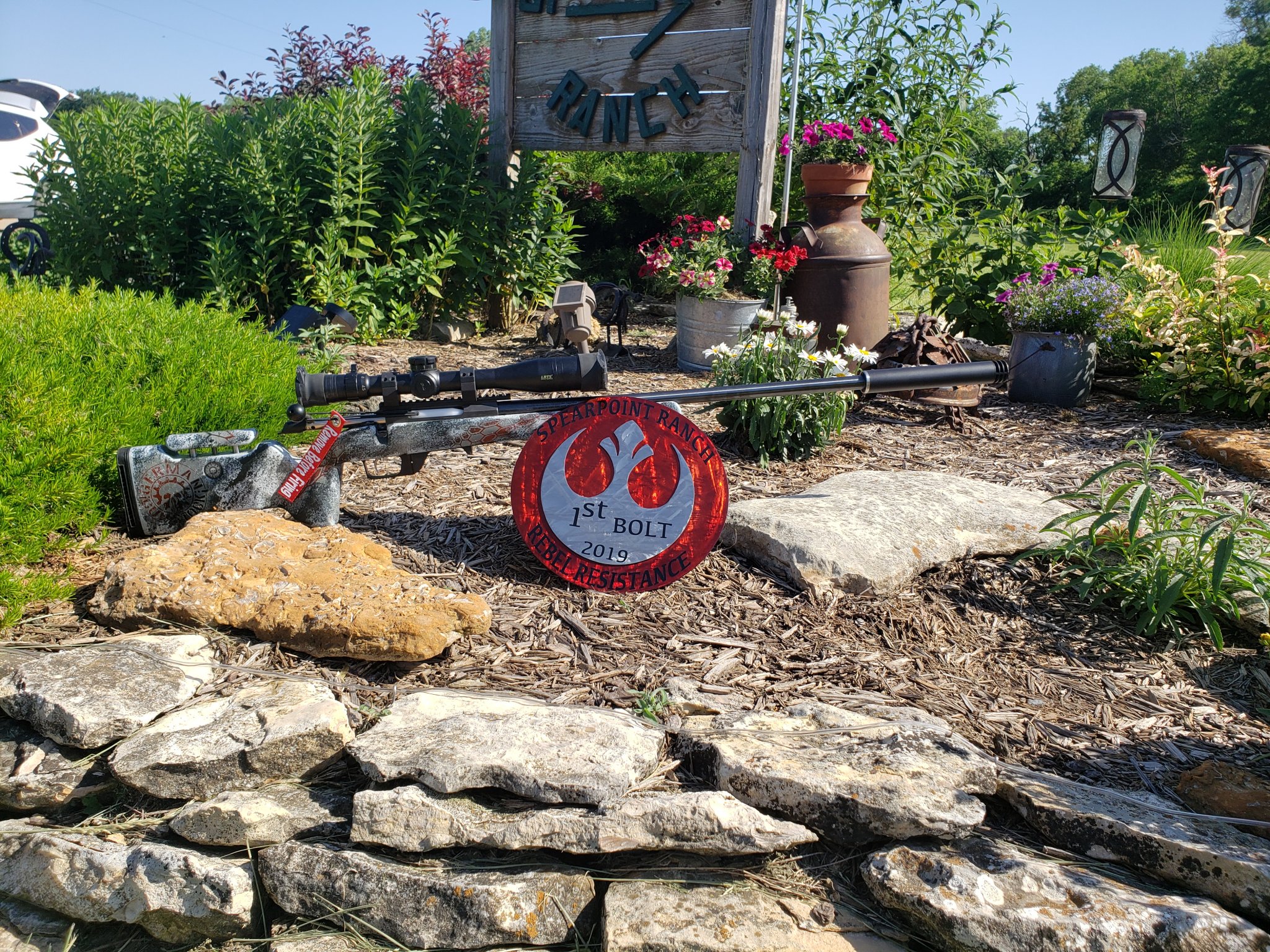

I have the Tikka Varmint in 223 and it is really fun to shoot with the 75gr ELDM at 3035 fps. I am using H4895, Nammo brass, CCI 450s, and loading them .020" off the lands (2.49"). I have taken it past 1000 in matches and my son made a 1st round hit at 1400 with it. I would run the 80gr ELDM if I were shooting for a mile in a 1-8" barrel.
