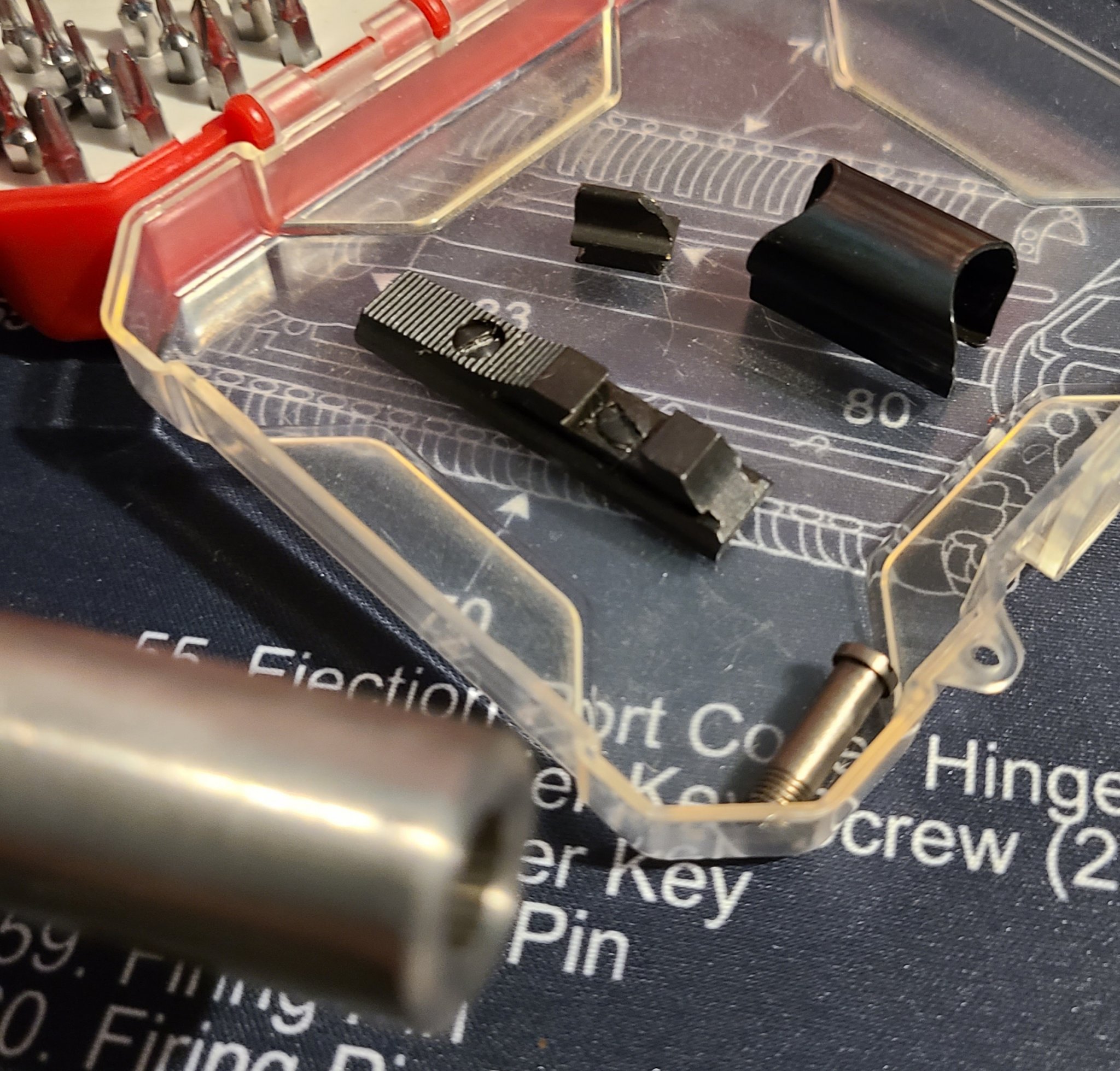

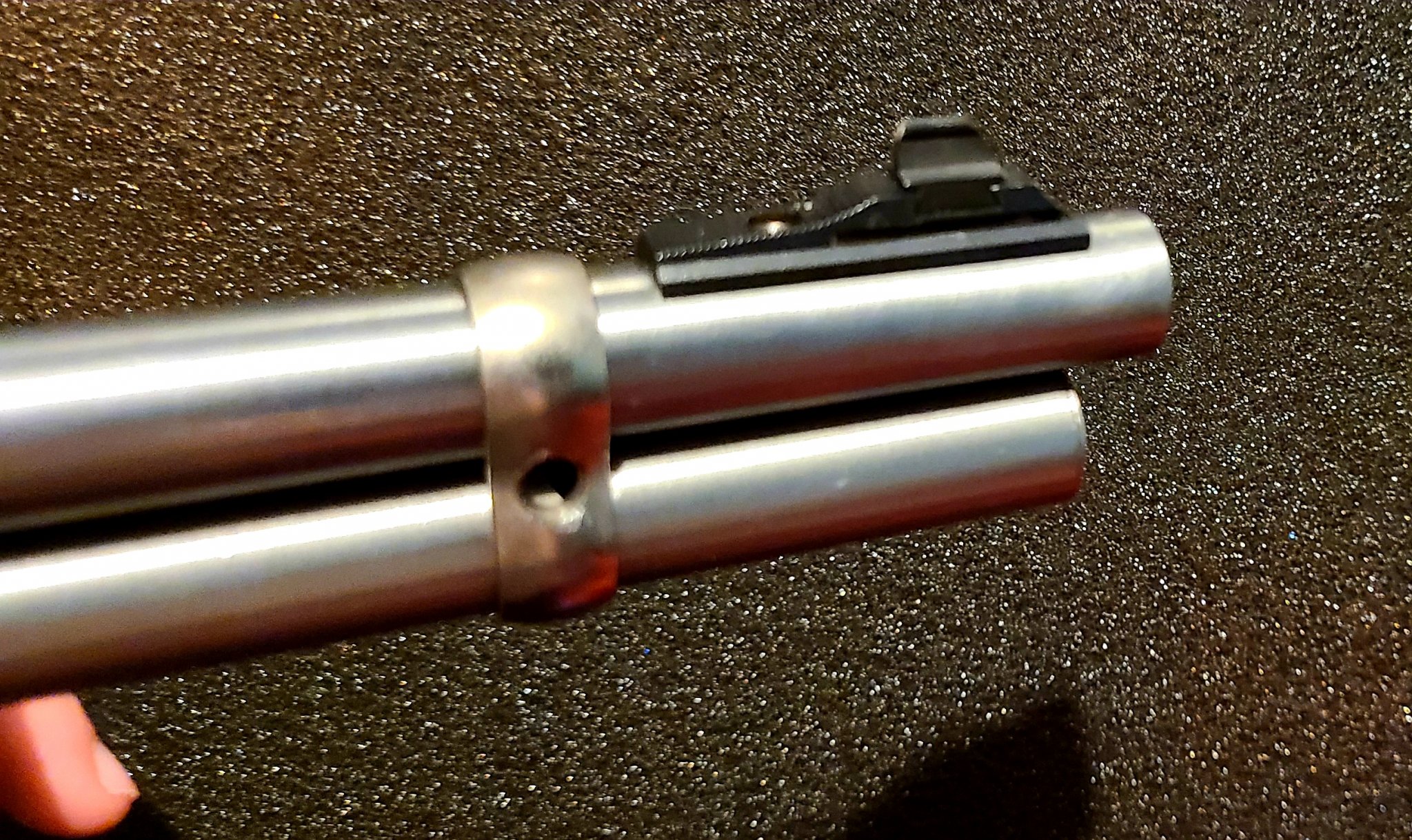

    Ok guys, not a LR question but I am not sure about this one?...
    Does anyone know how to remove the front sight on an older Marlin 336SS?
    Thanks

    Figured it out
    •Just remove hood if equipped, by pulling forward. Grip tightly or use something to open the hood up.
    •Then drift front sight out left to right using brass or plastic punch.
    • Then remove 2 screws with proper sized flat head screwdriver.
    Pic below...
