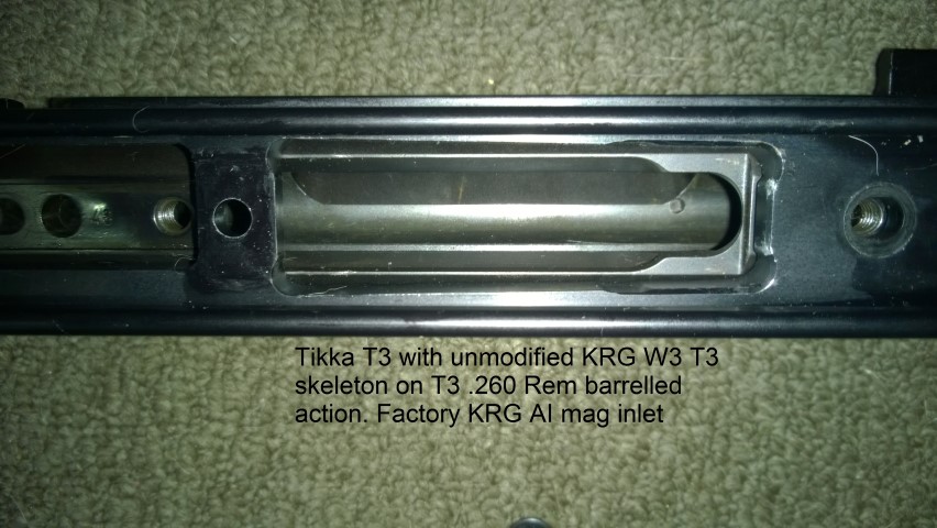

The KRG Whiskey 3 Chassis for Tikka T3 is excellent in its own right and feeds from AI type 308 mags.

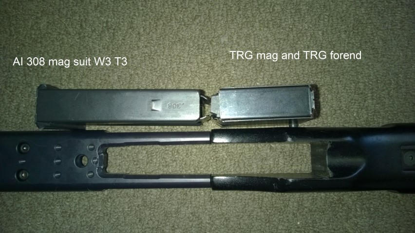

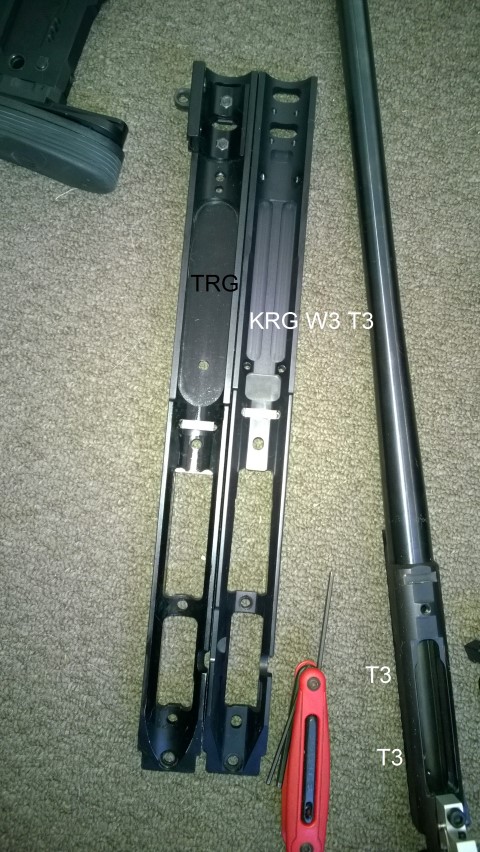

I much prefer the TRG22 double stack 308WIN mags over the AI (and I own two TRG mags and two AI mags). The TRG mags also accommodate larger OAL hand loaded 308WIN rounds. They hold (10 thou off the lands) .260Rem 123gn Nosler Custom competition easily.
Finally I decided to go with making the T3 accept the TRG forend and TRG magazines with TRG bipod.

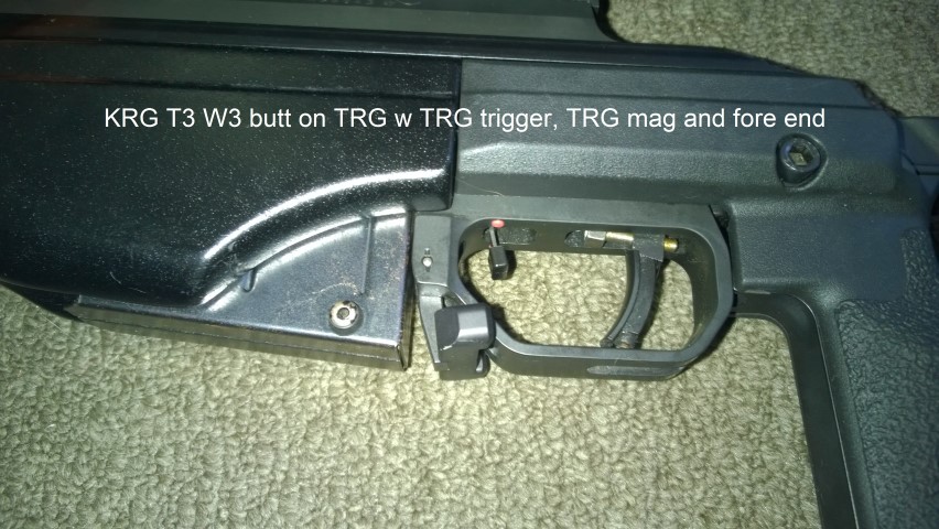

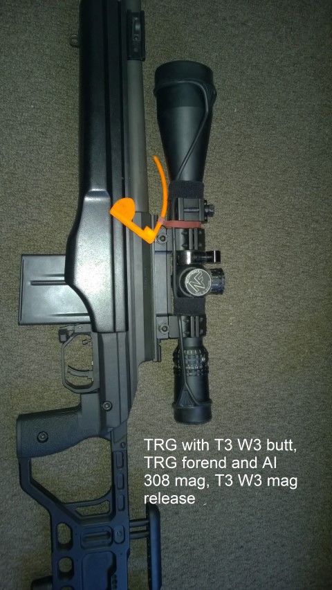

After a few shots (in the TRG with KRG W3 T3 butt, TRG forend and AI mags) off hand and I hate how far the AI mag protrudes. My Offhand is better with my hand under a flush TRG mag. The upcoming competition involves off hand shooting and other unsupported positions.

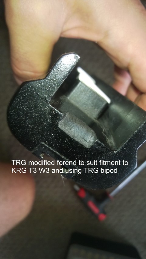

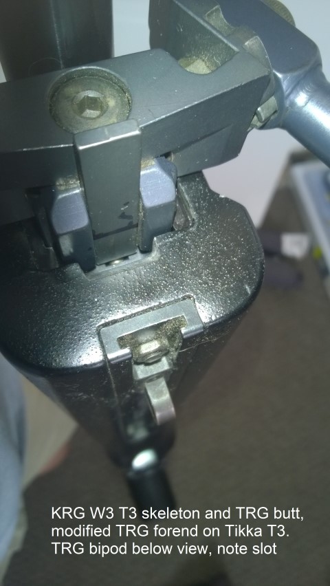

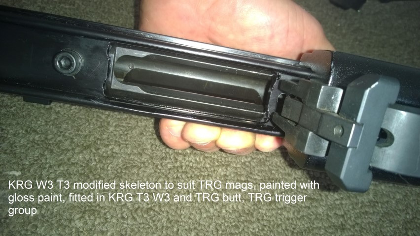

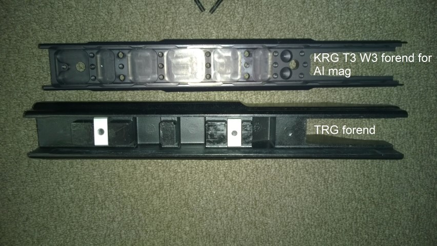

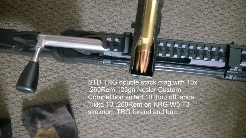

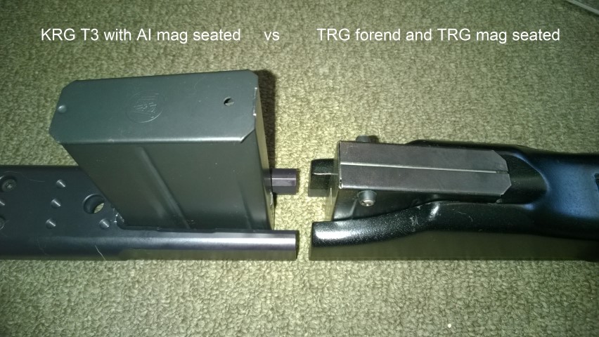

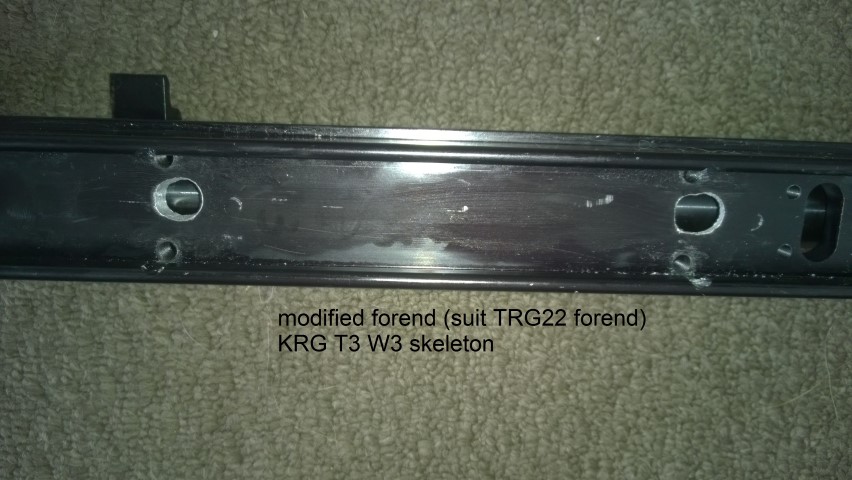

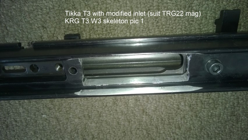

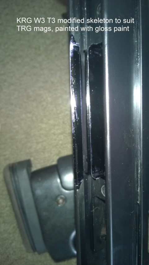

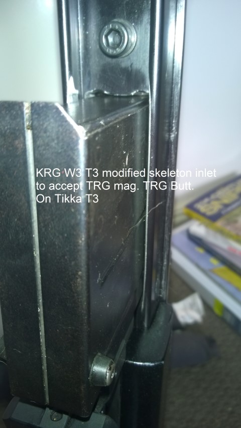

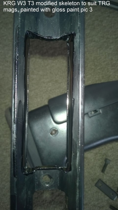

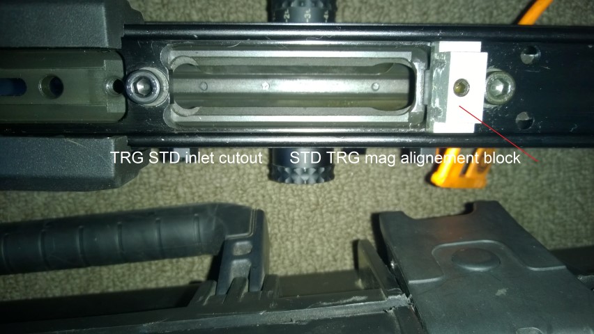

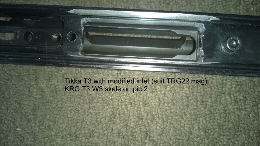

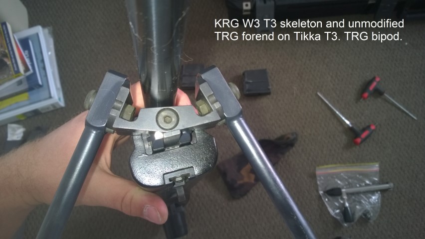

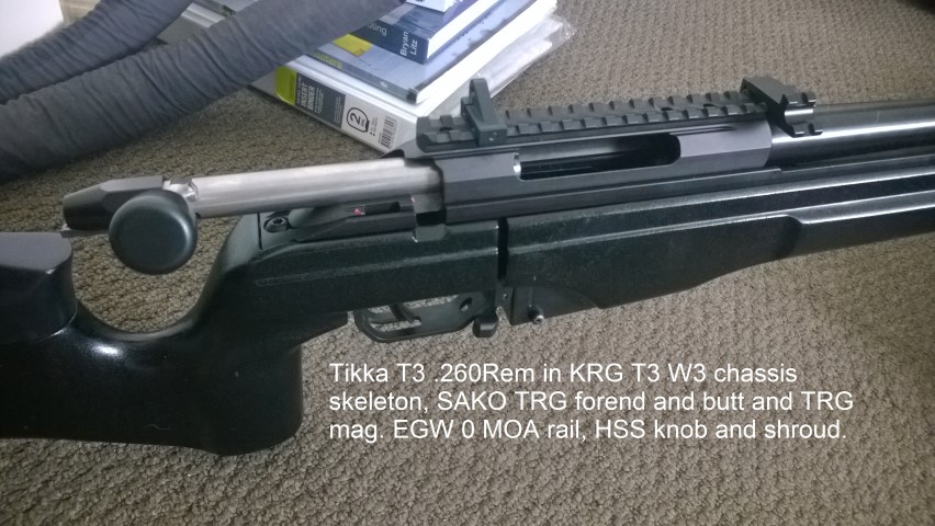

To make the Tikka T3 accept a TRG forend and magazine and to use the bipod:

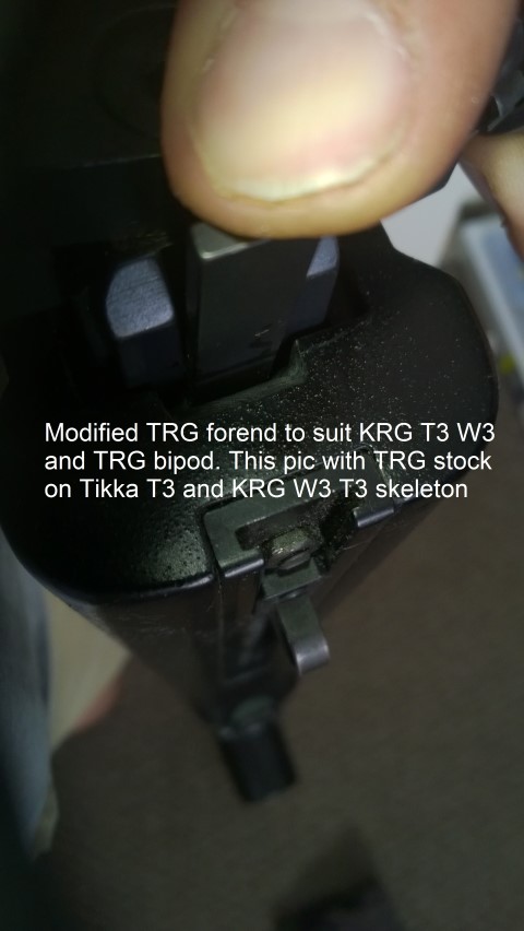

Modify the TRG forend to enable the bi-pod release to fully disengage. (the forend sits slighlty forward to make the TRG mag fit)

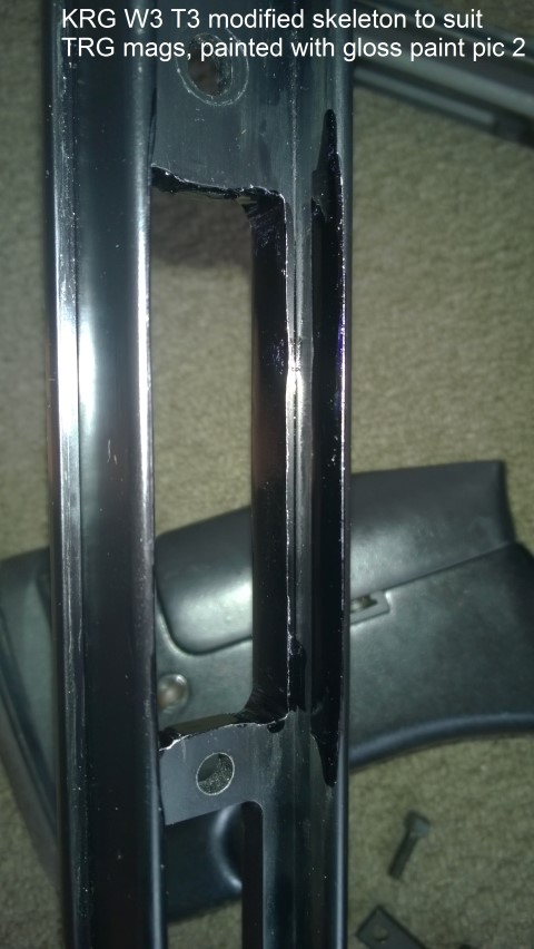

Modify the inlet of the KRG W3 T3 chassis to fit wider TRG magazines. As standard it is only wide enough to fit AI mags.
At the front of the KRG W3 T3 skeleton, drill a couple of holes to enable the TRG forend screws to seat fully as they are too long (or cut / use shorter screws). But if they do come loose the forend won't slide off.
If you want to use the KRG W3 T3 chassis on the TRG or T3, have a selection of new high tensile screws (cheap from a quality bolts place) and washers to enable the correct thread purchase and not over seat and run into the bolt raceway. Use good light to check this.

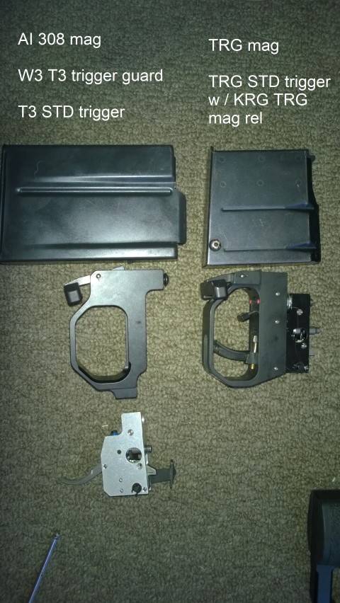

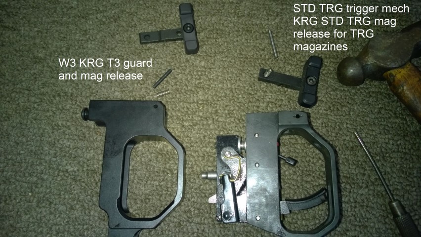

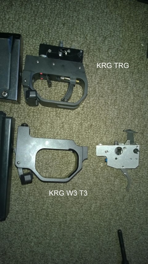

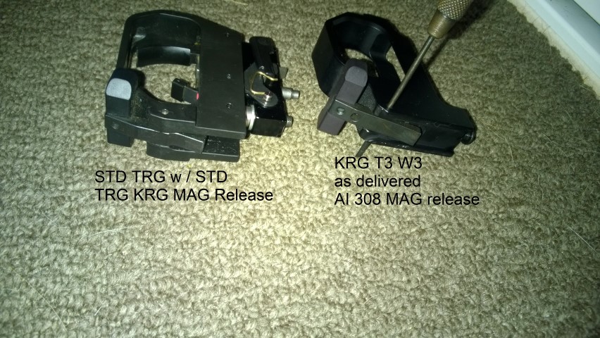

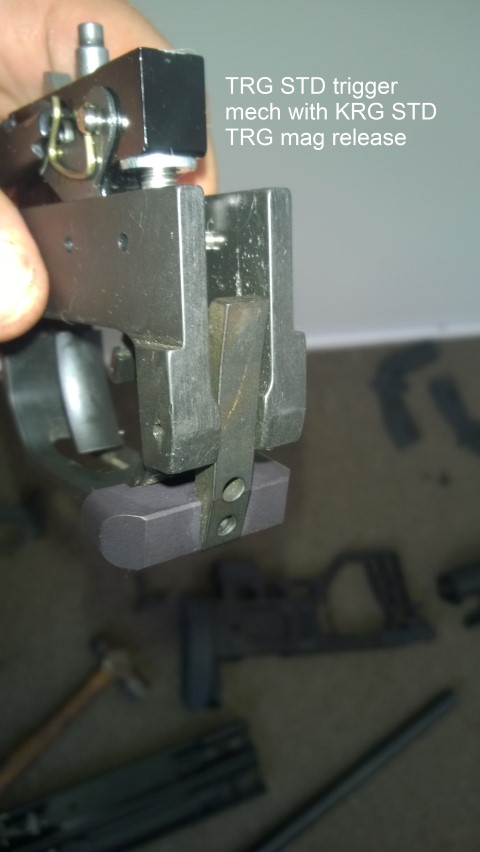

  • 10 Tikka T3 with unmodified KRG W3 T3 skeleton on T3 .260 Rem barrelled action. Factory KRG AI m.jpg
  • 13 Tikka T3 with modified inlet (suit TRG22 mag) KRG T3 W3 skeleton pic 2 (Small).jpg
  • 15 KRG W3 T3 modified skeleton to suit TRG mags, painted with gloss paint pic 2 (Small).jpg
pics 16-20
  • 16 KRG W3 T3 modified skeleton to suit TRG mags, painted with gloss paint pic 3 (Small).jpg
  • 17 KRG W3 T3 modified skeleton to suit TRG mags, painted with gloss paint (Small).jpg
  • 18 KRG W3 T3 modified skeleton inlet to accept TRG mag. TRG Butt. (Small).jpg

  • 20 KRG W3 T3 skeleton and unmodified TRG forend on Tikka T3. TRG bipod. (Small).jpg

  • 21 TRG modified forend to suit fitment to KRG T3 W3 and using TRG bipod (Small).jpg
  • 22 KRG W3 T3 skeleton and TRG butt,  modified TRG forend on Tikka T3. TRG bipod below view, note.jpg
  • 23 Modified TRG forend to suit KRG T3 W3 and TRG bipod. This pic with TRG stock on Tikka T3 and .jpg

  • 26 STD TRG double stack mag with 10x .260Rem 123gn Nosler Custom Competition suited 10 thou off .jpg
  • 27 Tikka T3 .260Rem in KRG T3 W3 chassis skeleton, SAKO TRG forend and butt and TRG mag. EGW 0 M.jpg

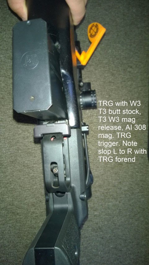

  • 28 TRG with W3 T3 butt stock, T3 W3 mag release, AI 308 mag. TRG trigger. Note slop L to R with .jpg
  • 29 TRG with T3 W3 butt, TRG forend and AI 308 mag, T3 W3 mag release (Small).jpg
Immelmann, i have a trg trigger enroute. I have a tikka with w3. Which mag release would i use on the trg trigger guard to make ai mags work on my tikka? Krg, trg, modified trg or krg? I know massoud said i can pick one up from them, but if the lever just needs some trimmed off to work, i can do that. If the lever needs to be longer then i will need to get one from krg.
6brshooter, I would use the KRG T3 mag release that comes with the KRG T3 W3.
If you look at post #12, you'll see that the AI mag catch point is much higher, so I think you would need a longer mag release catch.
When I had the W3 T3 mag release fitted to the TRG trigger group and put a TRG magazine in, it wasn't secure due to the mag catch recess / bump difference. This would be on TRG and T3.
Also you'll love the TRG trigger. I can get mine to a mouse click but on quick bolt throw (being rough) you lose the first stage and it goes to about a 4kg trigger. Set to just under 1kg on the second stage is perfect for me (even lighter on the first stage) and you can be rough or gentle all day. Just don't ever install a TRG trigger into anything with the bolt in (sounds obvious but the captive bolt makes it easy and you have to move the safety out of the way to off to access the screw).

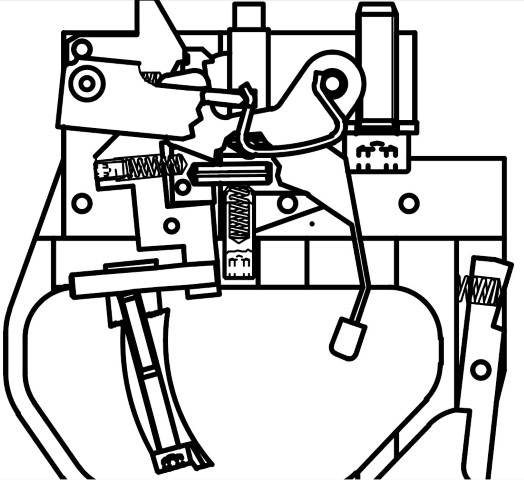

from Sako TRG user manual .pdf
