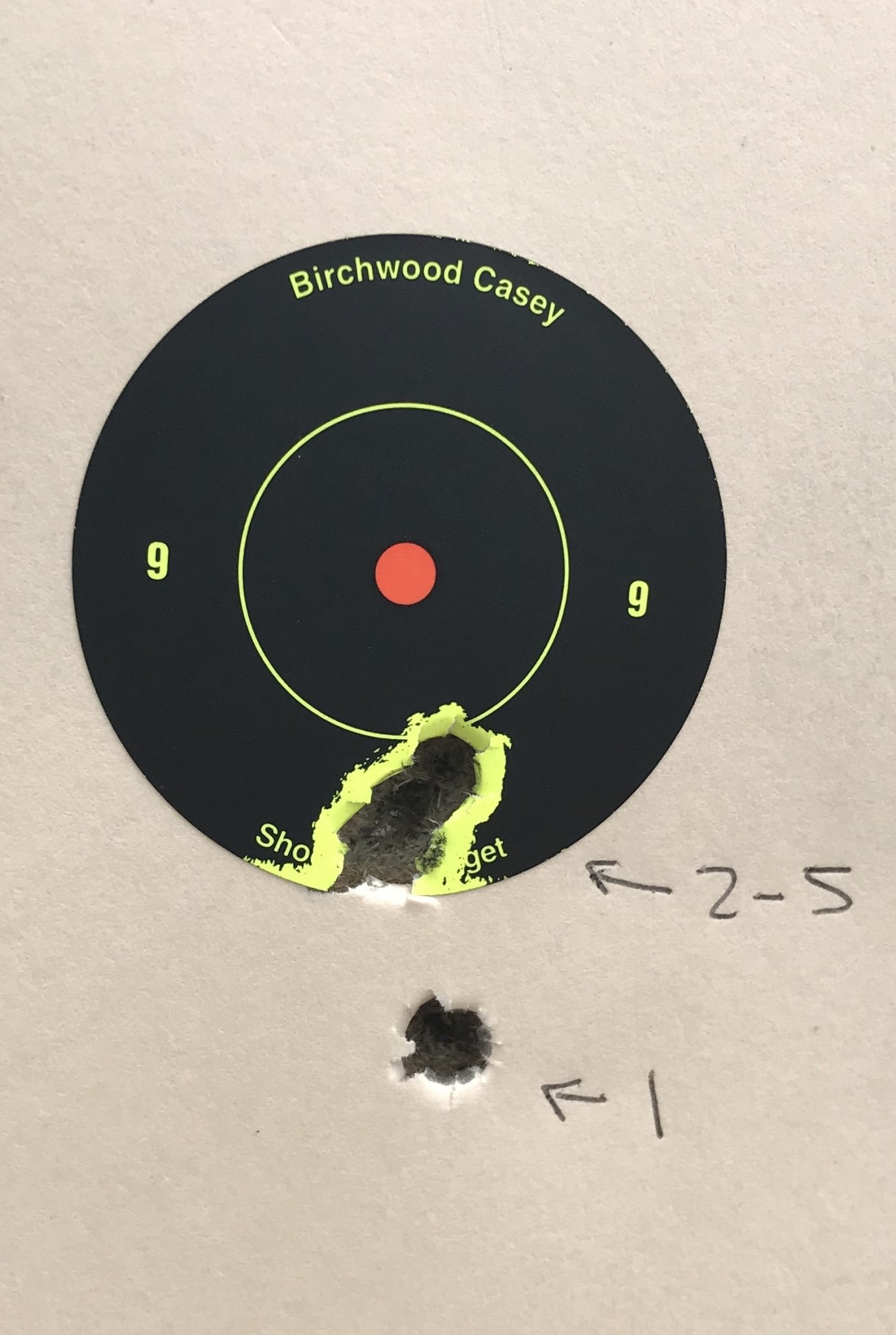

Many of you probably know I’ve been working on my own AI chassis, and the intention is to de-bond a factory AT or AX action and re-bond it in the new chassis. So over the past few months I have had my factory AX de-bonded to work on the project. I recently re-bonded it back together and took it to the range to re-zero with my current 6.5x47L barrel and match load. This is all what I have done to the rifle, and the results...
- De-bonded and re-bonded the action twice
- Removed and reinstalled a G2 Razor mounted in Spuhr
- Removed and reinstalled scope action rail
- Removed and reinstalled barrel about 5 times
- Cleaned barrel
My zero changed by only 0.2 mils straight down, that’s it. Rounds 2-5 went into one hole. Holy shit.
So if anyone asks me how repeatable barrel swaps are on an AI, I’ll tell them I can literally take the gun apart to individual components, reassemble it, and it will be closer than most rifles will be with a simple barrel change or scope swap.
- Cleaned barrel
