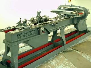

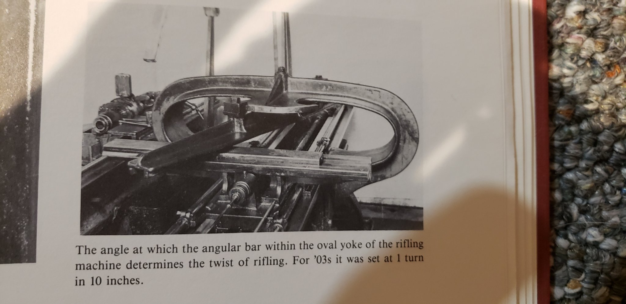

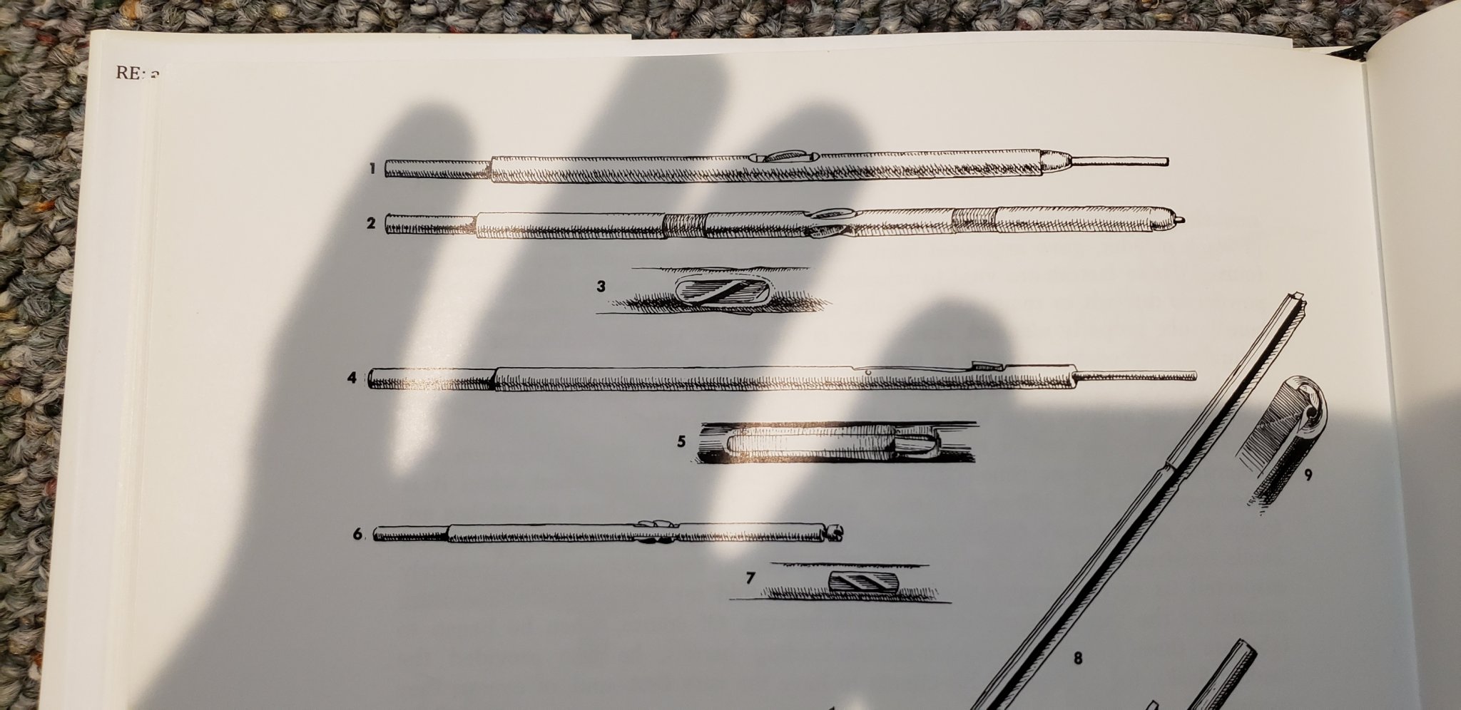

I was able to find this:
"Until WW II, the bore and rifling of the '03 barrel was finished by the above described hook cutter rifling method. To speed up production during WW II, the bore of the barrels was machined by long cutters having many teeth of increasing size called broaches. By pulling two broaches (roughing and finishing) through the barrel it was finish rifled in a couple of minutes......most 03A3-A4 barrels were manufactured by this method. "
-The Springfield 1903 Rifles by Brophy
So something like this?
that’s pretty interesting.

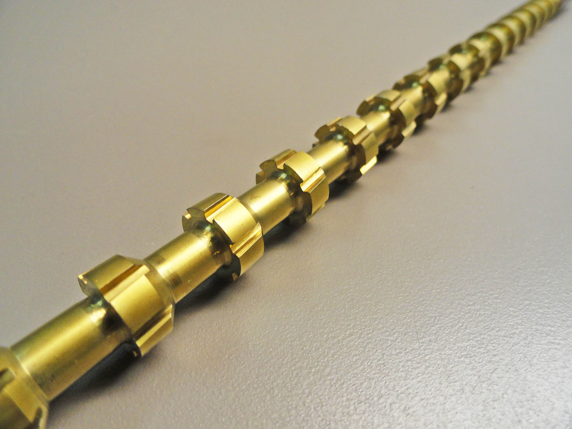

@Steel head - correct.. theres a good article on it here:
https://firearmshistory.blogspot.com/2010/05/rifling-manufacturing-broach-rifling.html
I'd have to think most WW2 era Garand and 03A3 barrels were made this way simply due to the speed of the process. You can make several times as many broach rifled barrels in the time it takes to make 1 single point rifled barrel. However, the 2-groove barrels I imagine were single point cut rifled, since cutting half the grooves will save time if using single point cut rifling while there is no benefit to using less grooves with broach cut rifling. I could be wrong tho...

They used a Pratt and Whitney Grasshopper. The two scraping cutters were held in a rifling rod. The operation (Operation 27) and tool drawing/ dimensions/ specifications are all in Colvin and Viall’s work noted above...that data actually was the technical design package provided from Springfield Armory to Winchester for the purpose of manufacturing the M1903 service rifle...

Say Mr Frank, as noted above it says in that book the machine used is the P&W "Grasshopper".. is that the model name for the Sine Bar rifler? It says they have "two scraping cutters per machine" that make 8 strokes per minute.. have you seen a Sine Bar in operation? Does that sound right? I thought the later, WW2-era Hydraulic "B" series riflers were the 2-spindle machines?
Ive also read elsewhere that a single point cut rifling machine can be converted into a broach cut rifling machine.. is that correct? I suppose it makes sense, replacing the cutter box with a broach, and stopping it after 1 pass..??
The grass hopper machine (not sure who made them as I’ve only seen one. Krieger was given one and it wasn’t used. More of a curiosity thing than anything else) and if you can picture it....there is a big arm or call it a leg on the side of it that rotates and it looks like a grass hoppers leg. Hence the name. It predates the Sine Bar. Yes I’ve seen the Sine Bar work. The Pratt hydraulic machines where two spindle and some of the really big ones where single spindles but not sure who made the single spindles. I want to say P&W.
The two scrapping cutters I’m going to say has nothing to do with the machine. That’s in the tooling. Double scrap cutter tooling was being used/made back even when the cut rifling was done manually by a human pulling the cutter thru the barrel by hand!
Places have converted/modified the Pratt’s for pulling broaches and even pulling buttons. Why because they don’t understand the tooling for cut rifling is one. Another is going cheap. Another is because the machine isn’t complete so they make it work with what is there. I know of places have modified the machines so that one side is for pulling a reamer thru the bore and the other side for pulling a button.
I’ll see if I can dig up some pictures of stuff and post them when I have time.
First picture is of rifling heads. #2 and #3 head is actually for a 3 hook cutter set up. #6 is of a double hook cutter set up. We've toyed with doing multiple cutter set ups but have abandoned the idea for several reasons. Doing big caliber cannon barrels the double cutter set up makes sense but in small caliber barrels (20mm and smaller) not worth doing.
Next two pictures are of a Sine Bar rifling machine.
Later, Frank
