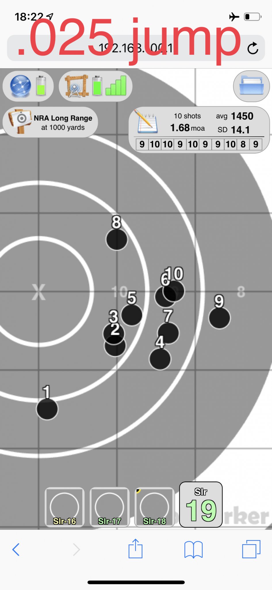

Good test results last night. Checked zero and chronographed my previous best tested jump (.020”) at 100y then moved to 1000y with e-targets. .025 was clearly the best group at that distance. Shot one was expected shift and shot 8 was a flyer because of a flinch from the person next to me firing a fraction of a second before I broke the shot. The grids are .2 mil reference. I’m looking forward to running this load at the next match. Also, I want to test 10 rounds at .030 and .035, but my guess is the range of acceptable tolerance will be about .010” wide
