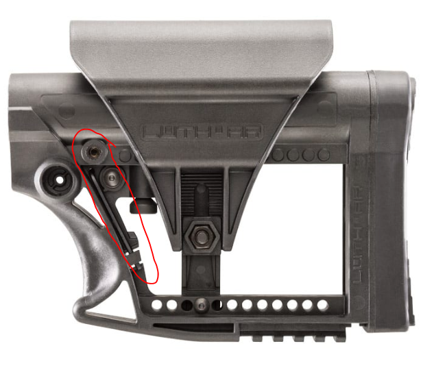

I have not sorted out the butt stock issue. This MBA-4 is terrible. It’s way too short and wobbles/flexes in all directions. Is there a way to directly mount a butt stock that gives the equivalence of an AXAICS/ stability of a single unit chassis? Or, can anyone recommend a quality rifle length butt stock?

Did you tighten the tensioning screw? Should lock out all of the wobbly.

Thanks! I discovered that last night and seems to take care of the side-to-side wobbly but not the up and down. I saw a video of one guy jamming in plastic stripped from a milk carton to fill the gap... which isn’t ideal. I know this isn’t the most expensive stock, but it’s not exactly cheap either. not sure what to do with that.. could they have put the wrong size buffer tube on?
