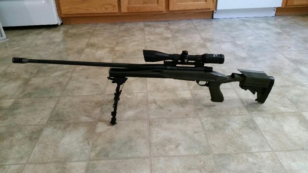

My Howa heavy barrel 1-10 twist rifle. Shoots wonderfully with 43gr. Varget and SMK 175gr HPBT; Lapua brass.

Hi Travis, that is a factory heavy barreled action. The brake is very effective, I got it from a member here (RWS) for $40, and then I had a local smith cut the barrel slightly shorter and thread and index for the brake.
I got the barreled action only from Legacy, I loved that option to be able to buy only the barreled action, and the factory barrel is plenty accurate... I've taken it so far to 600 yards with hand loads but 1/2 MOA at 200 yards is common.
When I have some additional money I will have the action trued and new barrel chambered.

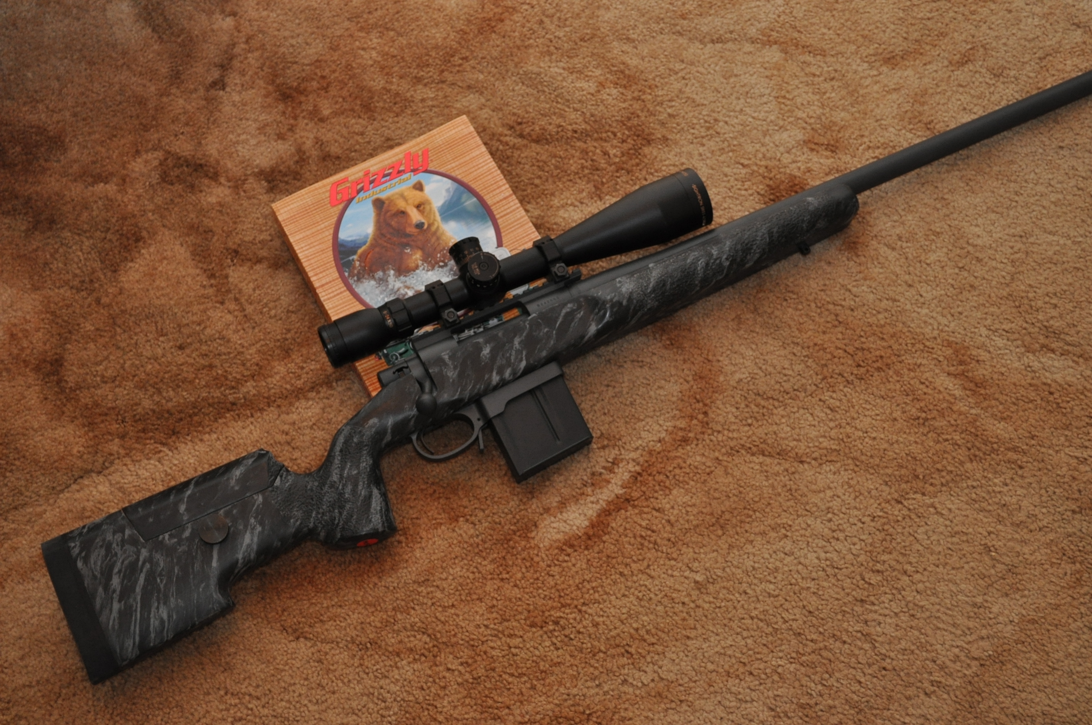

This is the latest Howa I've done for myself - a 260 Imp 30* on a Krieger 1-8tw in Rem varmint contour. Used sniper gray CeraKote to finish the metal parts, including PTG DBM, which I think goes well with the 70% black/30% medium gray marble of the McM A5 stock. This one's got the Howa HACT trigger - adjusted to 2lbs - which I felt was good enough to stay on the action. Only thing about the Howa that I don't care for is slightly heavier bolt lift than a M700, which only bothers me while shooting fast, such as when engaging movers. I may yet do something about it by machining down the stock bolt knob, threading the stub, and adding an extended bolt knob - if I ever get enough spare time. Otherwise, it shoots great, and I like the way it handles.
