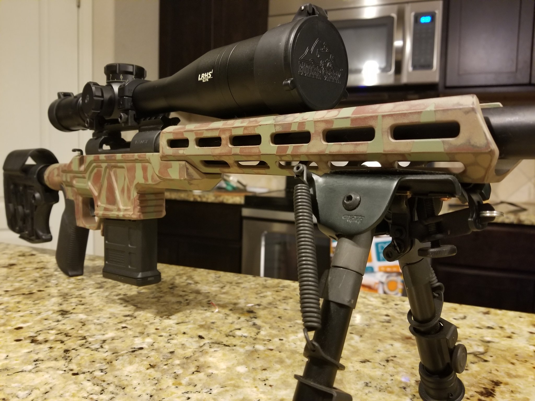

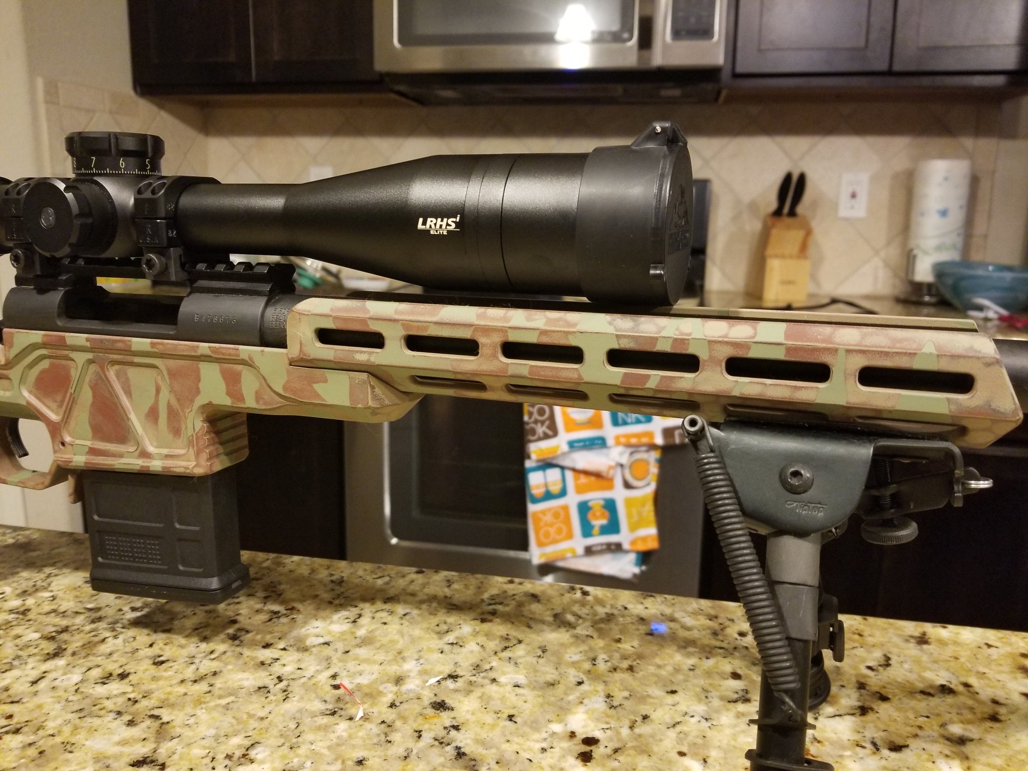

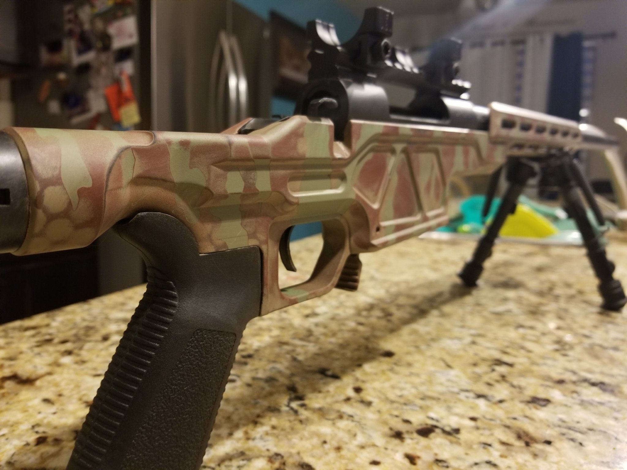

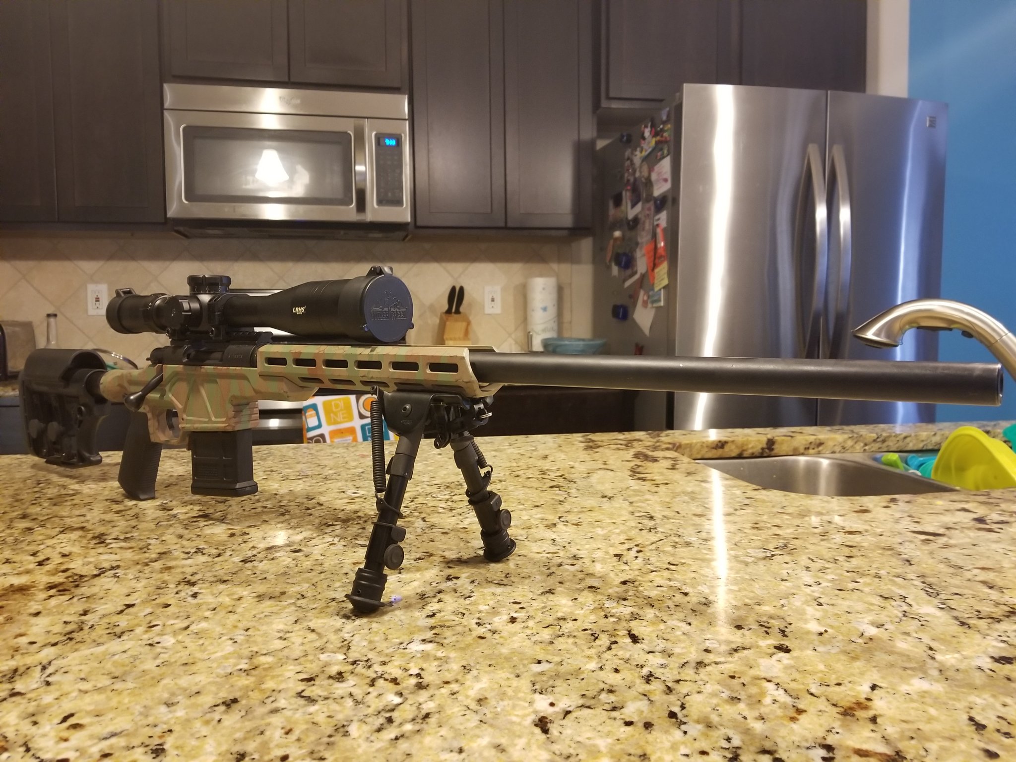

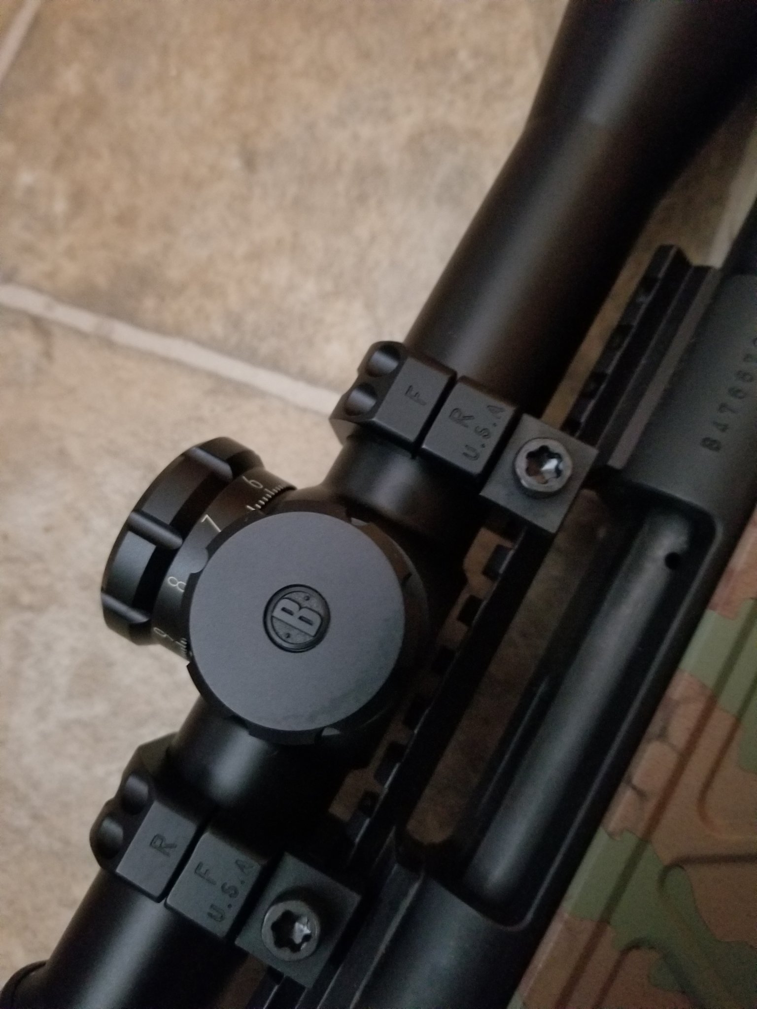

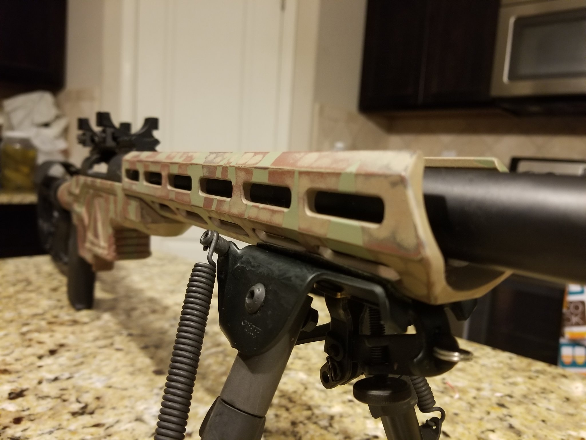

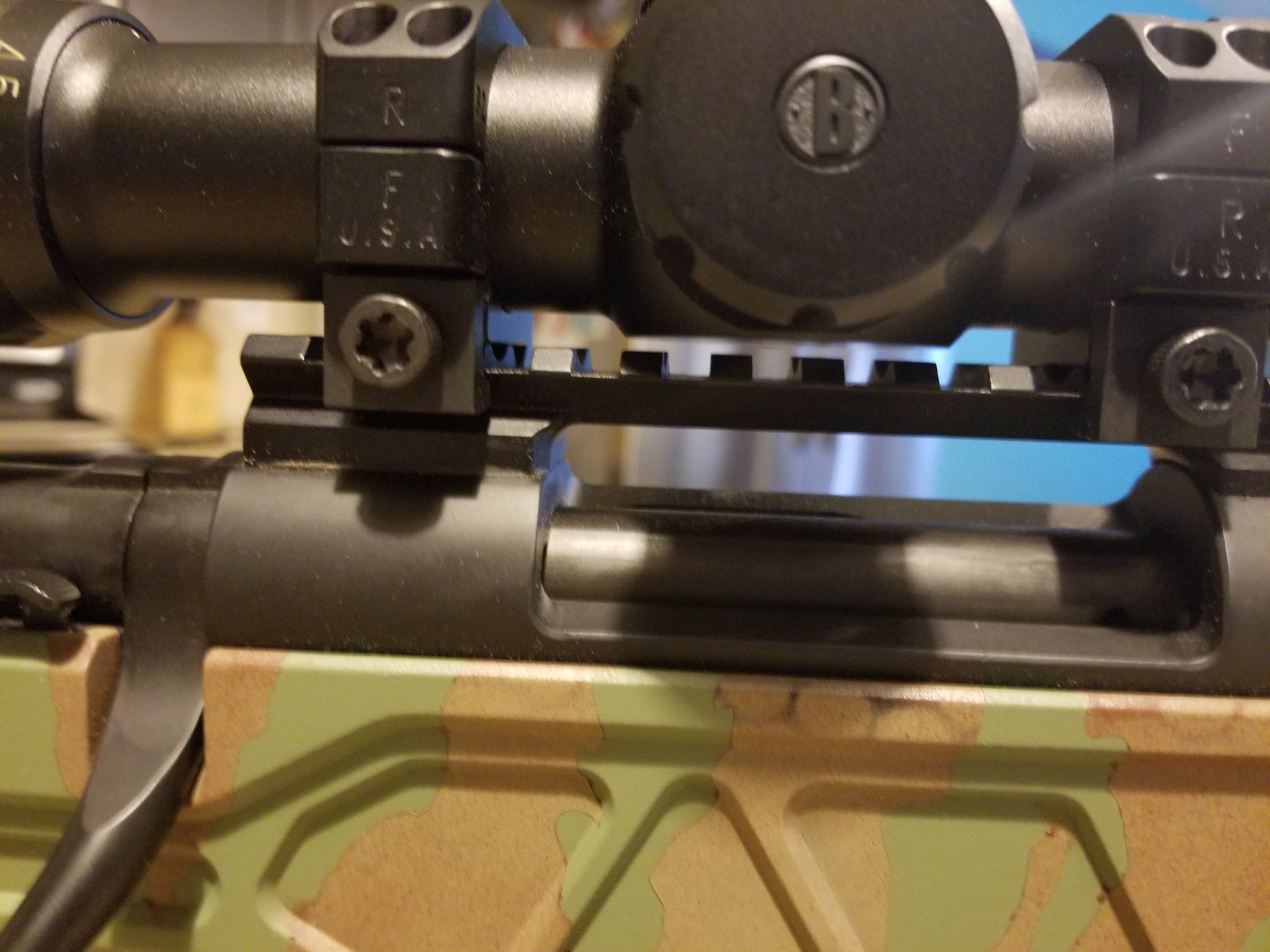

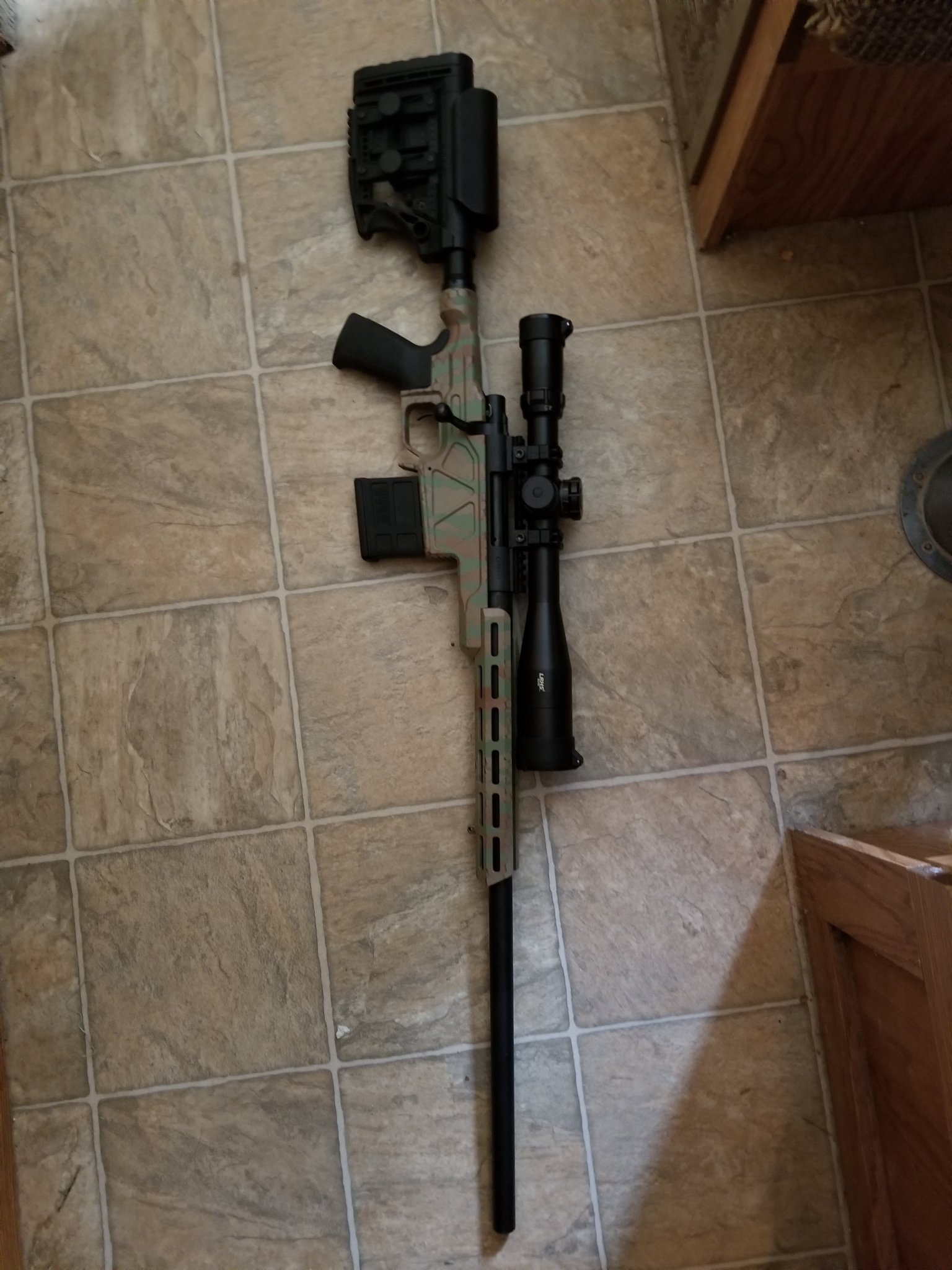

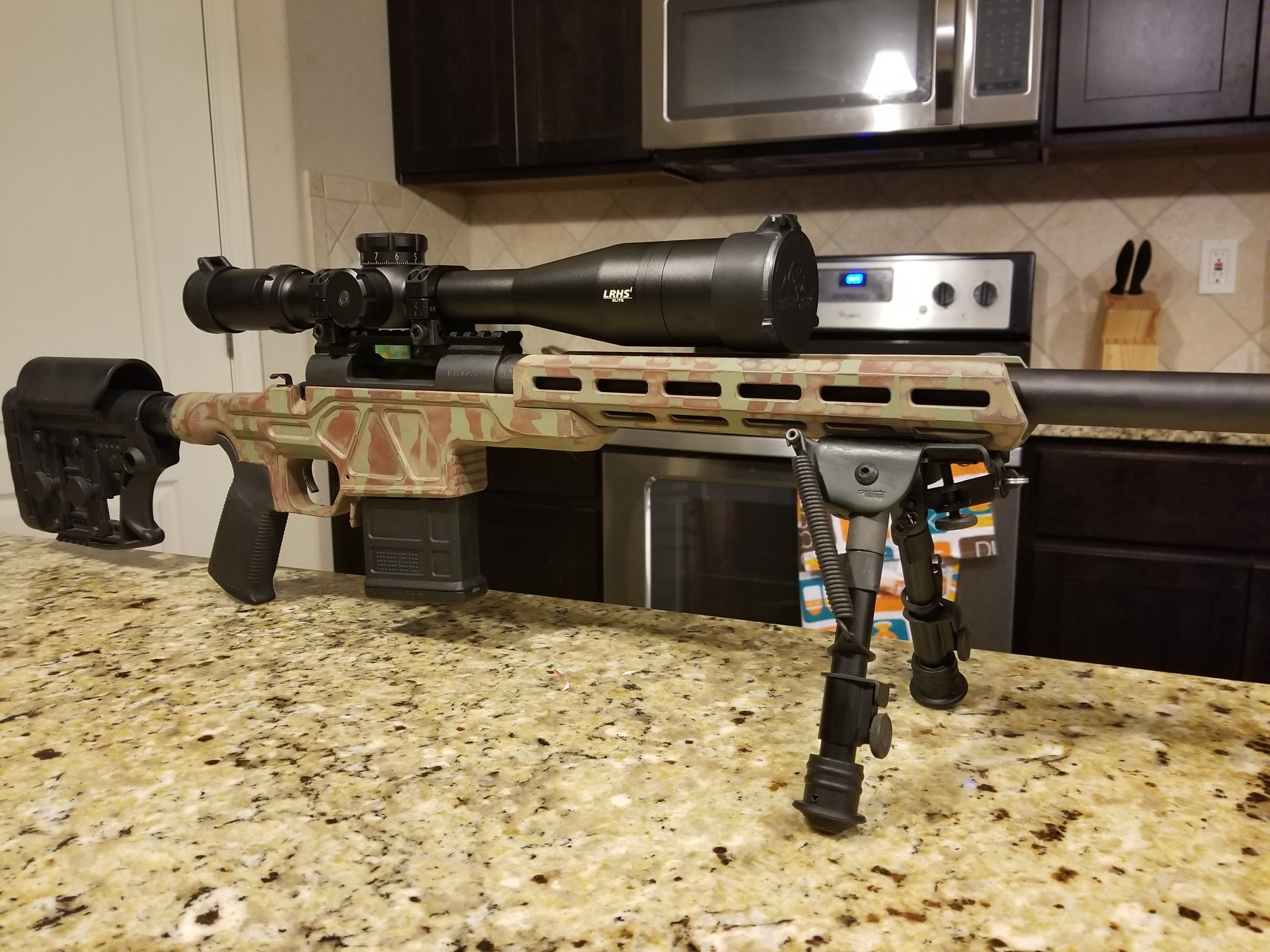

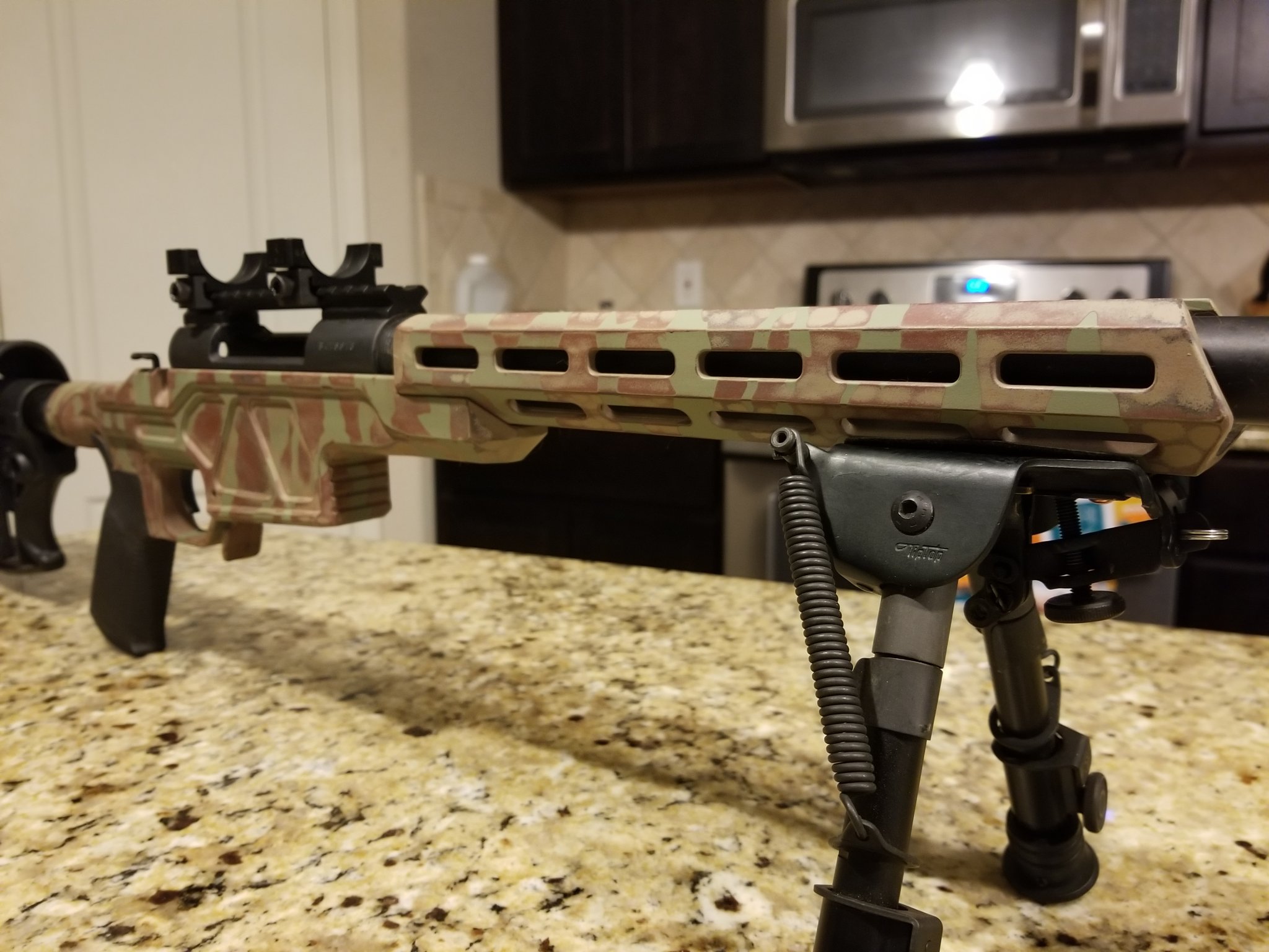

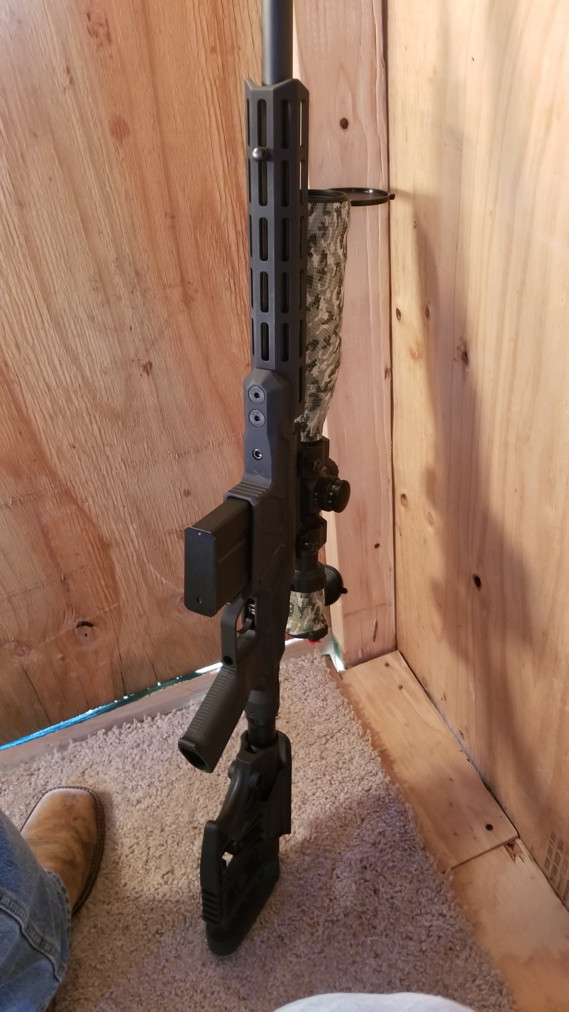

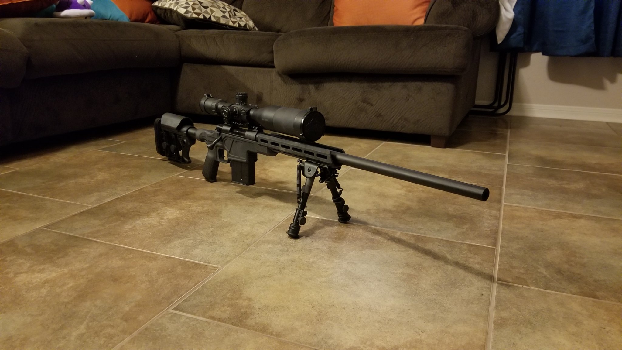

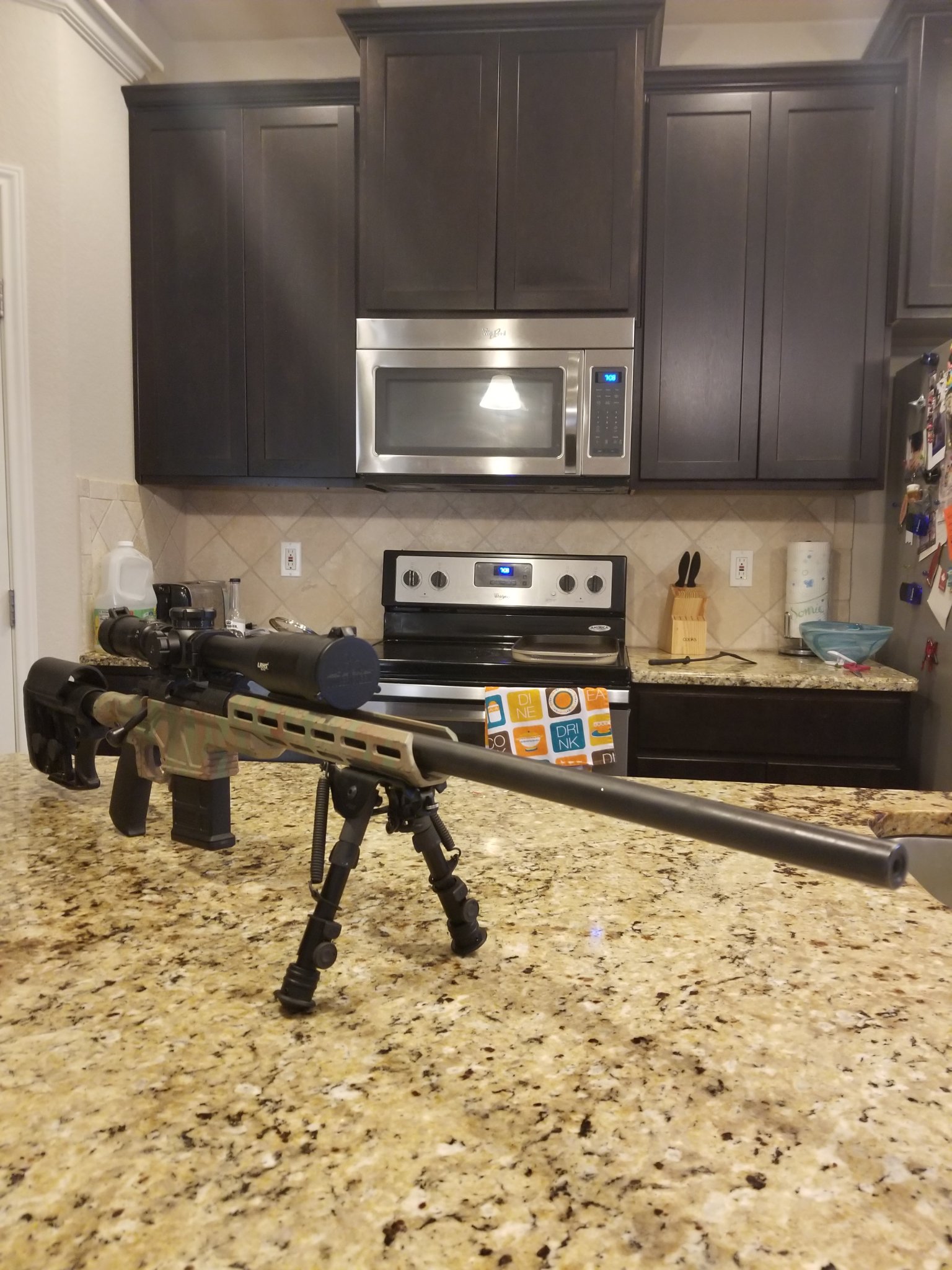

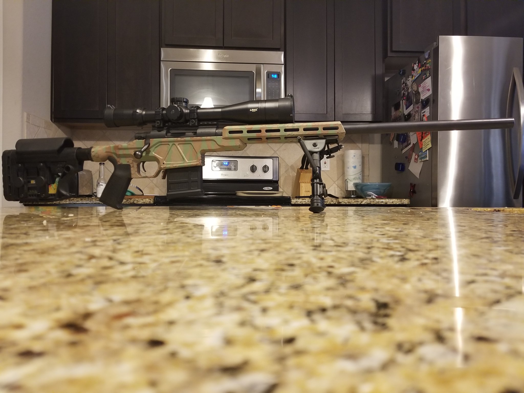

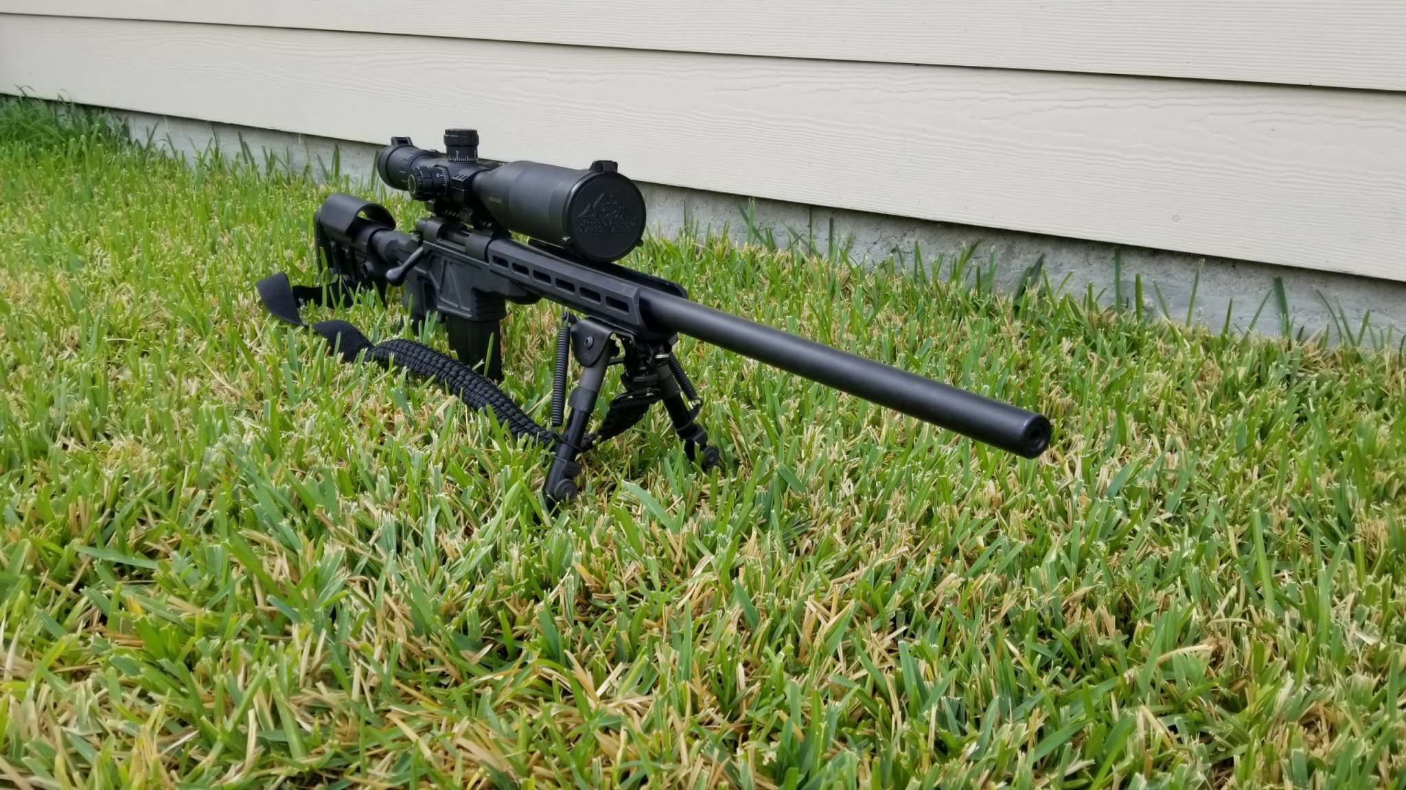

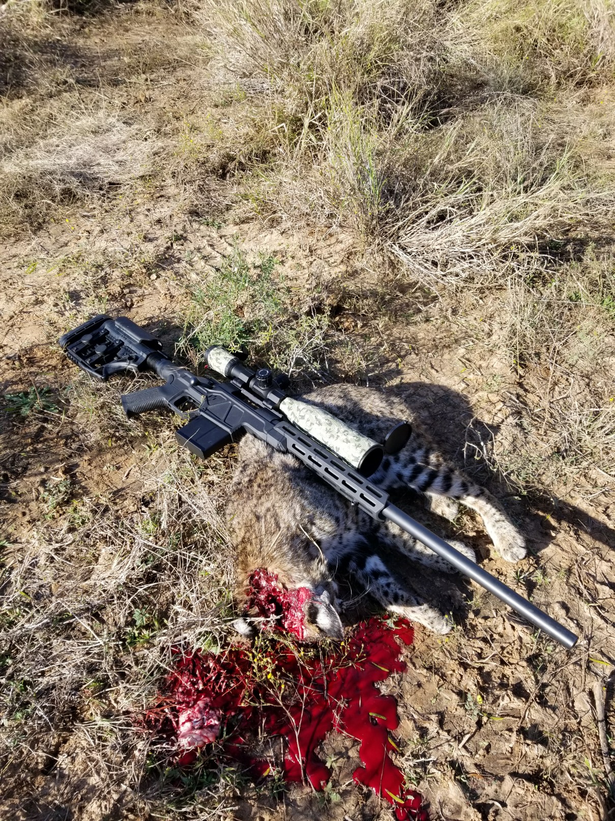

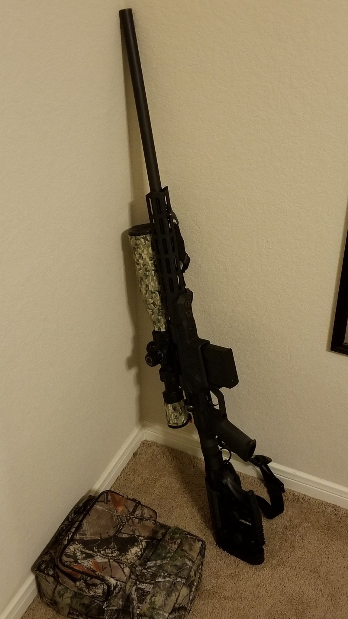

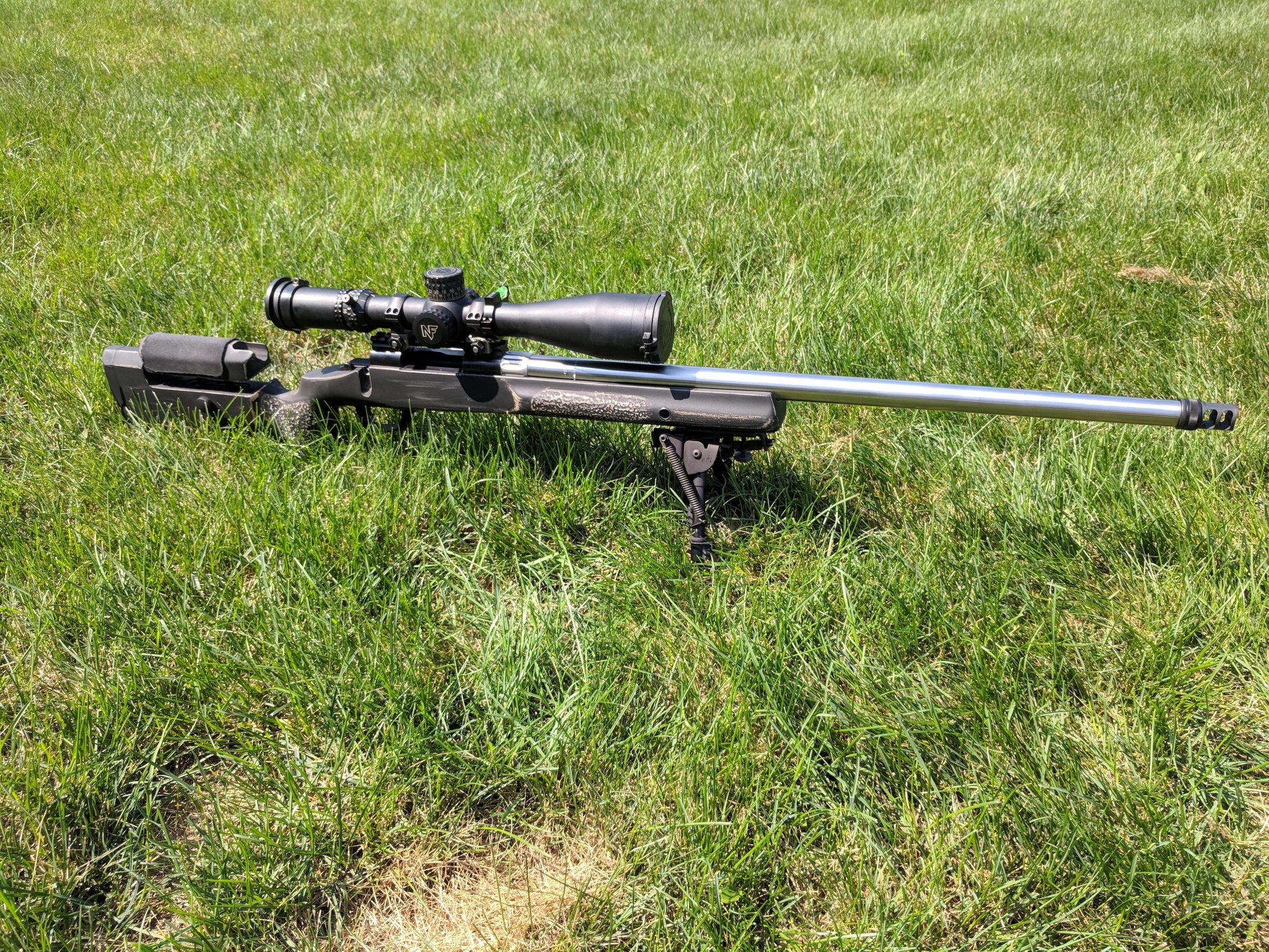

    Hello all,
    So being a Howa owner, it's always nice to see what modifications or changes others do to theirs. Plus, the howa 1500 action is a great shooting platform and typically very very accurate. I noticed there is no such thread and decided i should start one seeing as how Bergara, Tikka, RPR, etc all have one. I'll start off with mine.
    In the pics, she is sporting a weaver tactical 3-15x50. I have now mounted a Bushnell lrhs 4.5-18x44 and will get pics up with it when I get a chance.
    Back in the day before the switch to scout we did have a good thread listing all the options, accessories, parts, and smiths for Howas as they weren't as popular back then. I think VJJpunisher had one of my personal favorite builds, especially with the iron sights.
    Hopefully i will have an addition to add to this soon.

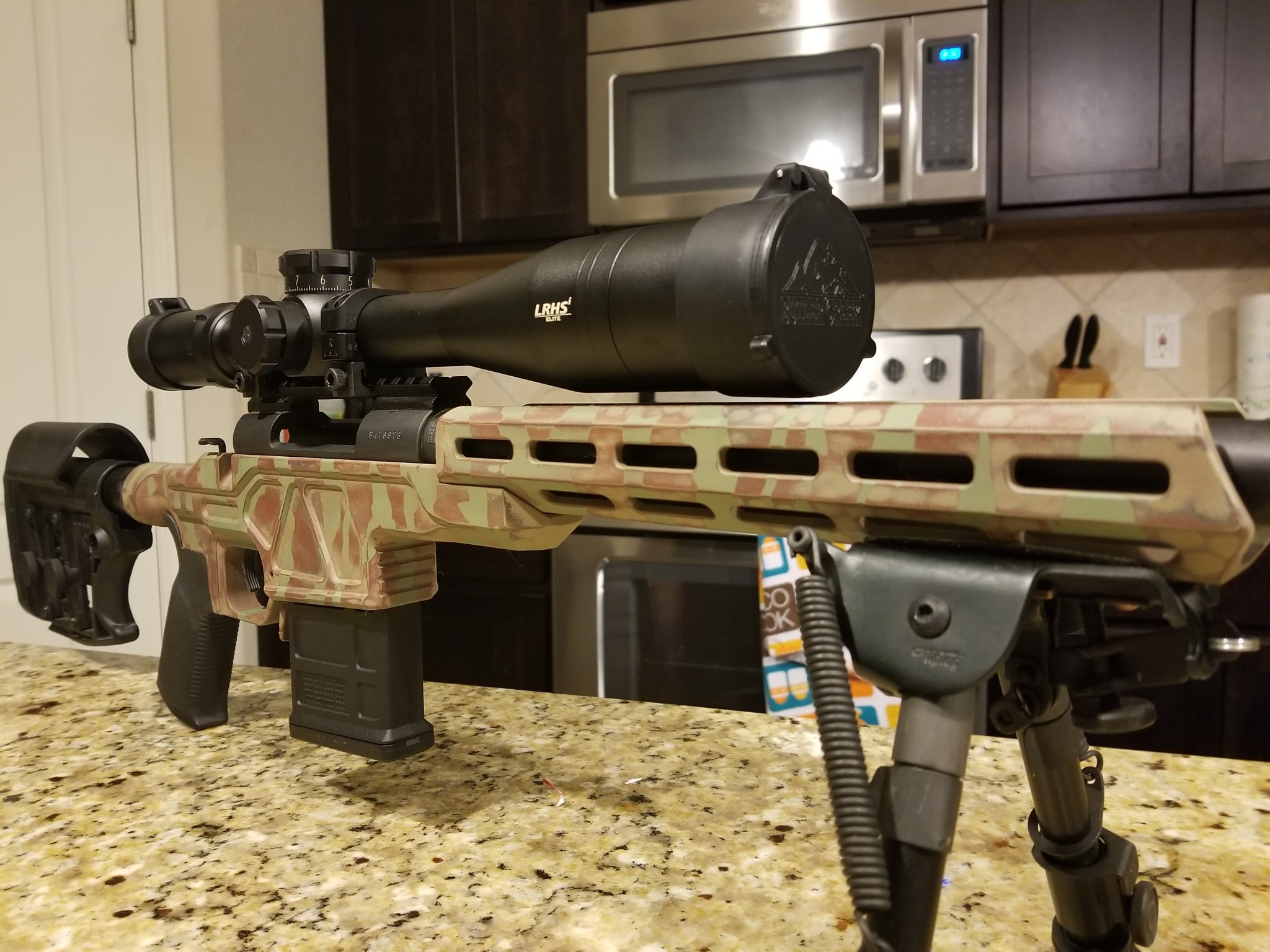

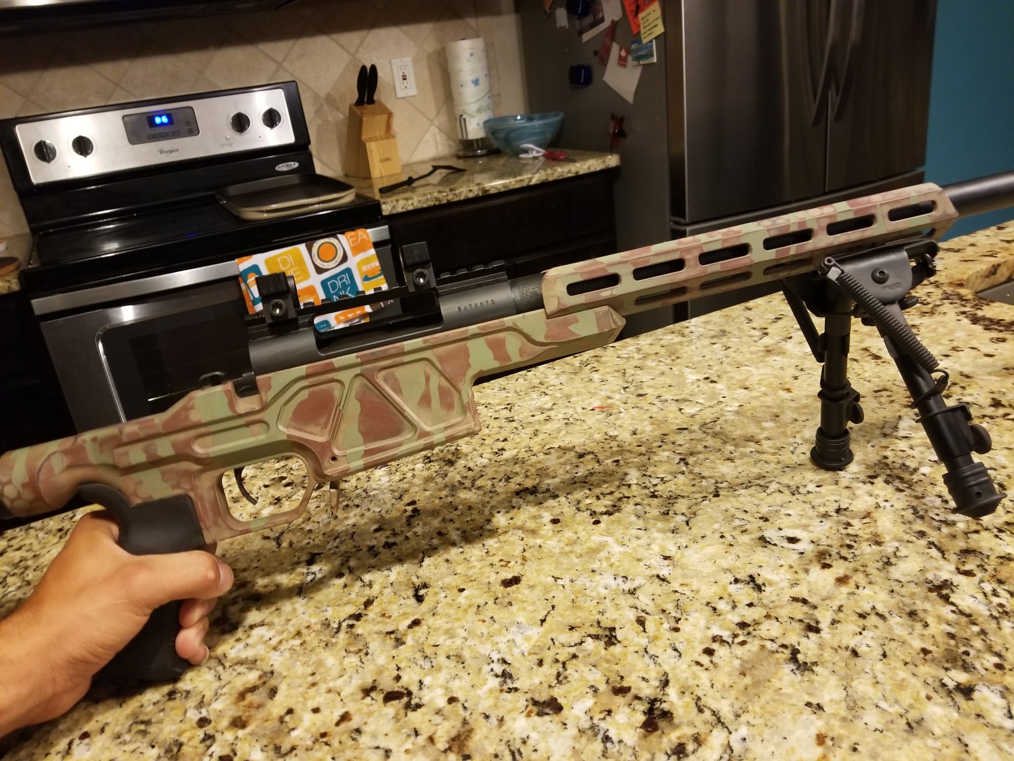

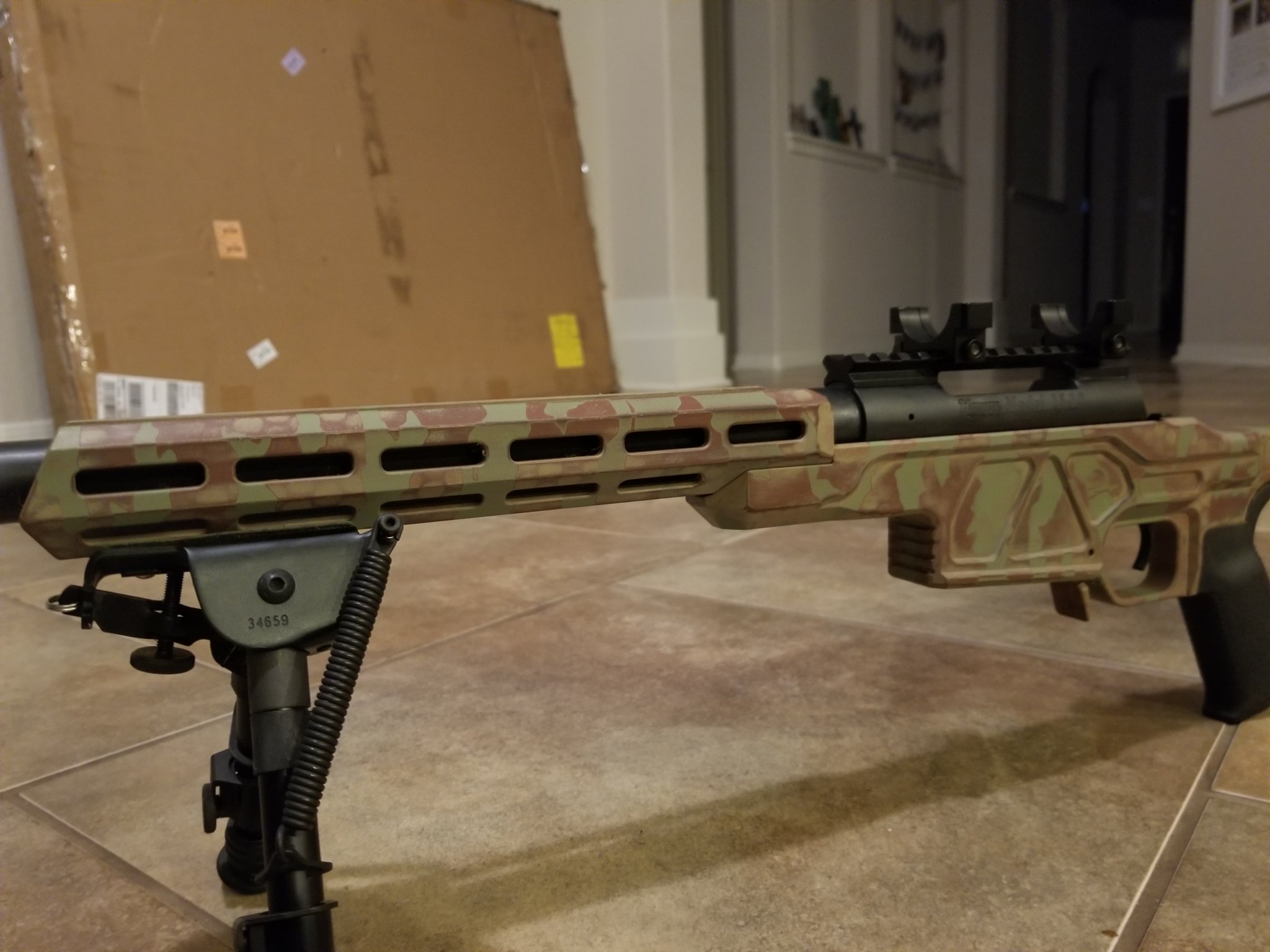

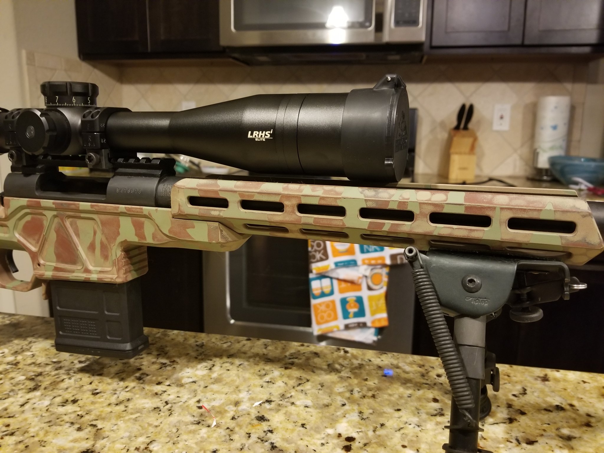

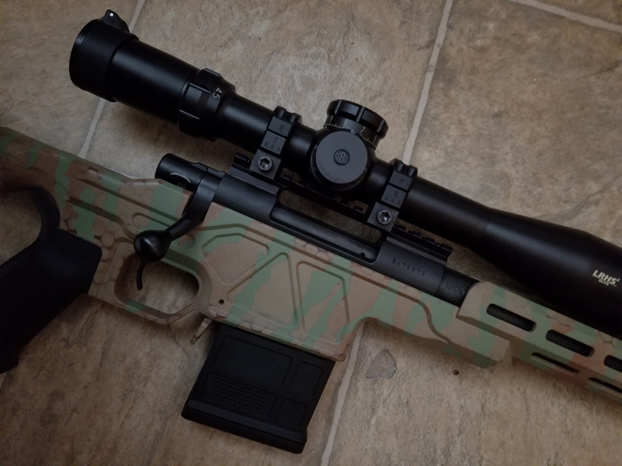

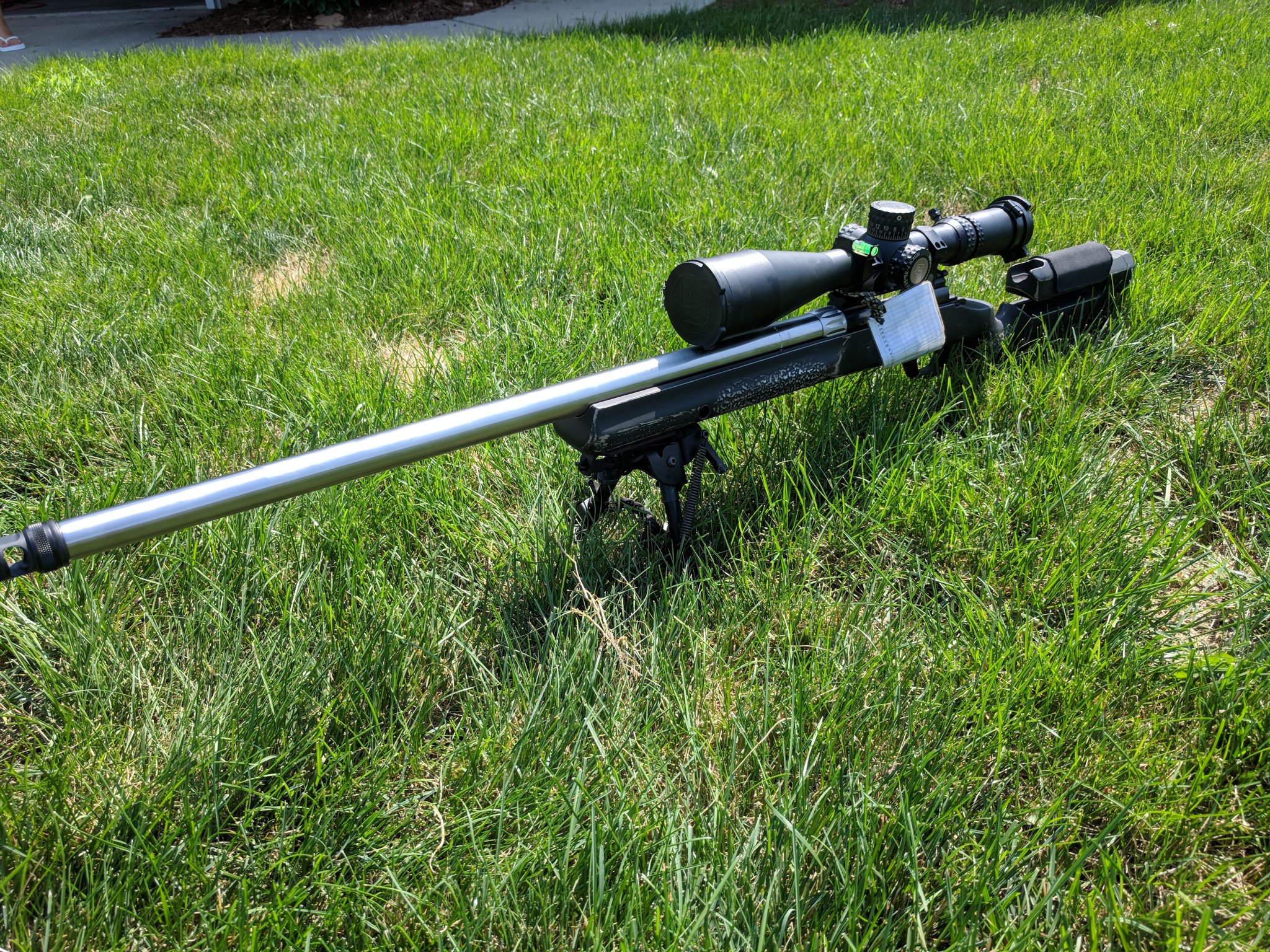

    How she sits now.

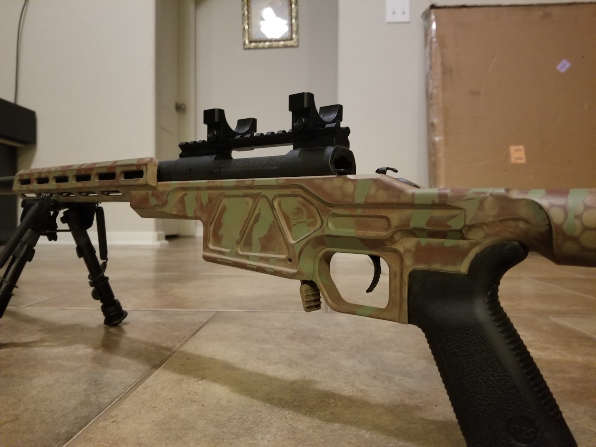

    Nightforce 20 moa base
    Ken Farrell low rings (really like how low these rings get, scope is practically sitting on the rail)
    Bushnell elite LRHSi 4.5-18x44

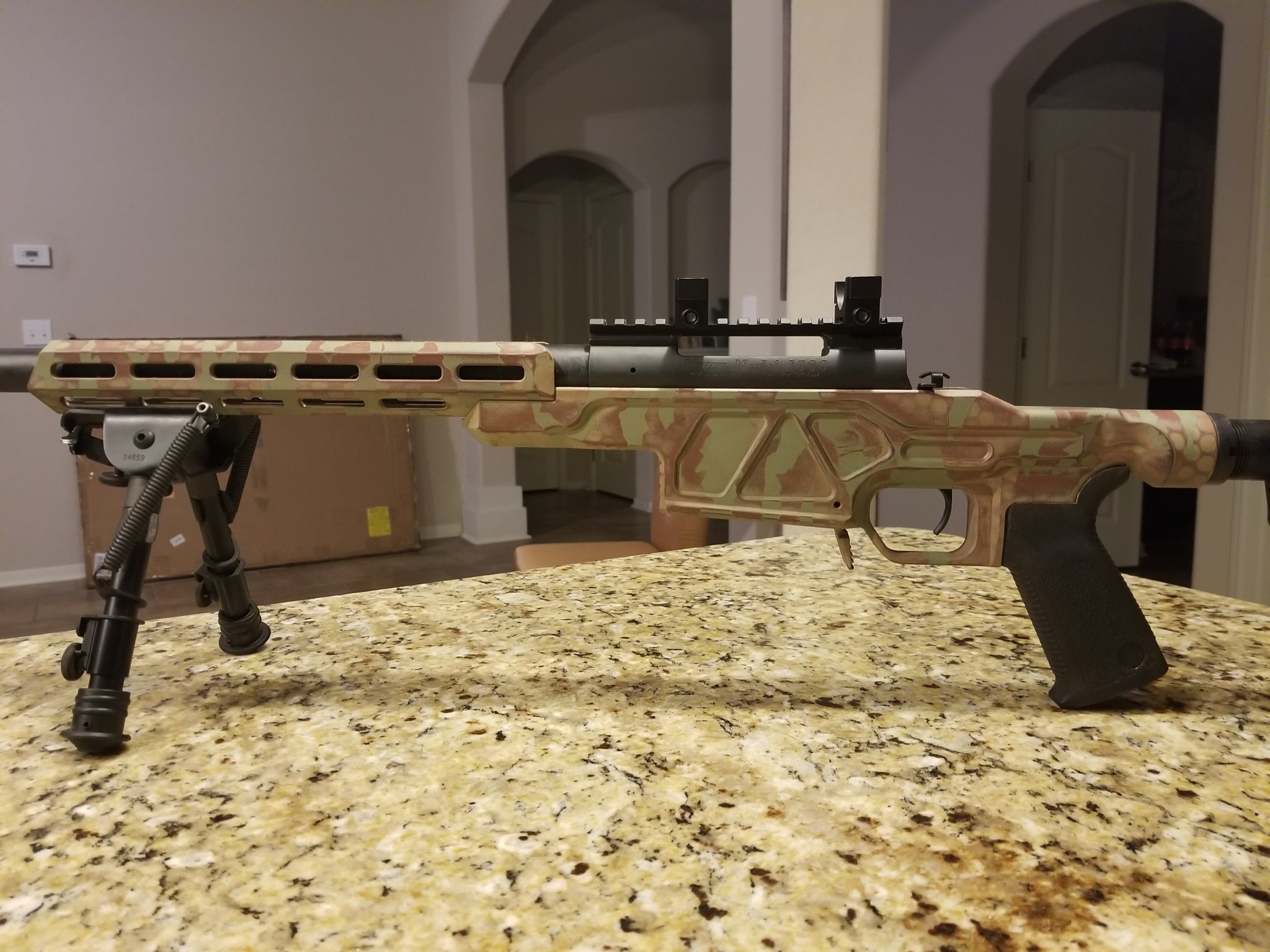

    Custom krylon paint job (definitely did not come out the way I anticipated, will remove paint job soon and repaint differently)
    Has anyone had experience with the Howa HS-Precision rifle?
    I just tried removing the paint off mine, but I realized the worn look gave it some character so I didn't remove it all. I'll keep it a while like this and later on do a different paint job. The next paint job will be full rifle. That includes chassis, BA, and buttstock. Below are pics of how I left it now.

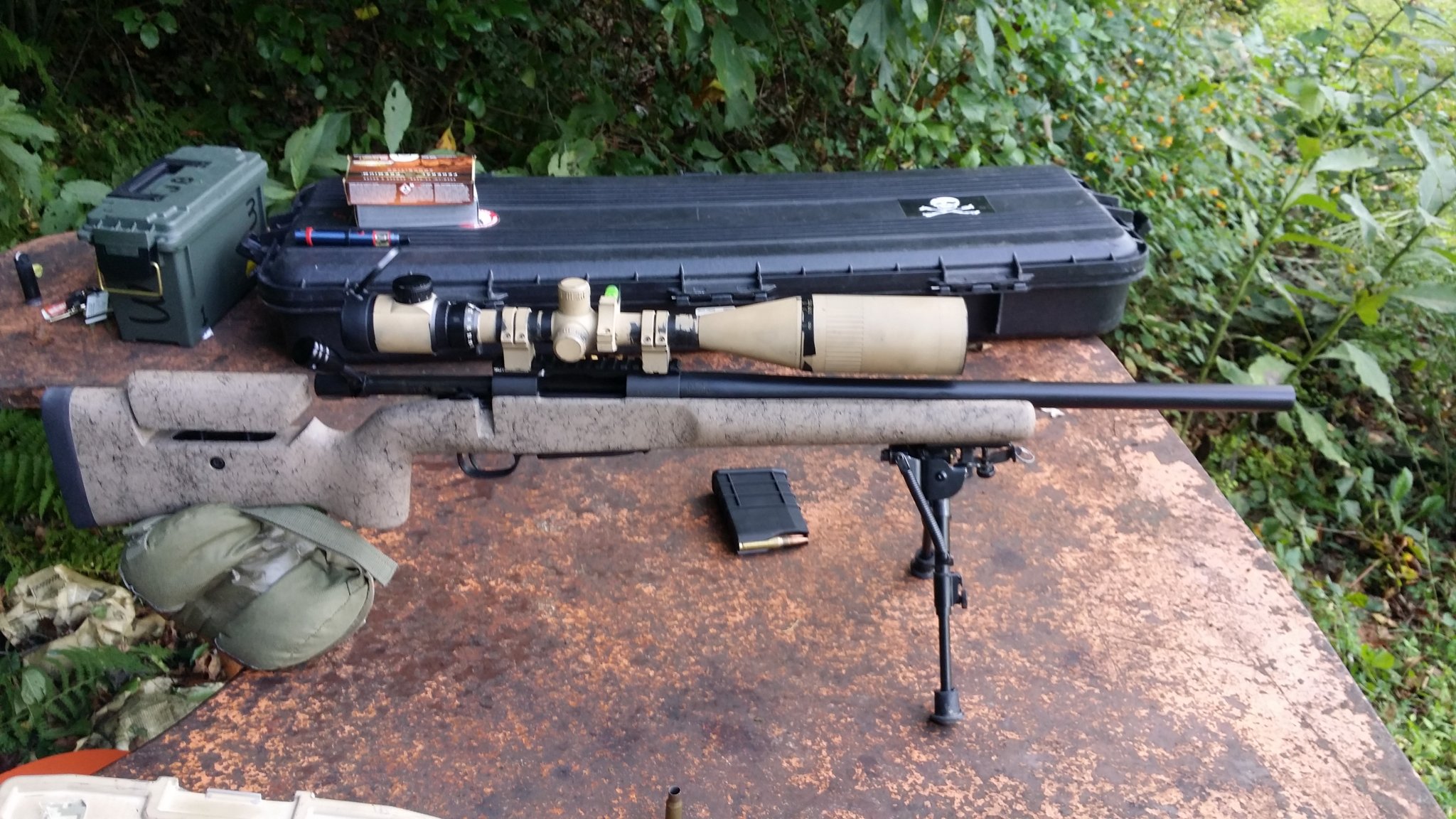

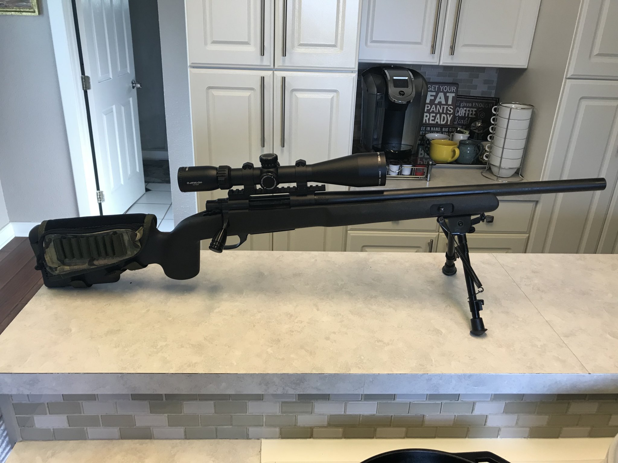

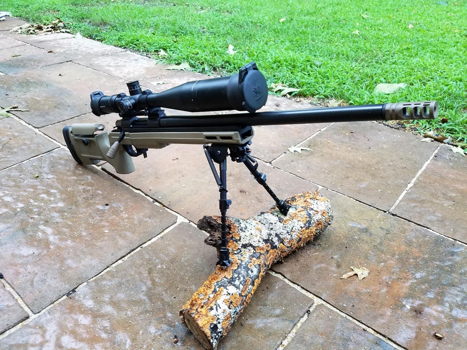

    Here is mine so far....
    Howa 6.5 Creedmoor, 24" threaded barreled action from Brownells sale
    KRG Bravo Chassis with Butt Hook cover & extended magazine release
    Burris 25 MOA Rail
    Burris 34mm Signature Tactical Rings
    Burris XTR-II 5-25x50 scope in FDE
    Here is the first 100 yard group after doing the recommended 20 shot break-in process...
    Still to come - Bipod, SilencerCo ASR Muzzle Brake, Bolt Handle.

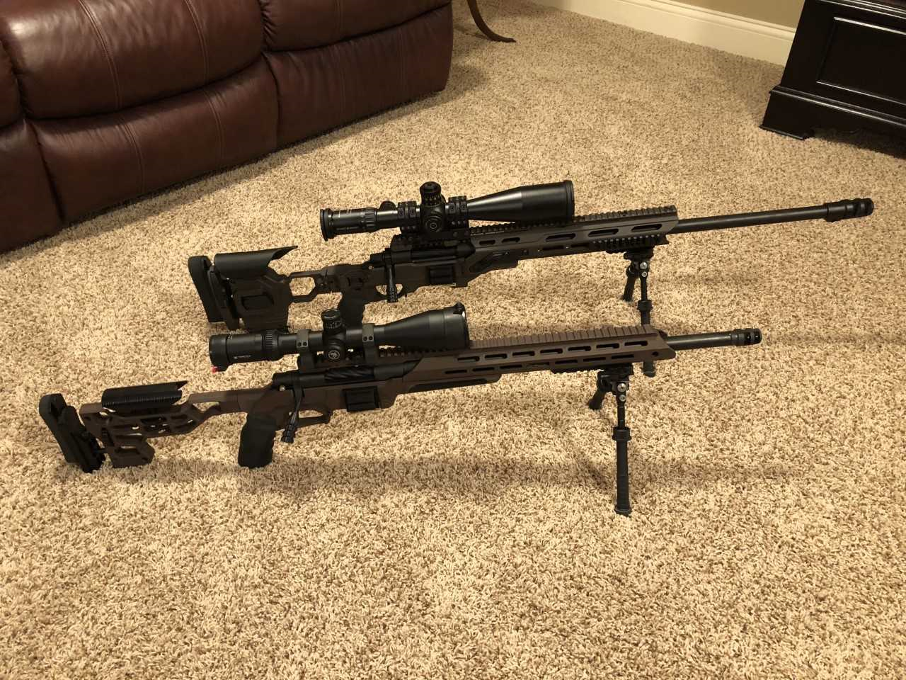

    Howa 1500
    Criterion Barrel 6.5CM 1:8T 26"
    ThunderBeast CB Brake (for Ultra 9 can)
    Bighorn Barrel nut system,
    Manners T4A Stock,
    Timney Trigger (forget which model),
    DBM from Manners,
    NightForce ATACR 7-35x plus NF Rings
    EGW 20MOA Rail
    Action is 3 years old and just rebarreled this season with new prefit from Criterion. Great system! The load below is a factory ammo clone that I use for practice. Holds .5moa or just under nearly every outing. The 10 shot group CB and second shot are know to be at 1 and 10 consistently with this load.
    Bottom picture Berger VLD hunts shoot about .1-.2 better than the ELD 140s shown.
    Picture above: 3 shot zero test Berger VLD Hunt and on right is 3shot 140ELDM. Berger's are used for matches and they hold .3-.4 over 5 shots and sub .5-.6 for 10shots.

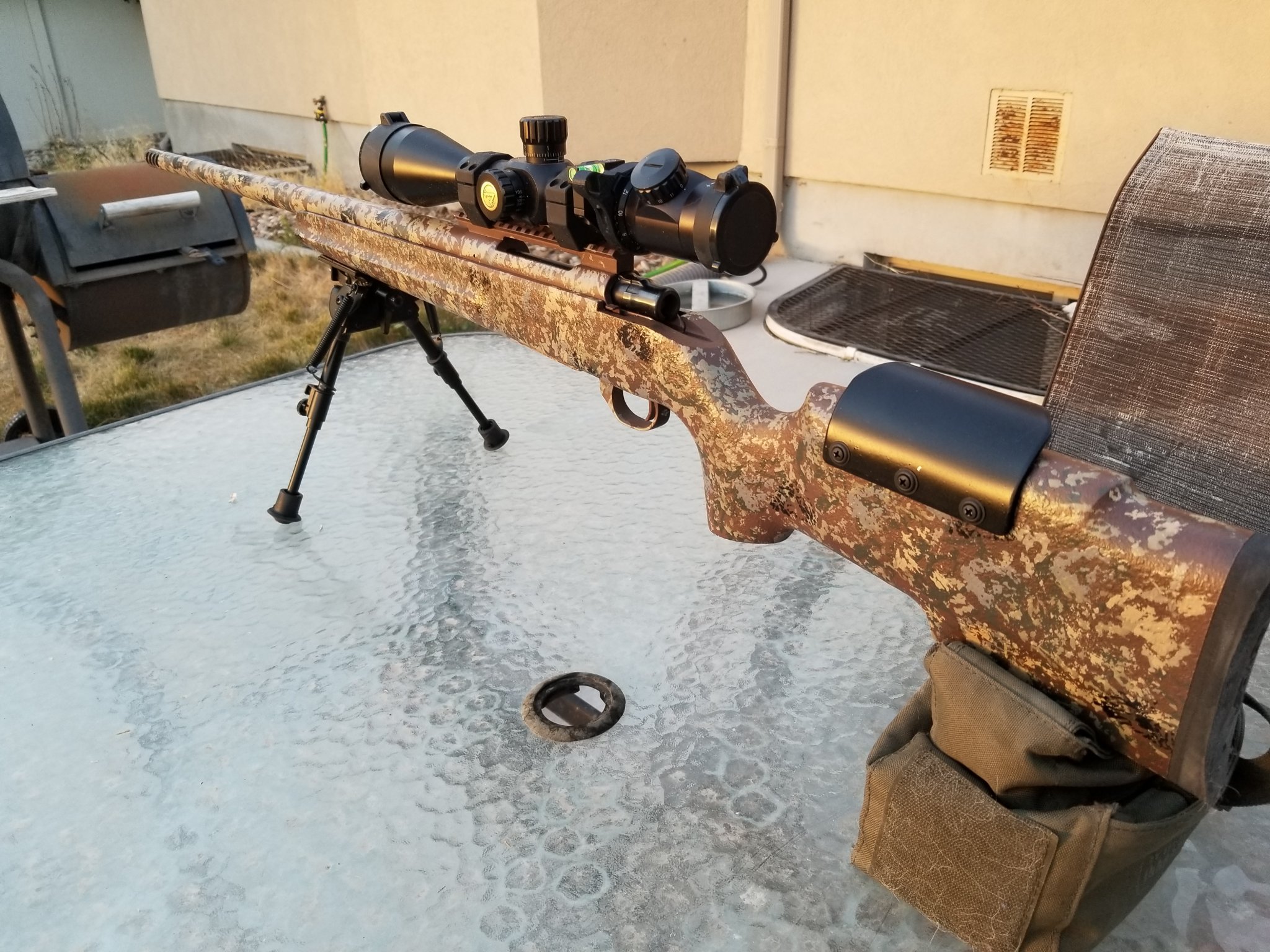

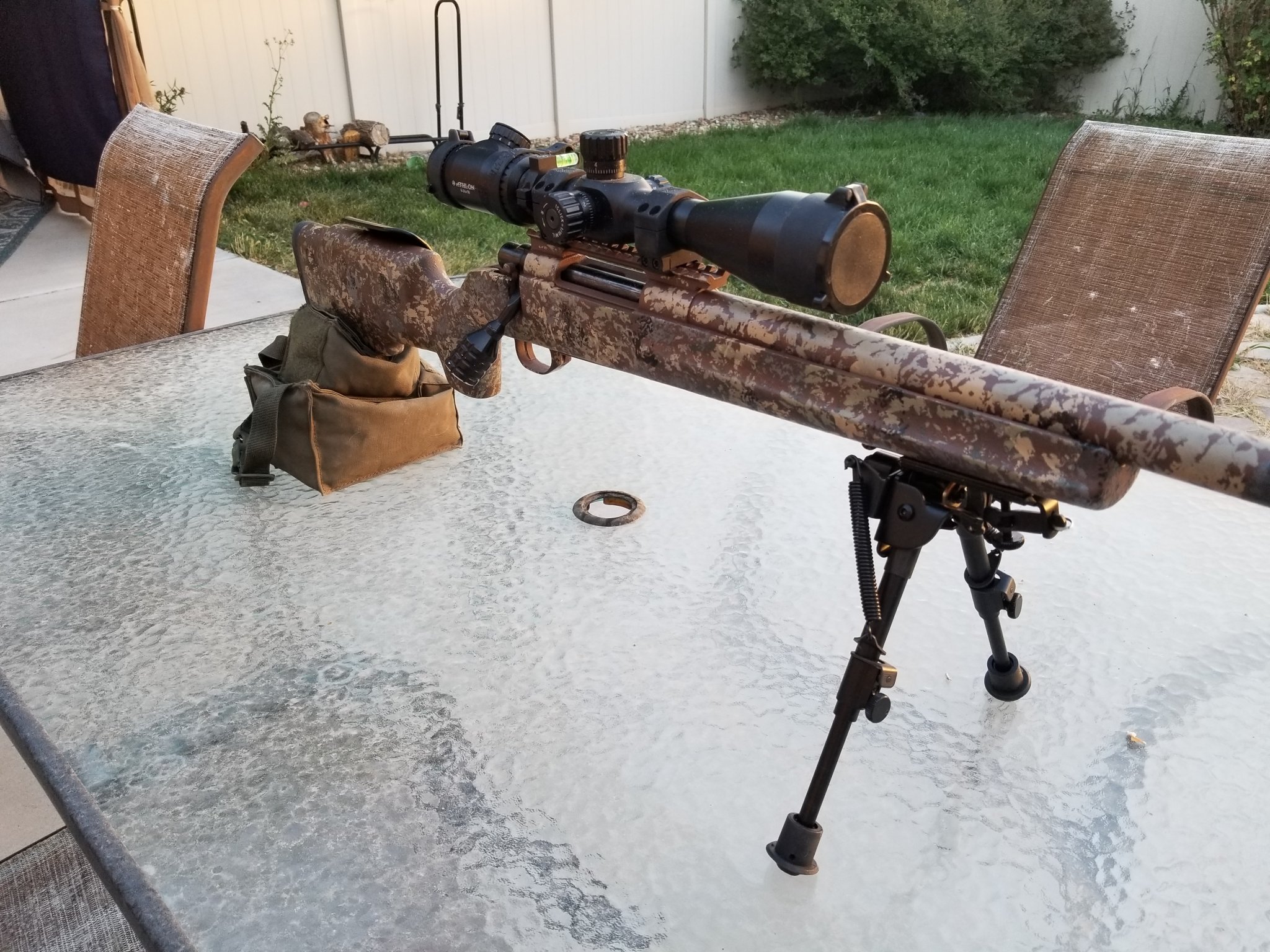

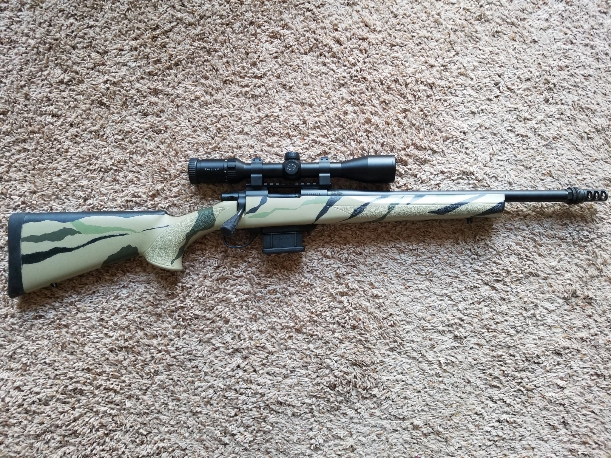

    Here are some pics of my updated rifle. I think I'll start removing it's current paint job now tho...View attachment 6939143View attachment 6939144View attachment 6939145View attachment 6939146
    I wanted to as you two before but forgot. Can you remove the sling swivel from the handguard. I would most likely use an Atlas so that looks in the way of a rail section.
    I wish I had a definite answer but truly, I don't know. Looking at it now, it seems as if it is removable but your best bet would be to contact Matt @ LSI. He works for legacy sports which is the importer of Howa!
    yes, the sling stud is removable, its simply threaded into the handguard.
    Its the pro varmint. The cheek piece is just a piece of aluminum that I bent to fit. I'm getting ready to do some load development and I'll post some pics

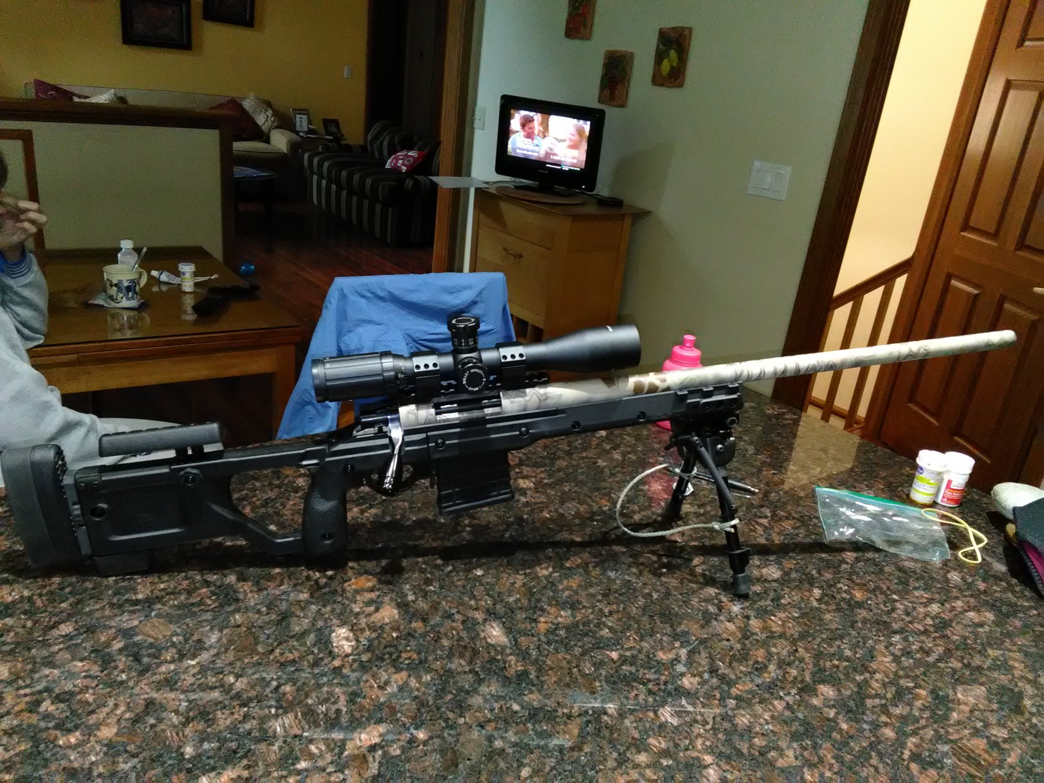

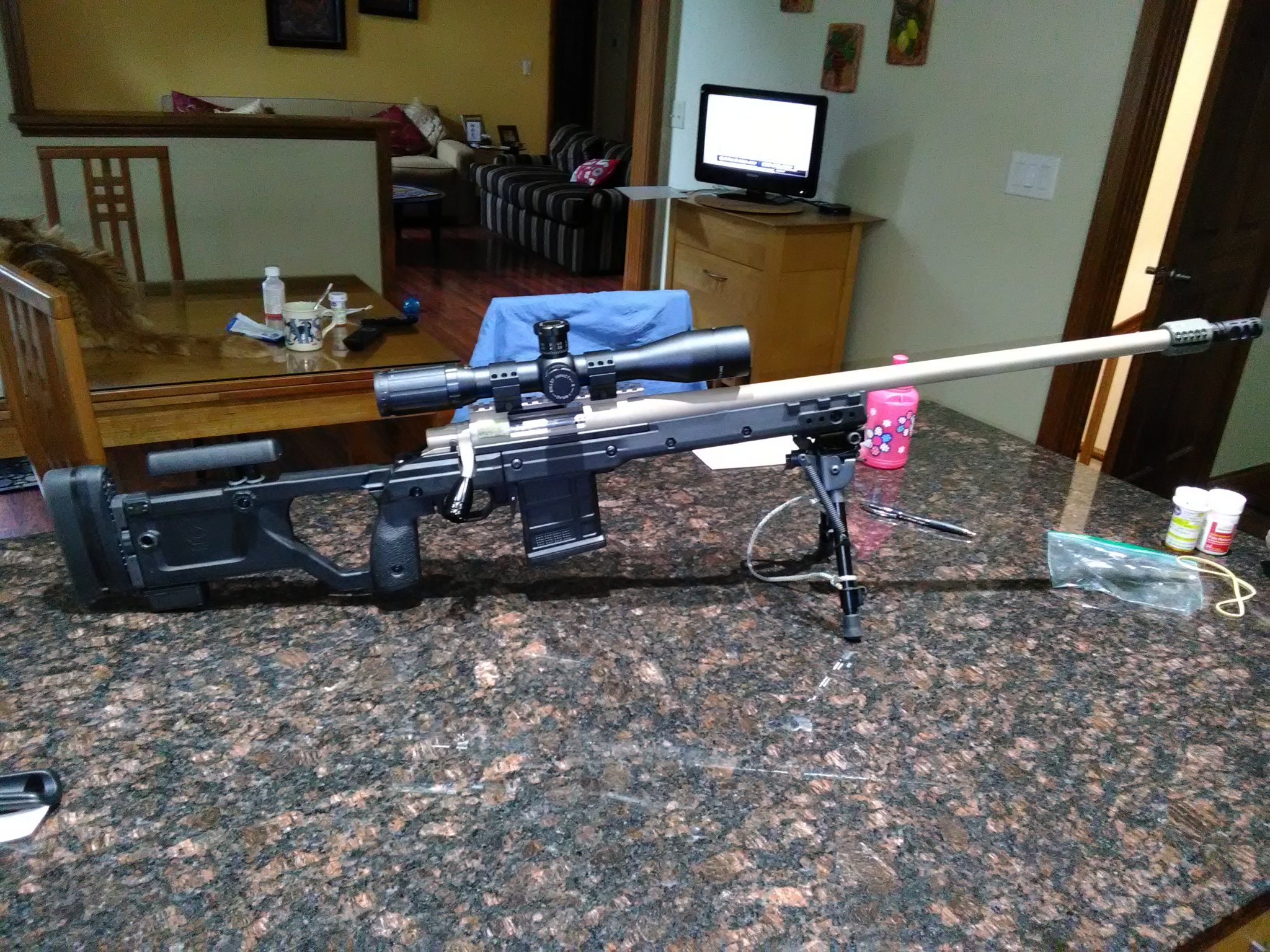

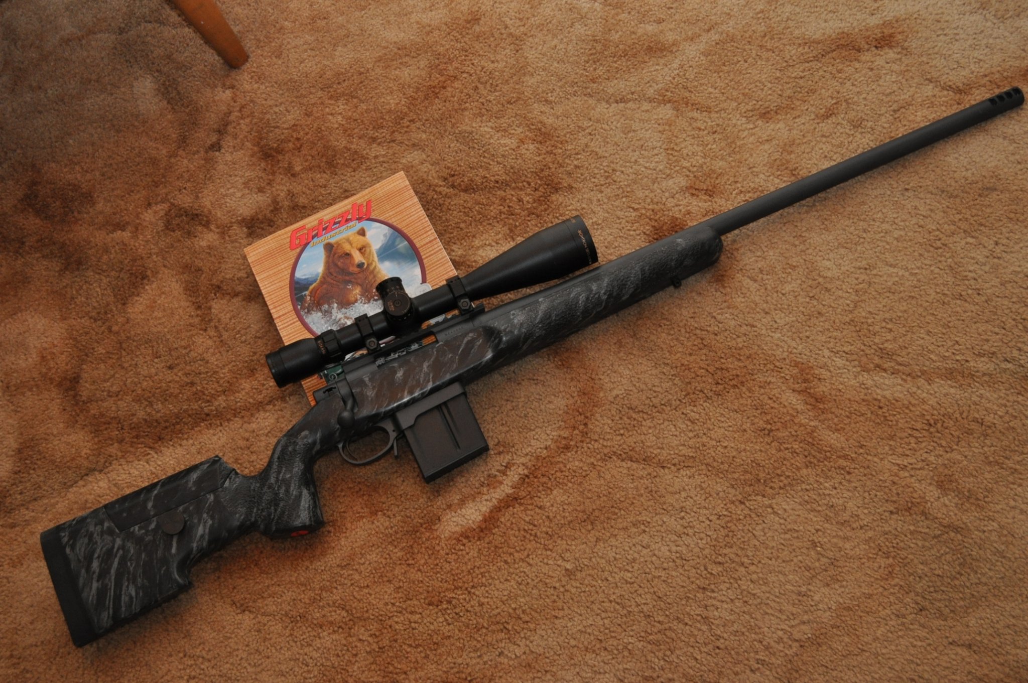

    New here, been lurking for a while and I've learned much watching Lowlight's videos.
    I got a Howa 308 Heavy Barrel action from Brownells. Had it threaded.
    Here is how she sits. Burris base is on backorder ATM. I have yet to put the muzzle device on.
    I bought a blem from KRG this past weekend, Bravo rear and X-Ray front.
    Action is very smooth and I can't wait to shoot her.
    ETA: What's the best way to adjust the 2 stage trigger? It's got a pretty heavy trigger
    Good to see you over here.
    Howa 1500 Trigger Adjustment
    Have a good weekend,
    Bob S.

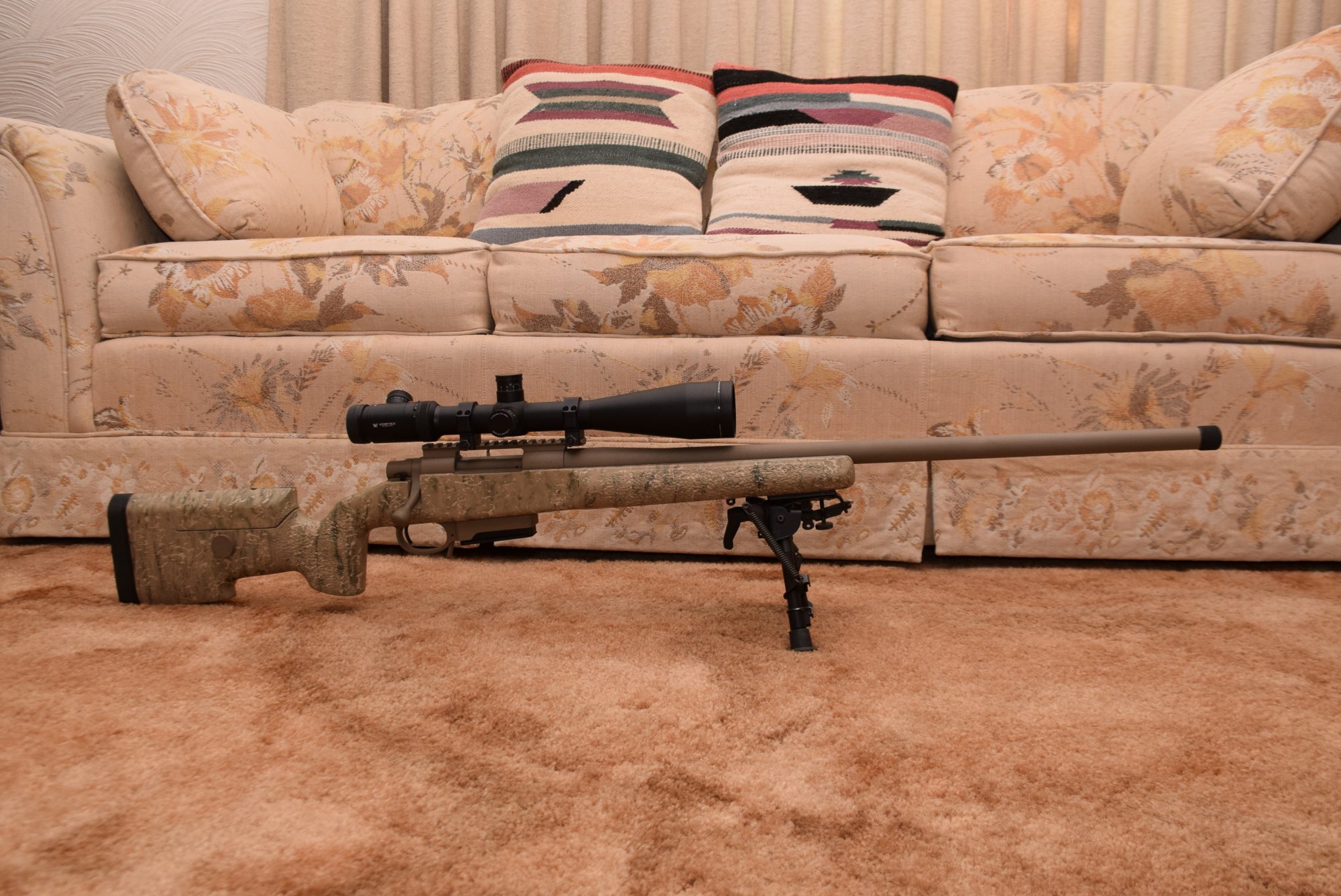

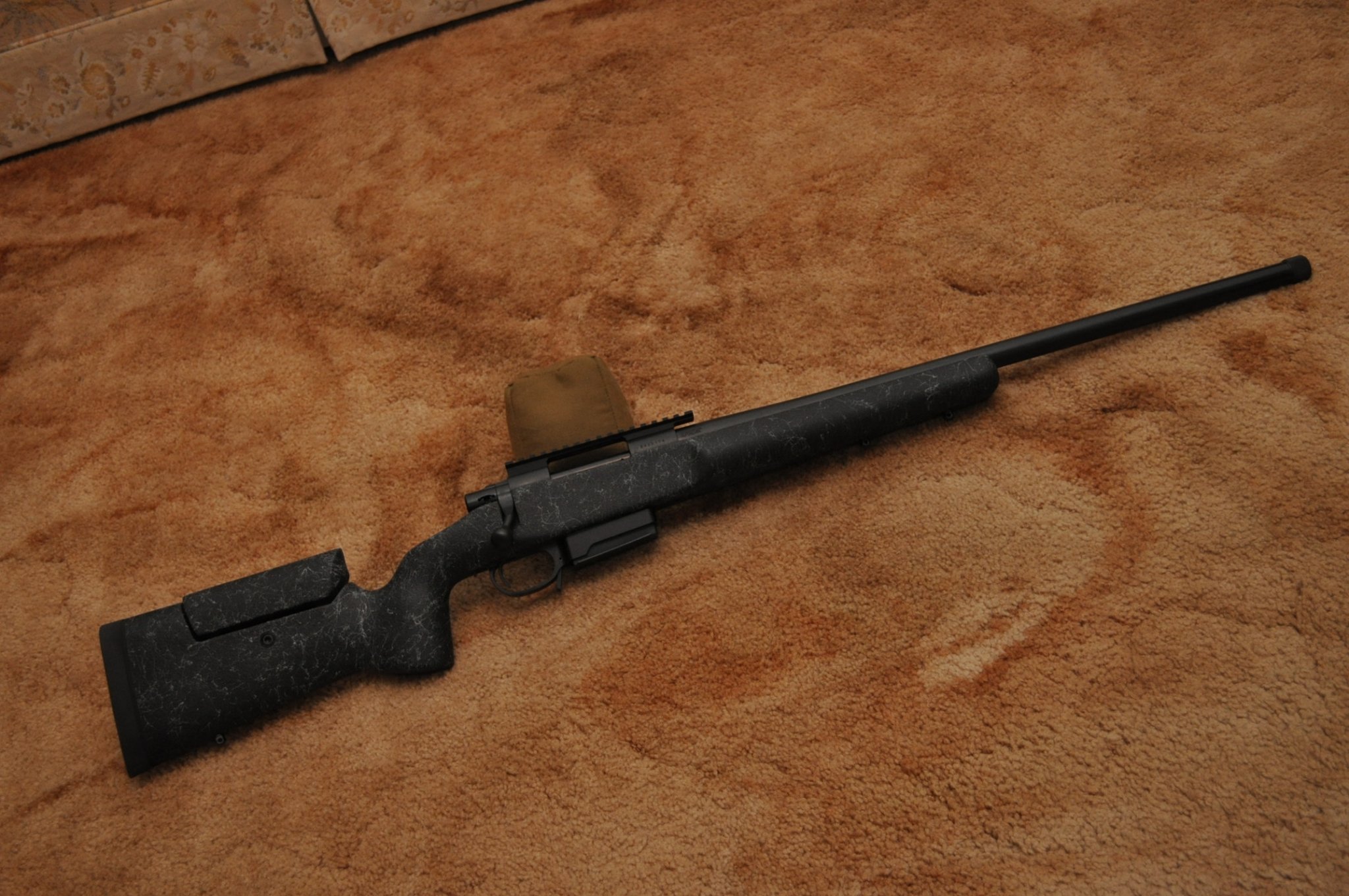

    Howa 1500 SA in a McMillan A5, 26" Krieger 1-8tw bbl in 6XC. PTG Stealth DBM, EGW 20 MOA rail, TPS TSR low rings, Vortex Viper 6-24x50 PST. CeraKoted FDE.

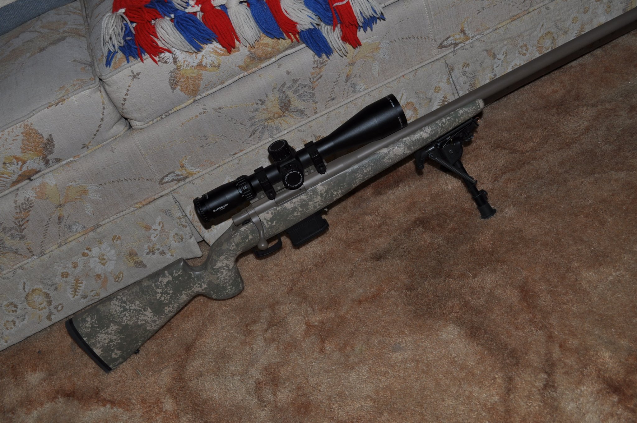

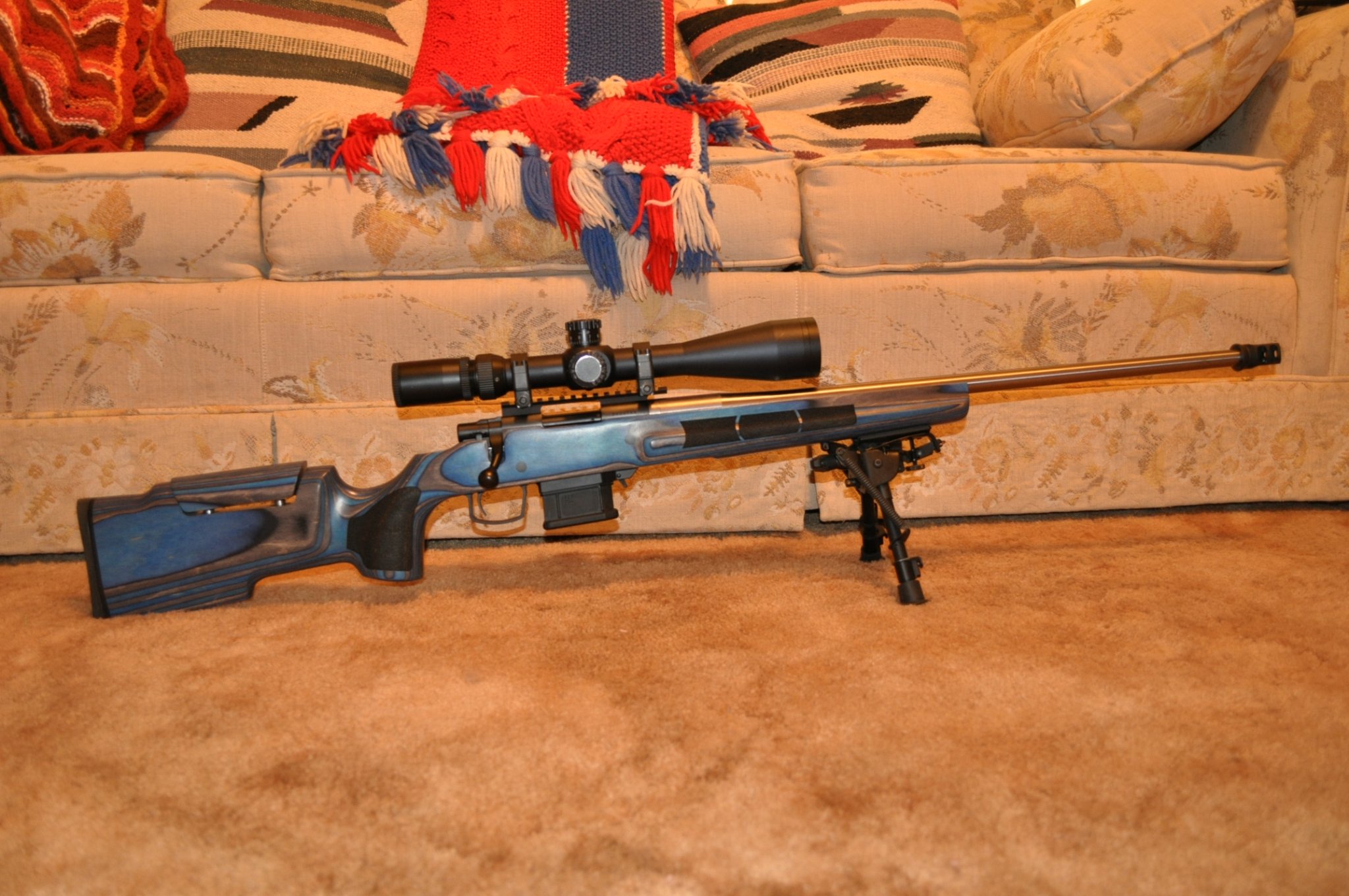

    Kind of a test piece - Howa 1500SA, trued receiver face & lug seats, chambered & fitted a 26" Bartlein 1-8.5 in 260 Improved 30*, Harrels brake. McMillan A5, 70% blk/30% med grey marble, PTG Stealth DBM, EGW 20 MOA rail, Sightron SIII 6-24x50 Mil Hash. 5-shot group with S123MK at 100yds. Liked this rifle a bit more than a similar one built on a M700 SA, but a friend of a friend came along, looking for something just like it, so.... IIRC, I used sniper grey CK on it.

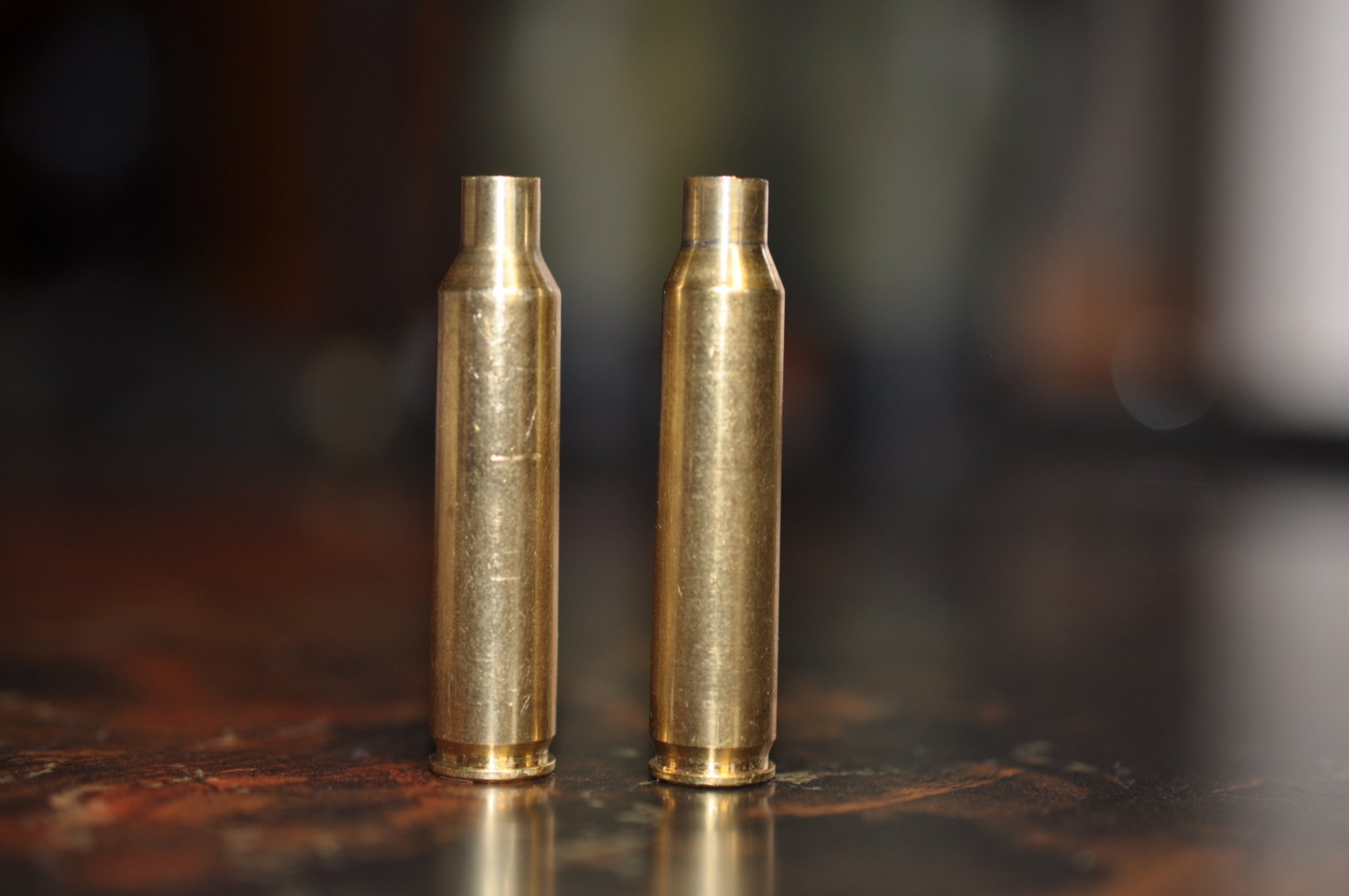

    Very cool. Any reason for going 20 tac over 20 practical? Not super familiar with either. How do they compare to 204 ruger?
    Mainly wanted the 30* shoulder of the Tactical - 20 Practical is easier to form (just neck 223 down to 20). The Practical probably has just a tad more case capacity, since the Tactical pushes the shoulder back a few thou in order to get the longer neck. Would be surprised if the 204 Ruger will produce much more velocity than the Tactical, but will have to see how this one does. I've built a couple of 204s for customers in the past, but never got any trigger time with either of them in for myself.
    I'd originally planned to build myself another 20 VarTarg, as I had built a nice one several years ago for myself, but wound up selling it to a guy who was getting ready to go on a guided prairie dog shoot up in the Dakotas. There just aren't enough dog towns left out here to make it worth having a good PD rifle - this one will get used with the Berger 55s on coyotes. Besides, R-P 221 Fireball brass was crap the last time I bought any for the VarTarg, and using Lapua would mean I'd have to neck turn...so the 20 Tactical got built instead.

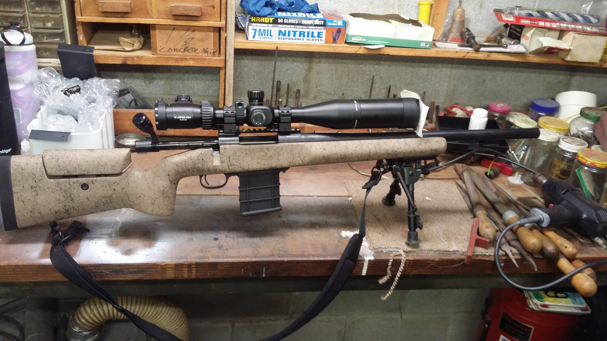

    Truly, it's nothing special... factory (heavy/#6) barreled action (from Brownell's) with the barrel cut to 16.25" and threaded 5/8-24 for a SiCo ASR brake/mount. The rail is from Warne, and is 0 MOA inclination. I've tweaked the factory trigger via the spring cutting method and it's a VERY nice two stage with a break right at 1.25 pounds. IMO, unless you just can't live with a two-stage trigger and/or a plastic trigger shoe, there's no reason to buy an aftermarket trigger for these rifles.
    Anyhow, the stock is a factory Howa piece that came with a .223-chambered Howa mini action that I bought at Cabela's a couple years back, and I just did a backyard special of a Krylon job on it. The scope is a little Zeiss Conquest 3-9 that I had sitting around, and the rings are (horror of horrors) vertically split low Warnes. Bottom "metal" and magazine are completely factory, and the bolt handle job was done by a local 'smith (Penty Wheeler of Penty's Gun Clinic in Royse City, TX).
    The whole thing weighs a touch over 7 pounds as it sits with no ammo in it, and as basic as it is, it might be my favorite gun to shoot right now. At this point, using Tula steel case hollow points, it averages around 1.5 MOA with a best group right at 1 MOA. I just finished putting together some hand loads for it, using Win brass and .311 caliber 150gr Sierra soft points. We'll have to see how she shoots with somewhat decent ammo.

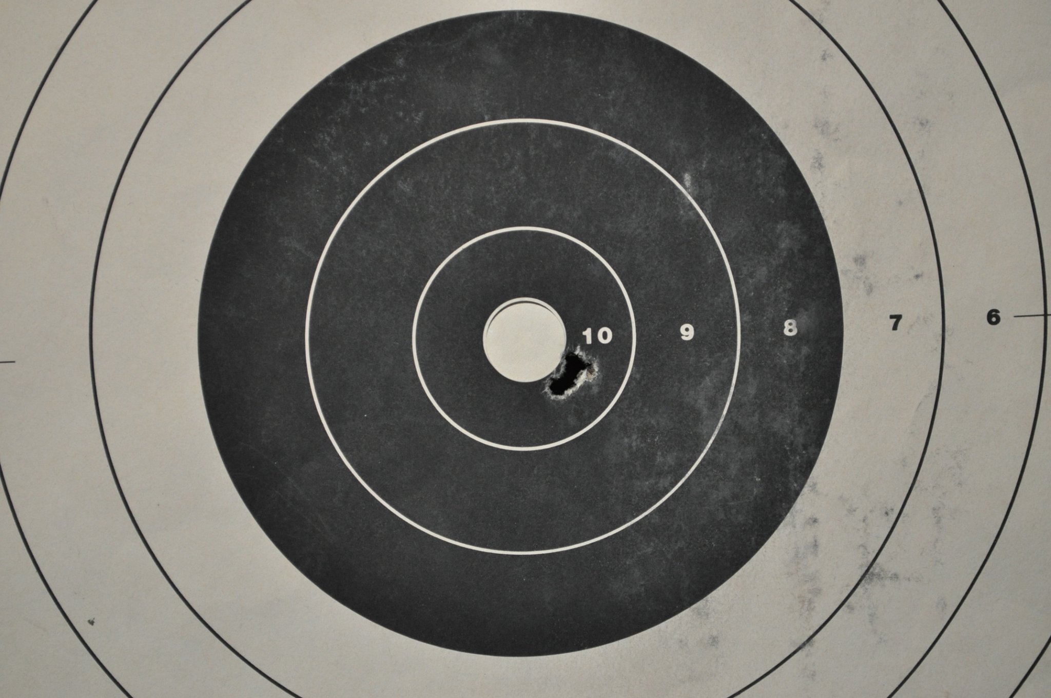

    Ten rounds from my 308, which has 4310 rounds down the bore. This group measured approximately .75" (.72 MOA, .27 mils) CTC. The shot on the upper left is the clean cold bore shot and is included in the group measurement. No mulligans.
    The target is a .1 mil grid that I made on Excel

    I've gotten similar accuracy on mine but with 5 shot groups not ten. This was factory ammo tho, not even handloads!!!
